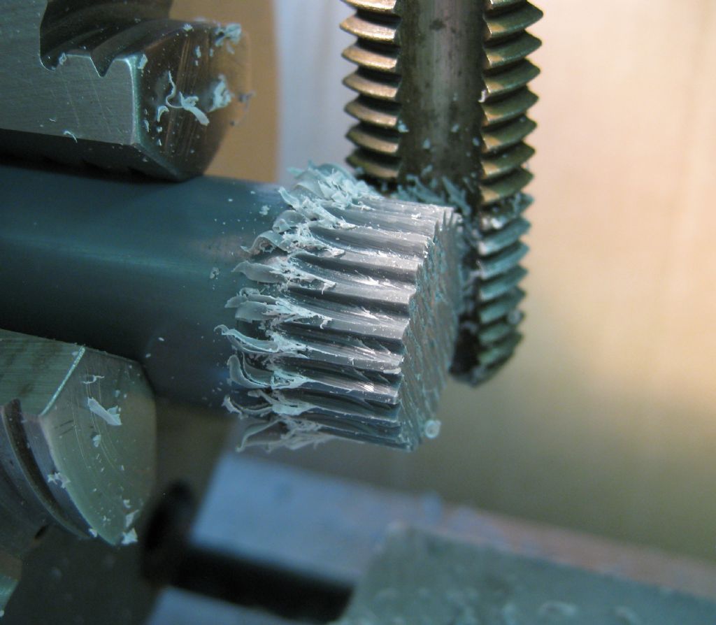

Well, I got the table done, the software ready to test, the electronics all hashed together and dumped in a plastic tray, so off to the workshop..
Mounted the rotary table on the angle plate, and that on the EMCO FP2 mill table, with a piece of 20mm diameter PVC in the centered chuck. As mentioned previously, I have no need for gear cutting with what I hobby about, so this is all a bit of mind-messing. So, to test I need a hob and the closet I have is a Big British Tap - a 3/4 Whitworth tap. This has 10 TPI, so 2.54mm pitch. That puts near enough 24 teeth ( on the pitch circle) around the 20mm plastic rod. And so off we go...
A VERY Blunt TAP - did not cut so much as bludgeon the material out the way...
The 'cleaned' up 'gear'
valleys are very rough - As I said , the 'hob' is terrible..

So the software seems to work well but some more work is needed on the stepper side - The stepper torque is, as expected, a little on the low side for the smaller diameter gears, with hob speeds greater than 250RPM. At 300 RPM the stepper stalls, albeit at 30VDC supply voltage - I need to push the supply up to 50V, or maybe even 70volts and hope that helps. The NEMA23 stepper is a little small..
The software will now be cleaned up, and some diagnostic modes added, and then it is ready for the chaps working on this project with me..
Those of you who did not fall asleep while watching may have noticed that I have no angular shift between hob and blank, ie, the rotary table is not tilted to the helix angle of the hob - Was to much effort for just a trial run!
