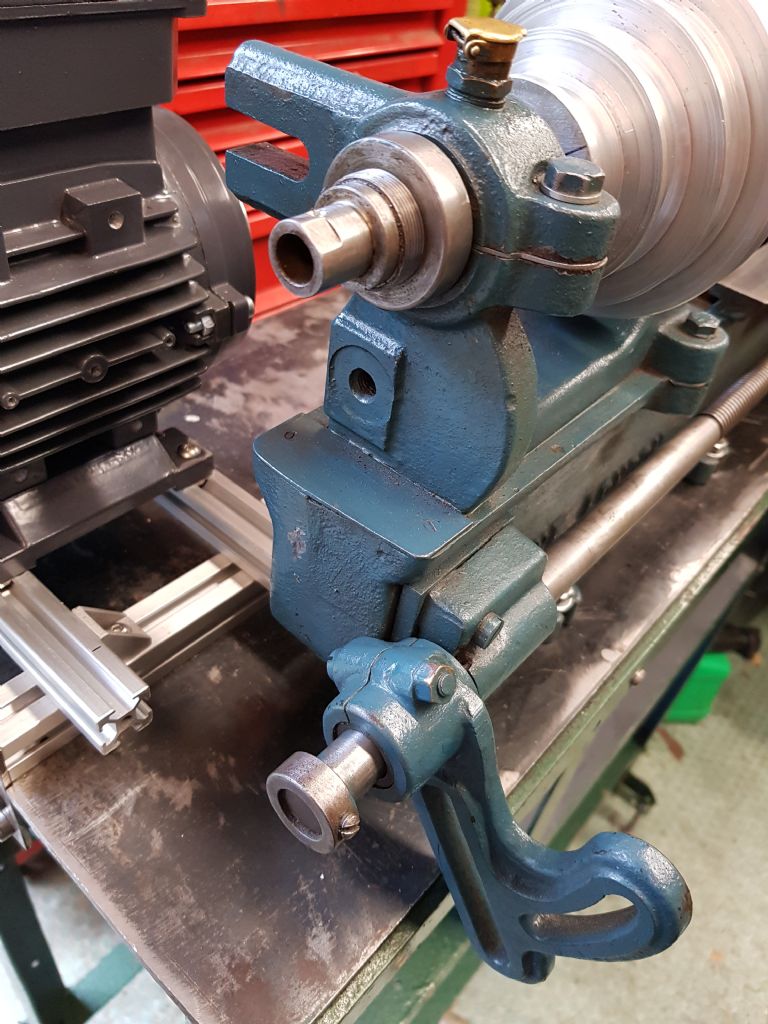

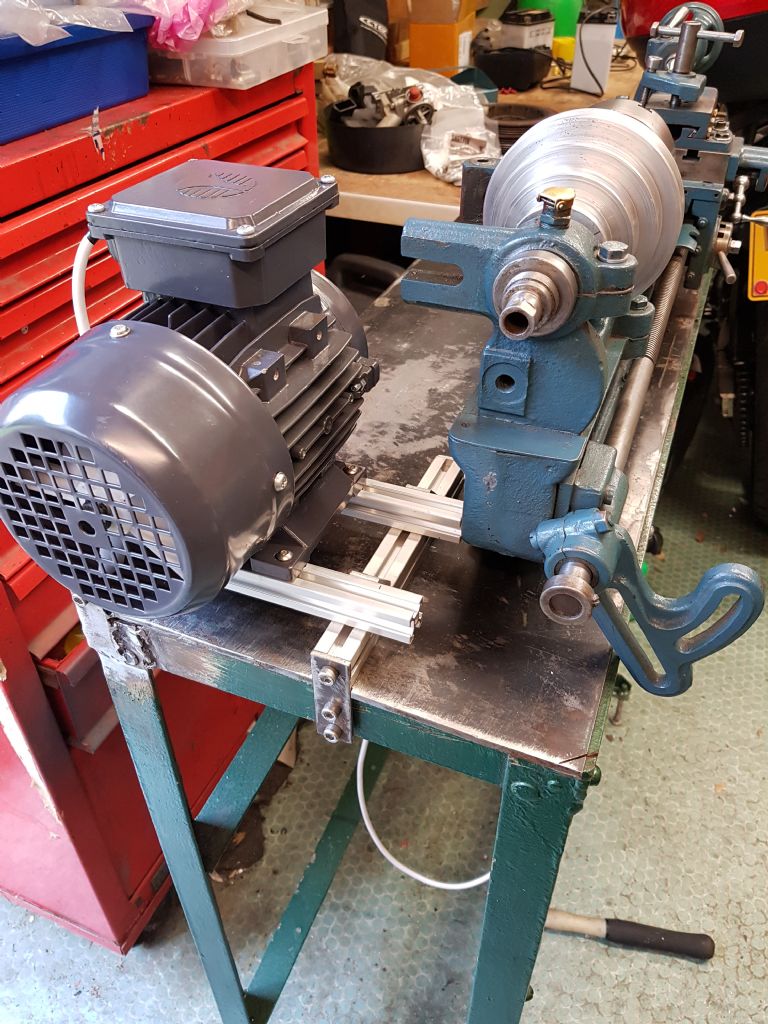

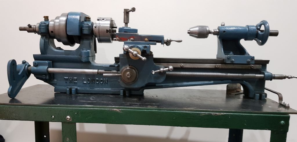

just got my 1st lathe, its badged "london". needs a bit of work but nearly done now. will be running with a vfd
only problem i will have is that it the change gears are missing so no power feed. need to find some that are compatible

Hello Rich,
Without checking, I feel pretty sure Myford 20 DP change wheels will be compatible, Grayson lathes were copied from Myford.
You might find the bore sizes to be different but that can be addressed by either sleeving or boring as necessary and then restoring the keyway [0.125 inches wide]

some here of the work in progress

im not sure exactly what bits im missing to drive the leadscrew from the spindle. you can see what ive got from the pics

Since you seem to have no Change wheels, you could use 20DP gears from a Myford 7 Series (These use keyways, the earlier ML Series used pins - AVOID), or spares from the current oriental machines, although they will be metric (Module) gears, and will certainly need sleeving / boring to suit. Keyways will be either 3mm or 4mm.
If you choose that route, among the UK suppliers would be Warco, Axminster, Chester or ArcEuroTrade. Look at their websites. If you tell them what you are doing, some may be more helpful than others
You have the banjo, but will need to make up Studs to carry the gears on it. It would be useful if you could make up a tumbler reverse, whilst you are about it.
There will be a LOT of satisfaction, once you have it up and running.
