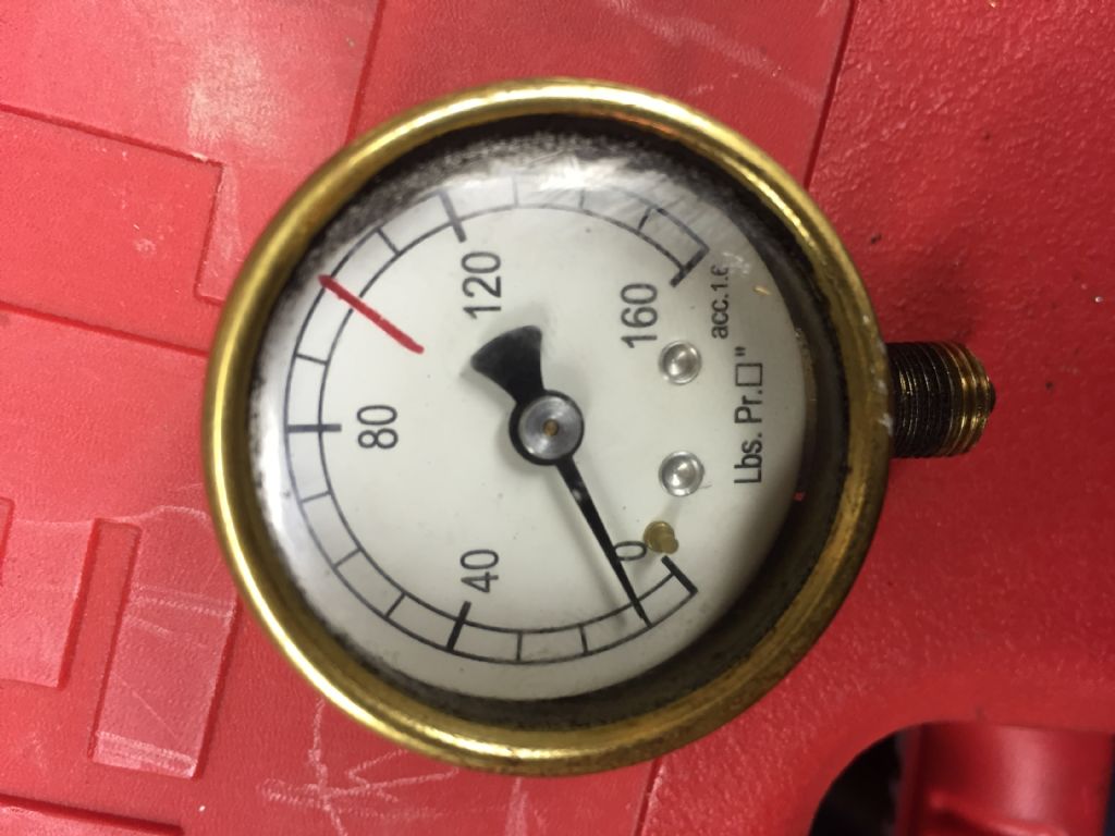

Can anyone please help identify a source for a replacement pressure gauge to match the one in the picture below?
This is a 1 5/8" diameter gauge but the inlet thread is 3/8" x 26tpi, which I assume to be British Standard Brass, rather than the more usual 1/8" BSP.
The gauge was likely purchased sometime between 2005 and 2009.
Many thanks,
Steve Goodbody

Hi. I got mine from live steam models at Long eaton Derbyshire

Thanks Bri, however their catalog lists their gauge as 1/8" BSP.
Best regards
Steve

Make a short adaptor?
