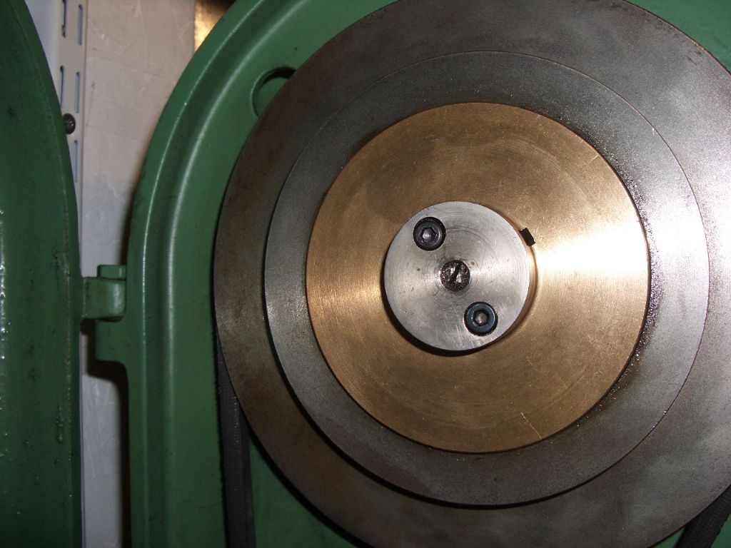

I have been machining a piece of sq. bar 32mm A/f to the round over a distance of 1 1/2" Relativly modest cut .005" or so. Heavier cuts result in a resonant clatter from the clutch/countershaft assy. Investigation reveals a fair bit of radial movement in the clutch drive, before the drive is taken up. As machining off the corners is an intermittant load this is being replicated at the clutch drive , and hence the clatter. Having looked at the exploded view of the motorising assy, it appears to me that the drive is through cone and the two projections (dogs) on the driver plate. Now this may be the norm, but I am of the view that it should not be.( the noise)
Question is, has anyone else come up against the problem, and if you have, was it resolved. Having read the threads of clutch issues, I will not be dismantling to have a look.
Question 2. The assy. drg. shows a hex nut securing the push rod. I attach picture of the assy of my lathe . No hex nut !! Has there been a mod. and it now simply screw into the drive plate?. I look forward to your comments.

Nowadays, when I get a weird noise from the transmission on my S7, my first thought is to see whether the motor pulley has come lose. Might be worth a check before investigating other causes.
And yes, there should be a locking nut on the end of the push rod which may well be the problem, allowing the push bar to come out of adjustment.
Looking again at your photo, although hard to tell from this angle, it does not look like there is much room for a locking nut and I am wondering whether the ball has been left out of the assembly...

The two drive dogs you refer to do in fact wear with age and although you can replace them, the mating faces on the driven plate will also show signs of matching wear.
Fact of life I am afraid.

The clutch lift is adjusted by screwing the pushrod in or out of the steel key plate, when adjusted the locknut that is missing should be nipped up to secure the adjustment. The key part of the key plate fits a key way cut across the end of the shaft and does wear giving the opportunity to rattle. The shaft and the key are hardened but there is very little area to take the loads so it will wear especially with an interrupted cut after a bit of slack has appeared. New shafts are available and key plates but they are not cheap and I doubt the cure would be long lived. There is slack on my machine but I can live with it even though it isn't nice. It wouldn't be difficult to make an oversize key plate but ideally it would be best hardened.

Replacement Key Plate made some time ago, heavily nickel plated, continues to work well.

Roderick. The slot is just below the face of the cone, and on closer inspection I can see that it has been centre popped around the edge, so there was no intention to replace the hex nut. The missing ball would appear to be a likely scenario, but to find out for sure, I am going to have to 'go in'. I cannot find the posts I read about the uncompromising spring. The 'keyword' search, I find, is pretty useless. Was it KWIL who posted a method of dealing with the the spring issue, by the use of long screws , and removal from the drive plate end. It would be usefull for me to have more detail of this approach. If it was KWIL, perhaps you could go through this method again. A PM perhaps?.

Hello Mike, Thanks for your post. The situation is that if I am to return the clutch system to its original form, I will have to extract the operating rod. As I said in my post, the screwed end of the rod has been retained in the driver plate by means of centre pops around the edge to displace metal and is locked by this , rather than the hex nut. I will remove countershaft, to investigate whether the ball is there or not. Regards Lynne

Good Afternoon, Have got the pushrod out; threaded portion looks rather short. Does anyone just happen to have details of the overall length?, and length of thread would be usefull.
