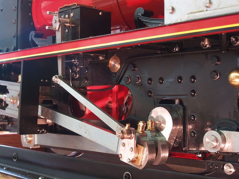

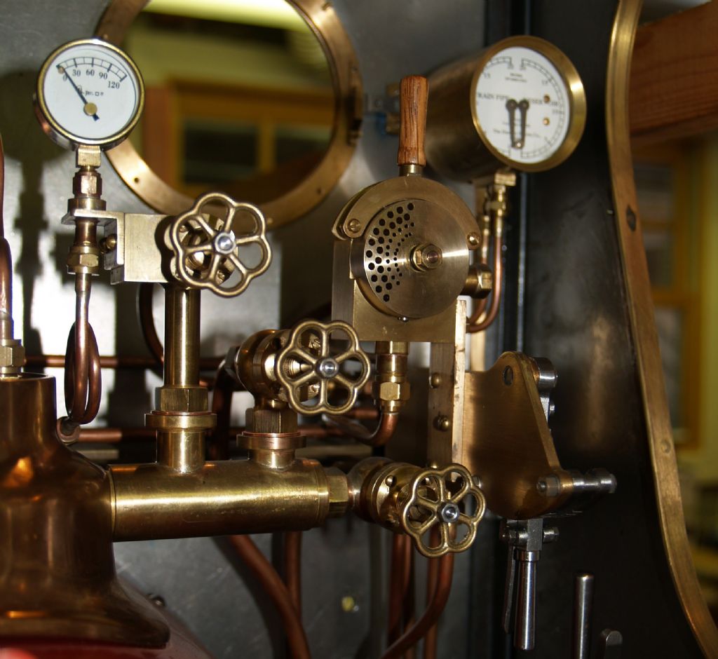

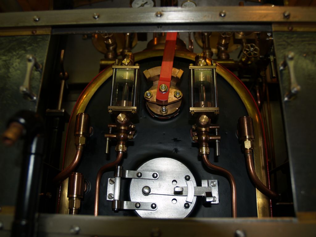

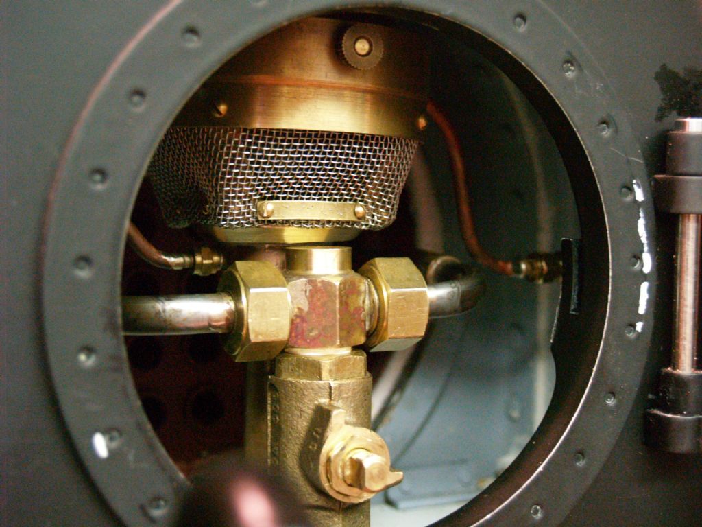

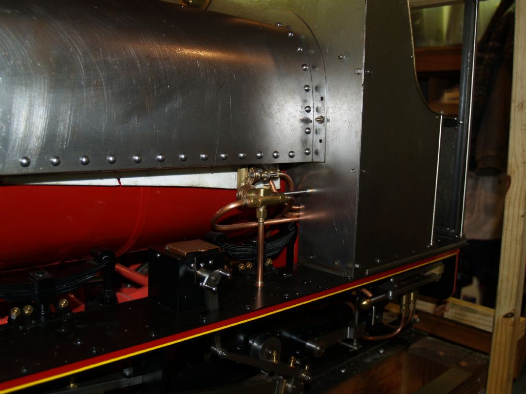

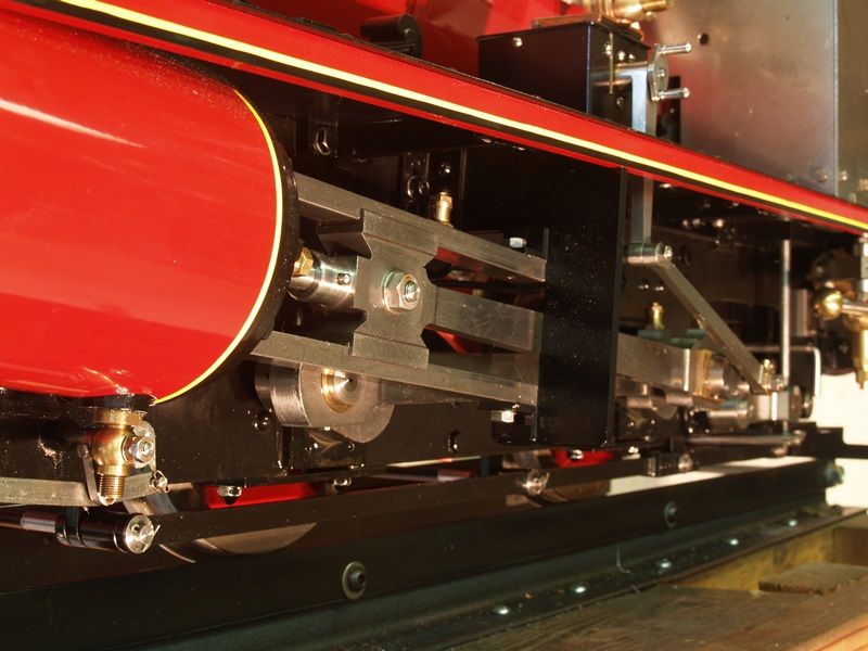

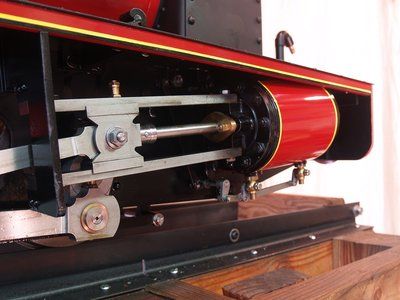

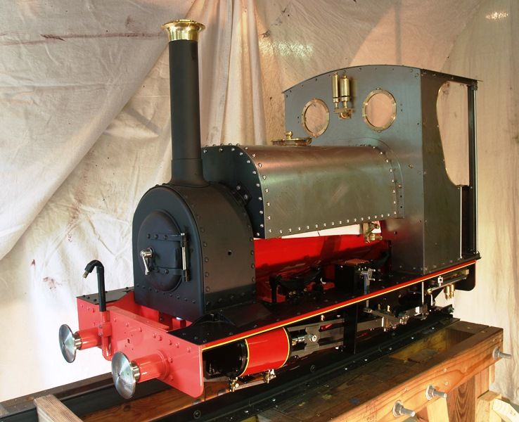

Hi all,

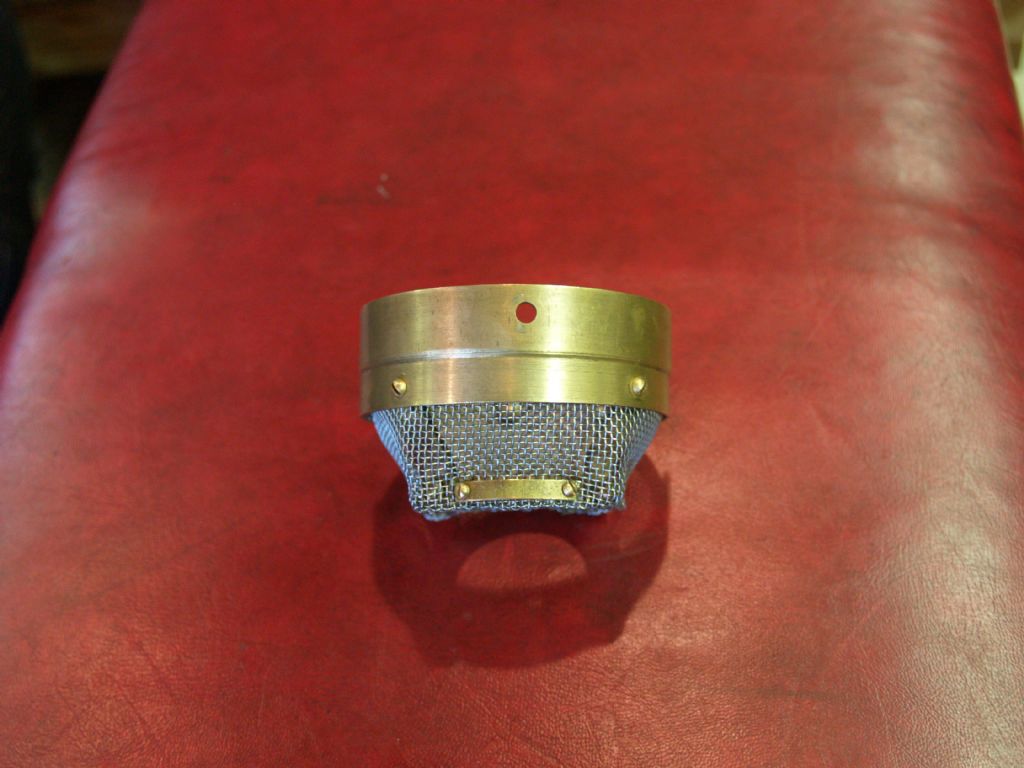

Thought I'd add some pictures of my 3 inch scale Hunslet (Reeves "Elidir" ), under construction now for over 30 years and finally nearing completion. The loco has been built using a George Adams round-bed lathe circa 1905 vintage, a pillar drill, and hand tools - no milling machine.

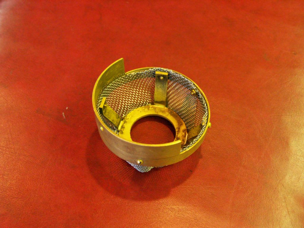

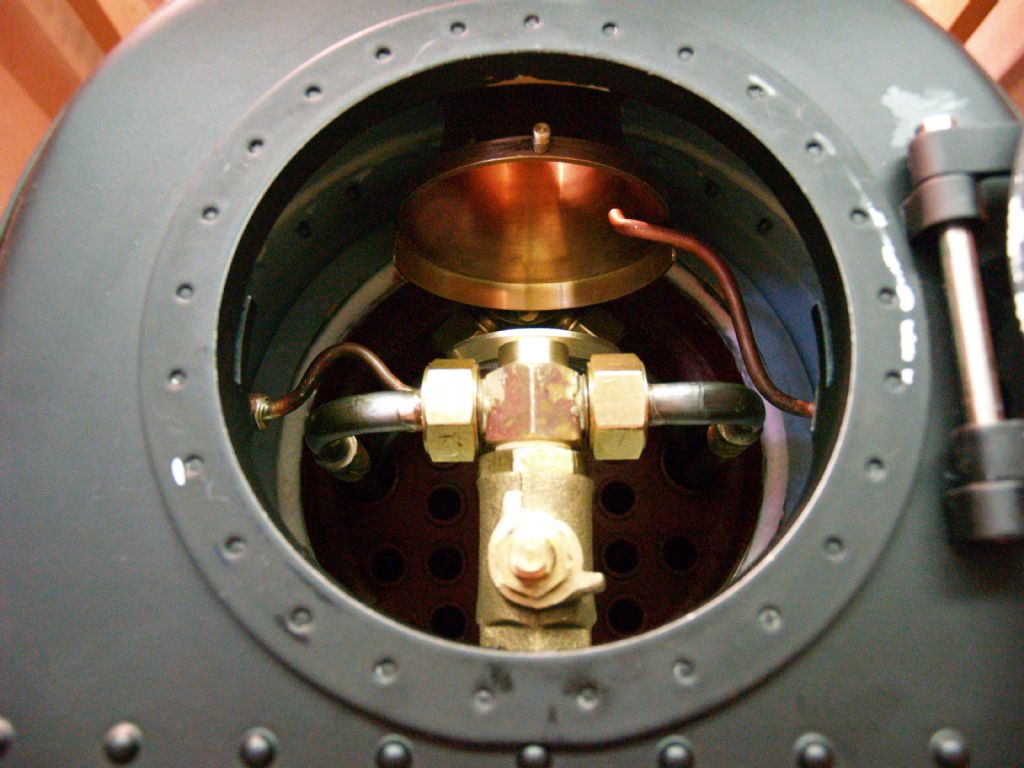

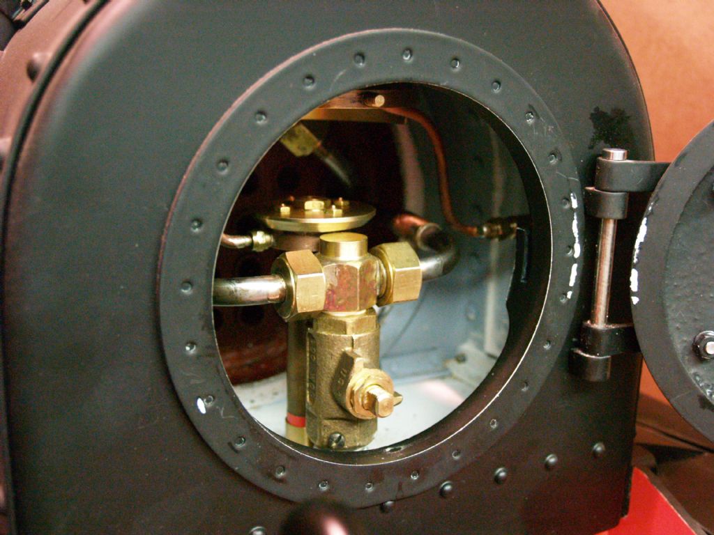

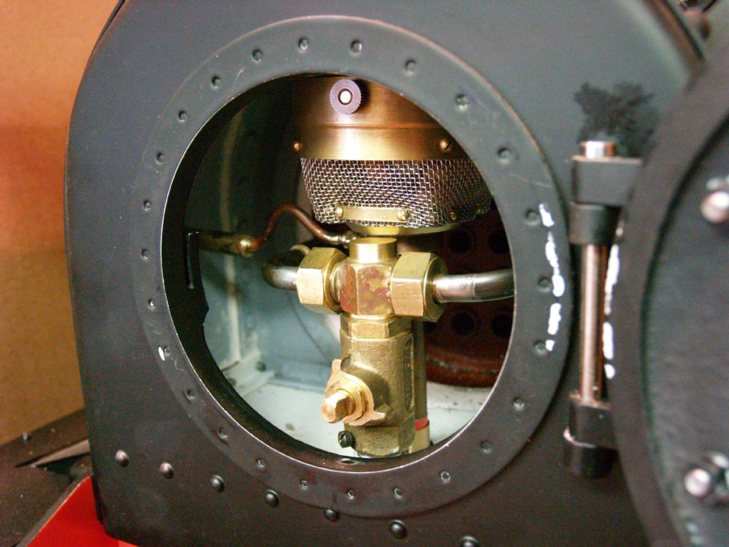

The pictures of the spark arrestor may be of interest to some - it's held in place with a single knurled nut at the base of the petticoat pipe and can be quickly removed for cleaning.
The injectors are essentially to the DAG Brown design but mounted in a modified body.
Best regards to all,
Steve

Very impressive!

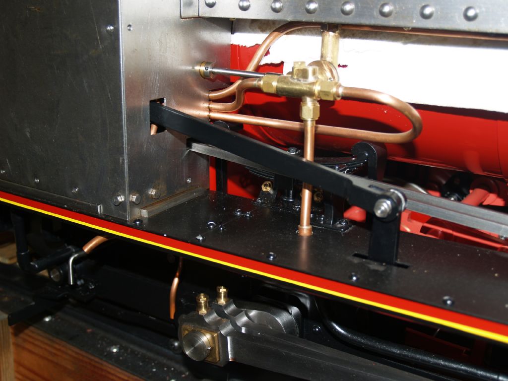

Question: What else is happening in the smokebox, with the cast valve, and the superheaters?

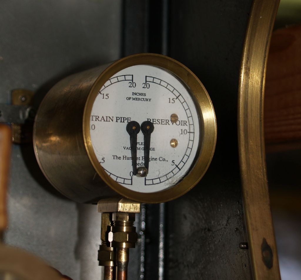

If I can be allowed just one question, among many that spring to mind; how did you get the bespoke vacuum gauge?

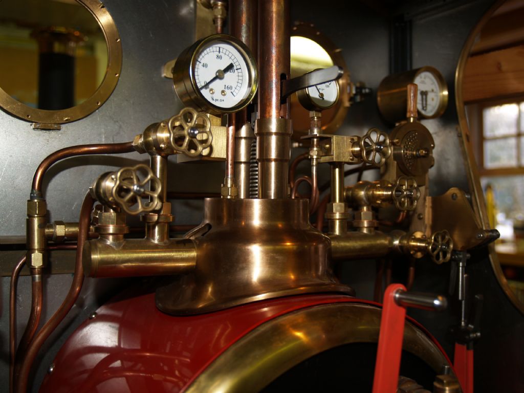

John and Clive - in quick answer to your questions:
John, I configured the smokebox piping to bring the main steampipe in front of the blast pipe (the original design has it the other way around). This allowed me to install this hidden (but easily accessible) commercial ball valve for the purposes of pressure testing, avoiding the need to rely on the regulator as the primary shutoff during testing.
Clive, the duplex vacuum gauge is home-made. I used the two smallest commercial vacuum gauges I could find, stripped them down and mounted them back-to-back and offset to left and right, extended a spindle forwards from the rear gauge, and mounted the assembly in a case. The gauge face is a transparent water-slide transfer on a white-painted bronze disc.

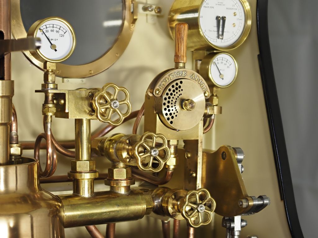

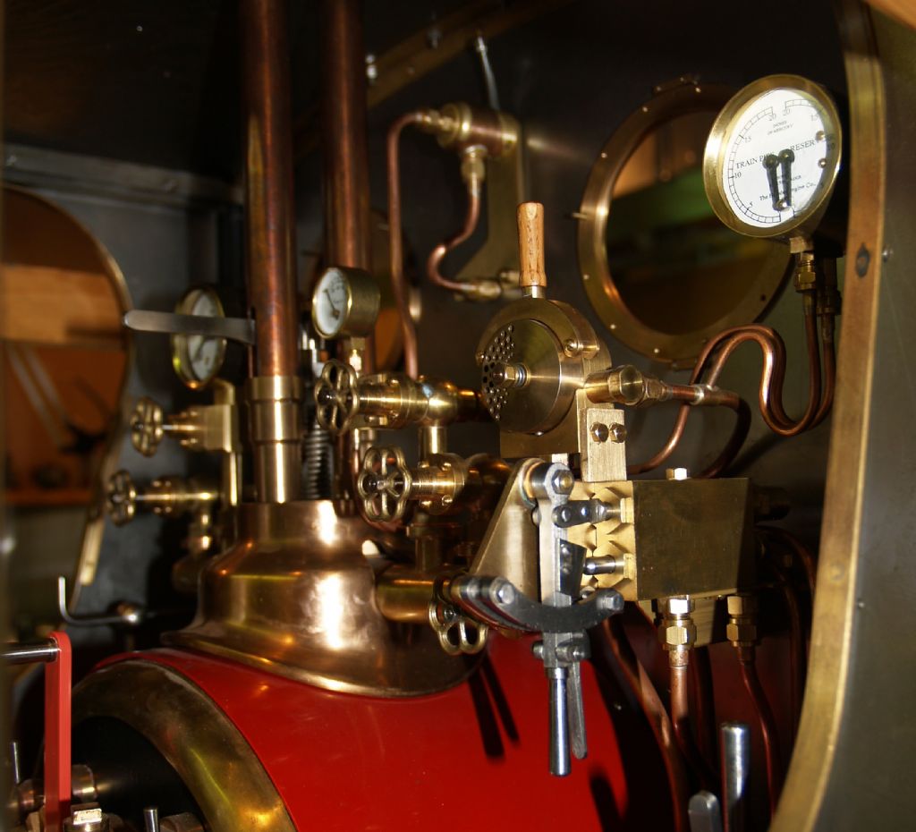

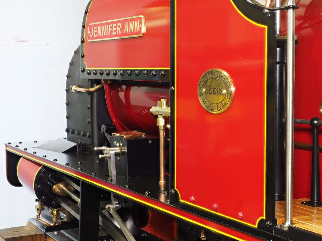

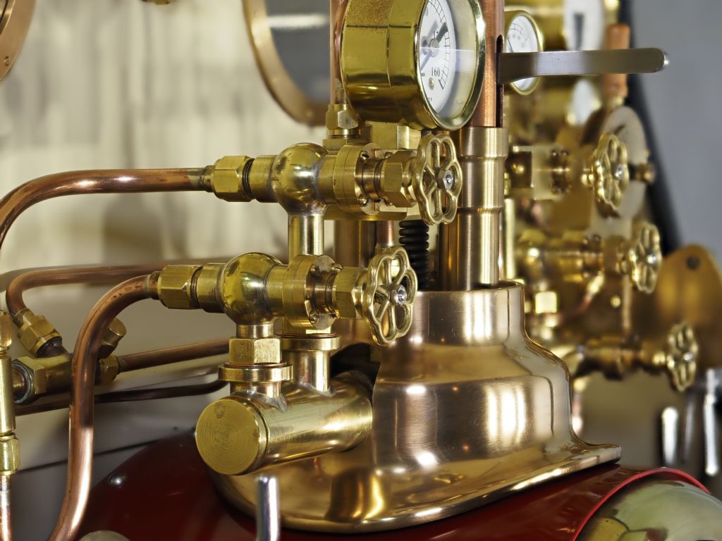

Hi all,
This weekend saw the engine fully back together having spent the past ten months in painting and reassembly. Here are a few pictures before the paintwork gets dirty!

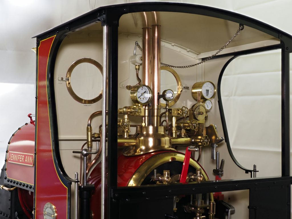

stephen goodbody01/10/2021 23:01:02
74 forum posts
43 photos

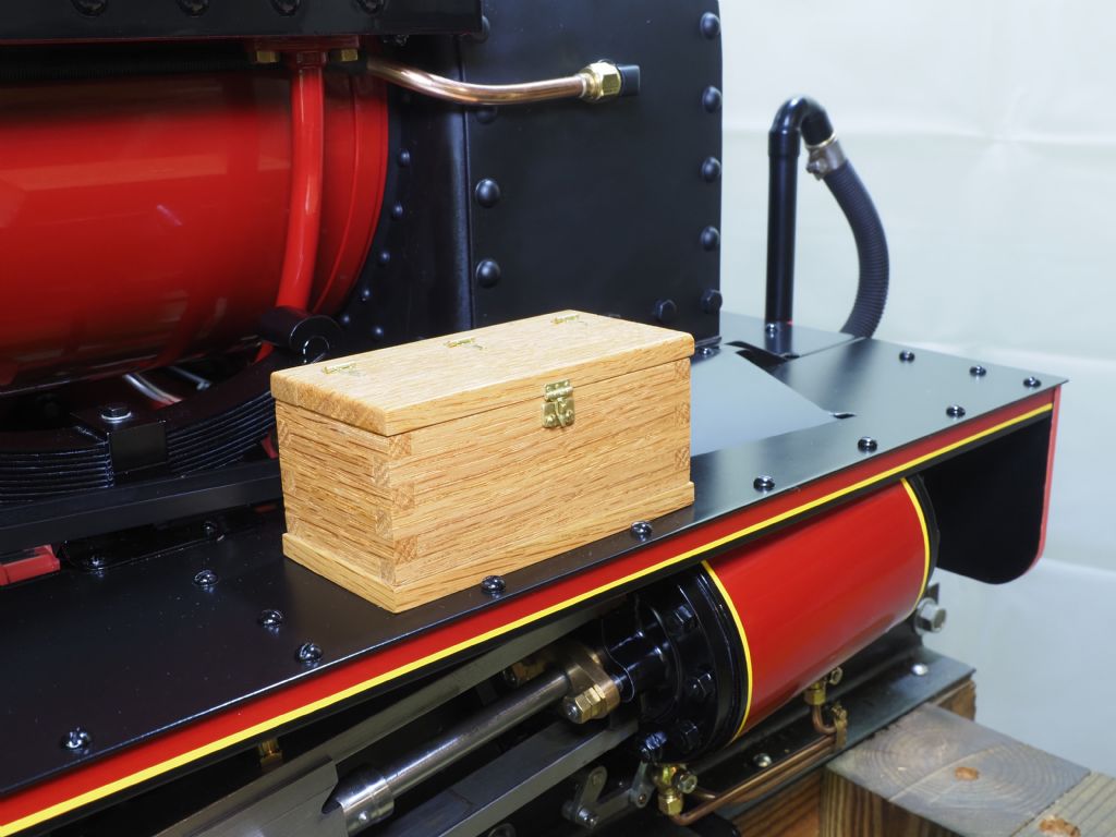

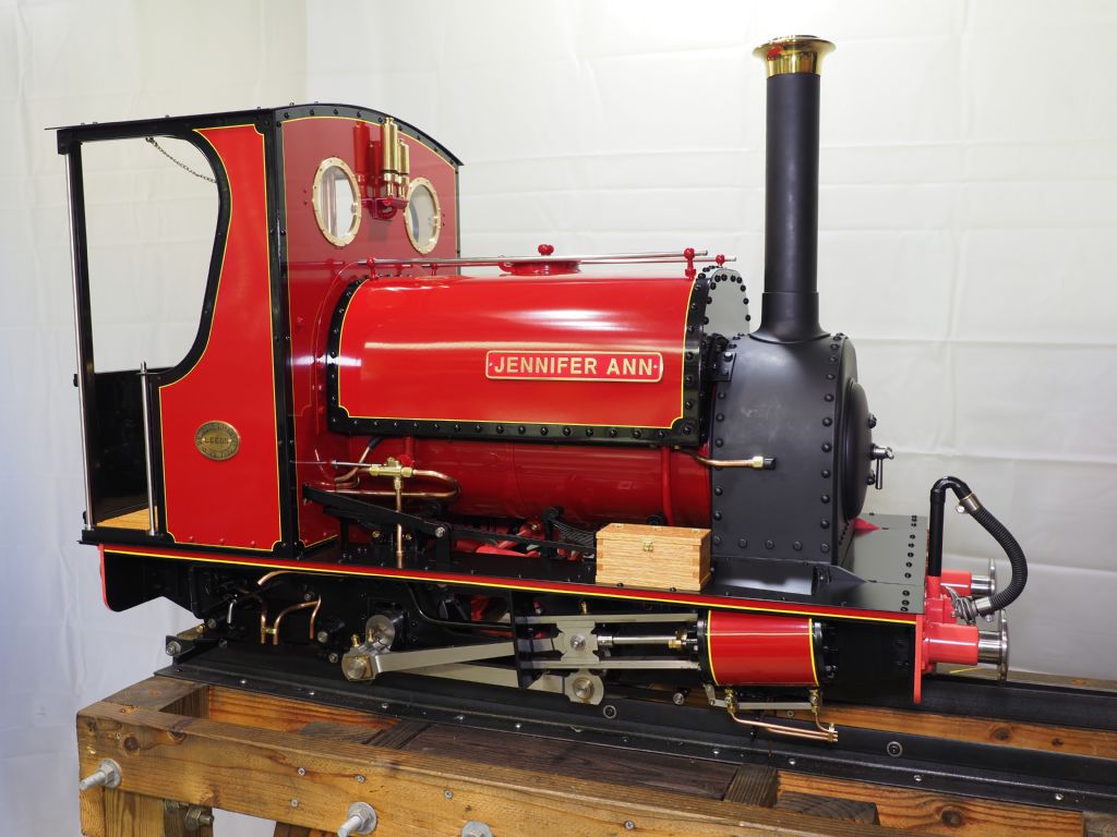

After a year in the making, the first of the three Lynton and Barnstaple-based bogie wagons is finally complete to the point where I could take the loco to the track last Saturday to try everything out.
This was not an unqualified success, the loco foamed and primed badly when under load, so the boiler needs a few more steamings and blowdowns before I will take it to the track again.
In retrospect however the day had more successes than failures and so I'm looking forward to next spring to have another go.
