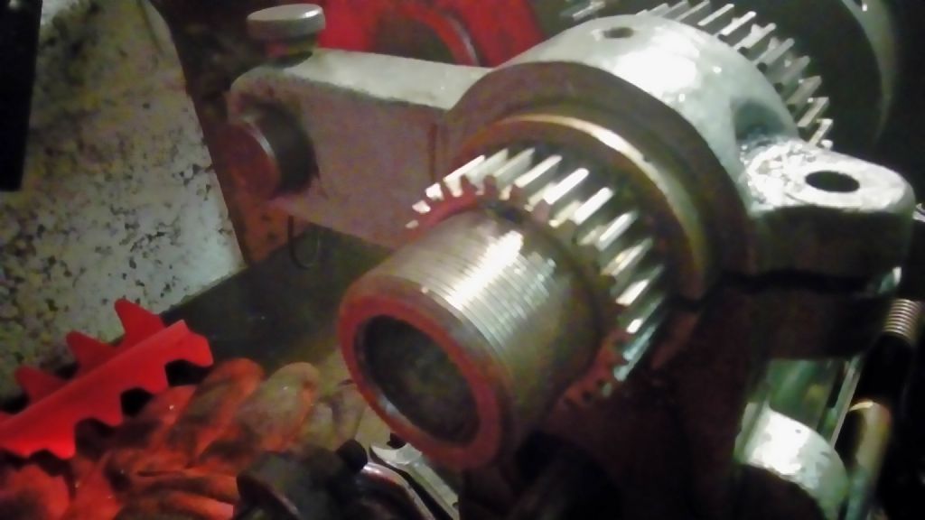

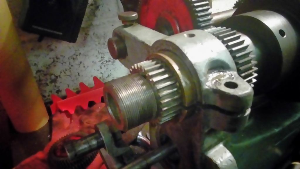

New to the forum, so apologies if this has been posted before. Im presently using an old Grayson which I am in the process of trying to smarten up however I cant seem to get the main spindle out of the casing. This is due to the rear gear (which drives the 2 tumbler gears) being held fast on the shaft. Am I assuming correctly that it screws off just like the collet? I don't want to force it or break any of its teeth? Thanks
Aitken Couper28/12/2017 22:44:10
12 forum posts
2 photos
This is the driven gear. It appeara to have a little notch which i assume is to knock it round to thread it off?
