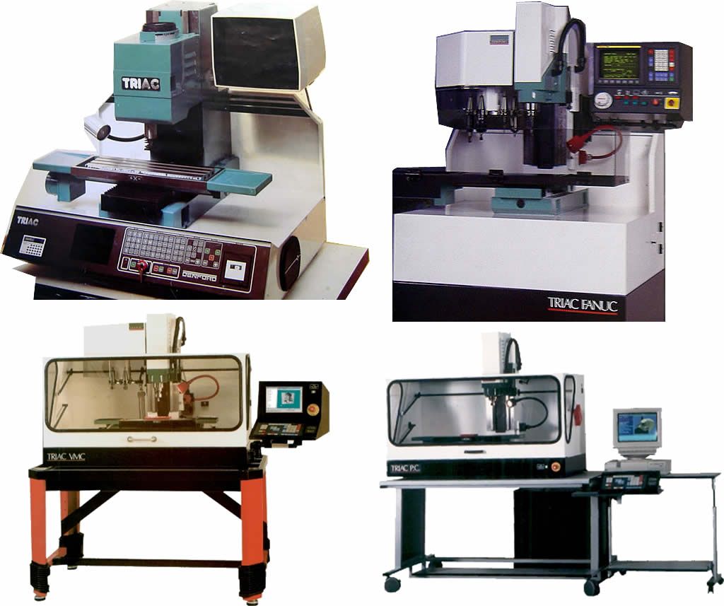

triac range.jpgMark, check in my picture album where you can view some of the variants of the Triac, link below should take you there.
http://www.model-engineer.co.uk/albums/member_album.asp?a=42512

I have had a triac for 10 years or so. They were built for education (who invariably didn't use them) and are very well put together. If the capacity of the machine is enough for your needs I would say that you are unlikely to find anything better. As for the control, yes it is outdated but refitting them is not complicated and there is loads of information about how to carry this out.
Which of Emgees photos does it look like?

Well I have a result! I spoke to the owner (my boss) fully expecting to have to do some haggling but he gave it to me, no cost! Apparently it's ex college and in good nick, he's even offered to get it up and running. Judging by your pics Emgee it's the top left unit, I presume that's an earlier model? Apparently this one has steppers as opposed to servos.

I believe all Triacs were fitted with steppers in std form
Not all of them.
I have an ex-industrial Triac that is different to those shown above - it is on a twin pedestal base, with a removable swarf bin between the legs, with the gas strut balanced, full width lift up front guard. The electrical cabinet is full width across the rear on the pedestals. Control system was a Heidenhain TNC355 (operator station mounted on a swinging arm from the base), with brushless servo drives (can't recall the make, but not "main stream" to all axes. Spinde is BT30 with an Erickson locknut & no ATC. Spindle drive is a 2.2Kw squirrel cage motor directly connected to the spindle with a polyvee belt - it originally had an IMO inverter drive. The machine was bought in to scrap for the electronic parts where I used to work & I bought the carcass for £100.
The Fanuc Triac shown above would also have had servo drives - type dependant upon the exact model of Fanuc 0M fitted (the "A" models were analogue interface, "B" & " C" models were all digital & could only use Fanuc's own brushelss servos).
I really should make room in the garage to get it out of storage - it's only been there 11 years now ! I have the stepper motors, stepper drives, PC break-out board & an inverter already bought in to get it up & running again. I planned to remove the rear mounted cabinet to save floor space & cut out the side of one of the pedestals to let in a smaller box (also already to hand). Unfortunately the lift-up guard & the swarf bin had already gone out in a skip before I got the OK to buy it.
