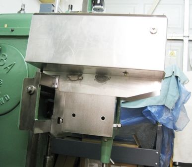

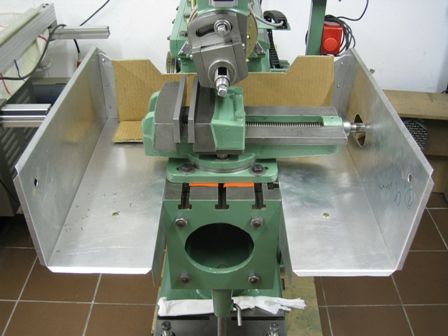

I used my Nice New ALBA NC shaper to make new jaws for its vice, and promptly decided that the next thing to make is a darn Chip guard! Wow, can that shaper toss chips about! As the only space I have left for it is in the Woodwork shop, chips don't go down well in there!
So, here are some pics of the guards - quickly fitted and removed by means of 4 thumbscrews, and 4 ex-hard-disc drive magnets siliconed to the guards:

Two right side thumbscrews
Two left underside magnets

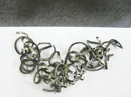

One bar is 12mm thick, the upper bar in the pic below, the other is 16mm thick. The 12mm bar made horrid chips - all squashed and scrunched, torn out of the bar, while the lower bar chips curled off nicely. Both mild steel, with black scale, flame cut to sort of size - supplier could not tell me what grade/type of steel these were!

The lousy chips come from the upper bar in the pic below...Surface finish is strange! Same feed speed, DOC, ram speed and cutter as the lower bar. Upper bar cut first.

richardandtracy01/09/2017 16:01:06
avatar
943 forum posts
10 photos
I suspect the upper bar was structural steel. Had the same finish on a bit of S275 (430 N/mm^2 ultimate, 275 N/mm^2 yield, weldable fine grain steel) from a channel section. Not nice finish. Retains grease well, if it's any consolation.
