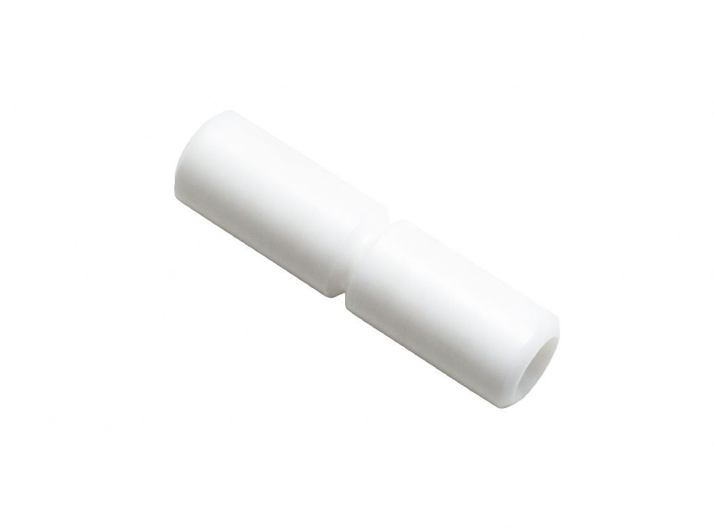

Hi there,
Need some much needed advice, i am looking for my first lathe,
i do not have a workshop so it needs to be as small as (and quiet if that's possible), i plan on making up a load of handles in bulk made from delrin plastic so the lathe needs to be capable of running constantly without over heating (as i've researched, the emco SL 1000 can only handle about 8 minutes constant use and 2 minutes cooling at a time??)
budget as low as possible but was hoping to buy british not chinese.
ultimately i want something that is going to be a joy to use not a hassle, as one of the chaps here on the forum said "spend more and buy once or spend less and end up buying twice only to spend more anyways".
the handles are 25 mm in diameter and about 3" length, i plan to buy delrin at the diameter i need to reduce time. hope i didn't miss any info from that..
thanks all

Looking to replicate something similar to this, central groove and a softened edge on the sides, doesn't have to be bored out but ultimately i would love to get a lathe i can play around with and learn on aswell, its difficult because i dont have the space and im in a terrace house so keeping the noise to a minimum is very important - we used to live directly next door to a lathe workshop and it would make our living room shake, i cant and won't put the neighbours through that
in terms of quantity i need hundreds of them until i can afford to get them cnc made in large quantities
thanks for the advice thus far, im noting all of this down!

No offence, but I think it would pay to rethink your requirement. I'm afraid 'budget as low as possible' isn't compatible with 'spend more and buy once'.
Your choice is really between new and second-hand. Buying new, a Chinese mini-lathe will do the job out of the box. You may have to slow down your production rate to keep the motor cool but Delrin isn't much a challenge to a metal cutting lathe. A Chinese mini-lathe is small, quiet and unlikely to annoy anyone. After you've learned from it, you will have a much better idea what suits you; the training alone is worth the investment.
Second-hand is more difficult because you have to find one. Is it in good condition or knackered? What tooling does it come with? Can you get spares? Is it a bargain or a rip off? Do you have the time to get it going or do you have to make handles immediately? Can you lift it and will it fit?
If you're in a hurry, keep it simple and start Far Eastern.

If you want to make hundreds of the handles as shown then a manual lathe, far east or British, is the wrong machine. Even with a capstan unit (and the availability of that points to a UK/US ex-industrial machine) on a manual lathe it is tedious making multiple parts.
I have a repetition lathe, which would eat handles like those for breakfast, but it is not something you could run in a terraced house. It is small enough, about the same footprint as a Myford, excluding the pneumatic bar feeder. But it's quite noisy due the compressor pump, and it absolutely needs a 3-phase electrical supply.
Ideally you need a repetition or capstan lathe. Having said that, I'm surprised you can't find a commercial machine shop that will churn out a few hundred handles for less than you'd spend acquiring a lathe, let alone accounting for your time learning and using the lathe. I'd have thought that the material cost would be the limiting factor, not the machining cost, for a commercial machine shop.
In theory the Myford capstan lathe mentioned above might work, but I don't think it'll take 1" down the spindle.

A capstan an bed stops are essential if you are to achieve repeatability, as even using a QCTP to swap tools (looks like you could get away with two form tools) will slow you down and cause frustration.
The next MEW's reader classifieds will include a 1937 Myford Capstan lathe with lever parting, which would potentially do the job better than any modern plain lathe, but an 80-year old machine will be a bit of a gamble for commercial use! Also it is without any collet or collet chuck.
Most bench lathes won't have the tailstock stroke to drill through those handles in one go, you WILL need a lever tailstock with plenty of travel as moving the tailstock continually will drive you insane.
Neil Wyatt29/07/2017 08:25:17
avatar
19226 forum posts
749 photos
86 articles
Hang on, is that something like a kite handle that you will tie a cord around?
Might be better to use a bit of lateral thinking.
  • Cut big pile of blanks to length with a chop saw (one with a TCT blade for wood will be best).
  • Form too in lever tailstock to shape end.
  • Collet chuck on lathe.
  • Pop blank in chuck, round end.
  • Reverse, round other end.
  • Plunge in form tool from locked cross-slide to make groove.
Almost any lathe with lever tailstock and a lever release collet chuck should do the task. The chuck might cost as much as the lathe.
