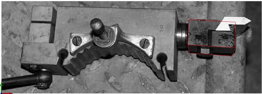

I have purchased a bunch of Mulitfix toolholders from Create Tool including the retracting threading toolholder, which uses KOMET inserts. I had a hard time finding inserts, in fact could not, and Nina at Create Tool obliged my request to make me a modified tool shaft I could self machine to take standard threading inserts.
Some folk simply sawed the head off the standard holder and welded on a head from a normal threading tool holder, but that did not seem so great..
I sent her this, indicating that the red block should be a solid block, un-hardened, so I could machine it.
She sent back this drawing which I accepted and that is what they made for me - I took 2 and will modify for suitable inserts soon.
And Then....I found a well priced, very quick source for KOMET threading inserts, and other bits, in Germany - Hoffmann Group ( I think they are in the UK as well?) 5 Day delivery from order to my door in Namibia! Takes 8 days for something from neighbouring South Africa..
I suppose I have to make the usual statement - not associated or have any interests in Create Tool nor Hoffmann, but both were utterly professional, went out of their way to help, responded right away - recommended!

I purchased one size A , external threading holder, complete with normal slide-shaft KOMET insert holder - Type AFE.
I also purchased one size A, internal threading holder, which as is typical of these, takes normal internal threading bars, ie, like a boring bar but with IR style inserts.
The 'modification' is just a swappable slide shaft with the end un-machined ( No KOMET fitting) so I can machine to take ER16 (or smaller) type inserts.
The other toolholders I purchased are a mix of the standard holder for square/rectangular cross section cutting tools and the boring bar holder - A holder with a V base and also some V inserts that slip into the V of the holder, allowing use of small diameter boring bars.
All these items fit my 'original' Multi Suisse tool post perfectly. Or at least the toolpost is labelled as such..

My Multifix tool holders all arrived from Create tools, and I am very happy with the goods. All fit the Swiss original tool post just fine, workmanship and quality is very good indeed. The blank shaft s for external retractable threading tool holders came out very well indeed. ready to be machined to take standard threading (ER) inserts.
Size A, and enough to keep the EMCO 14D happy..
A happy Chappy..
Joe
The blank shaft/holder
