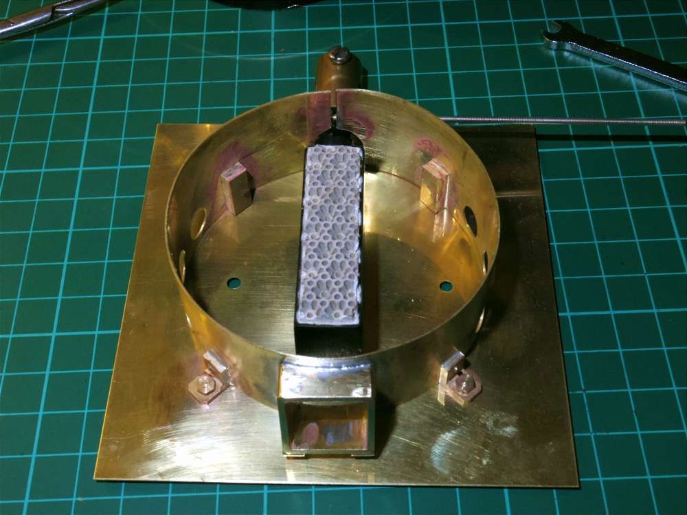

A couple of years ago I got a Graham Industries VR1A and made a simple horizontal boiler which was heated with gel fuel to run it. This worked well but I decided to make a better steam plant for the engine... because I can.
While visiting Blackpool Model Boat Show last year I acquired a Brue boiler made by Helen Verrall-Stait for a very reasonable sum. The boiler came with wood cladding and a chimney but no fittings. Most importantly, it did come with a test certificate and paperwork.
A quick rummage in the bits box produced some fittings and the chimney was replaced with one from another boiler.
I wanted the burner tube at the rear of the boiler and of course some means must be found to secure the boiler to a base. (Otherwise it may wander off when I'm not looking...)
So this is what was required -
  • A firebox for the boiler which should be raised 12mm to allow a Bix 009 burner to function efficiently and have sufficient ventilation.
  • A means to affix the firebox to a base.
  • It should have a door on the front so the burner can be lit (and to allow for observation of the burner flame).

With the holes in the firebox drilled it is guillotined to size and the opening for the burner cut with a fretsaw. Horizontal cuts are made for the firehole as it is easier to do this while the metal is flat. The rest of the material is left in place to provide structural integrity during the rolling and silver soldering processes.
1/32" rivets will be used as pins to locate the brackets and supports during silver soldering.
I was struggling to come up with an effective design for a latch for the firehole door which is 20mm wide. Then I realised that if I angle the front of the firehole gravity will hold it shut. smiley
Henry Artist09/04/2017 09:38:22
avatar
121 forum posts
46 photos
The firebox has been rolled in a 3-in-1 machine, clamped and silver soldered.
It will stay as a complete ring during the other silver soldering processes to attach the mounting brackets and boiler supports.
Once the silver soldering is completed a fretsaw is used to open up the firehole and a razor saw used to cut through the join and the tube. This tube will form the clamp to attach the firebox to the boiler.

With the silver soldering completed it is time to make the base plate for the firebox.
A piece of aluminium sheet (0.9mm) and brass sheet (0.5mm) were cut to size. Transfer punches were used to mark the location of the screws.
The aluminium sheet serves several purposes -
  • It prevents unwanted marks on the brass sheet.
  • Eliminates burrs on the brass sheet during drilling.
  • Ensures correct alignment of the mounting screws during soldering.
  • Will help to prevent the nuts being soldered to the scews. (Been there. Done that.)
  • Prevents distortion of the thin brass sheet during soldering.
  • Will act as a drilling template when it is time to mount the steam plant on a board.
To make the hinge on the firehole a length of 2mm OD, 1mm ID brass tube was silver soldered to it. The ends of the tube were cut flush with the sides of the firehole and the middle bit milled away. A similar procedure will be used to make the hinge on the firehole door.
Also in the above picture you can see the Bix 009 burner that will be used in this project and a second firebox for a marine steam plant.

The aluminium and brass sheets are taped together and drilled.
A test fitting shows that they go together in a satisfactory manner.
Four brass M2 screws are soldered to the underside of the base plate and the firehole is soldered to the firebox. The inside of the firehole is cleaned up with needle files.

Some views of the firebox without the boiler in the way.
Firebox 1
Firebox 2
Firebox 3
Two screws will be used to secure the base plate to a board. They are hidden inside the firebox in a vague attempt to keep the appearence of the finished steam plant fairly neat.
Stainless steel M2 threaded rod is used to clamp the firebox to the boiler. This will (eventually) be cut to length.

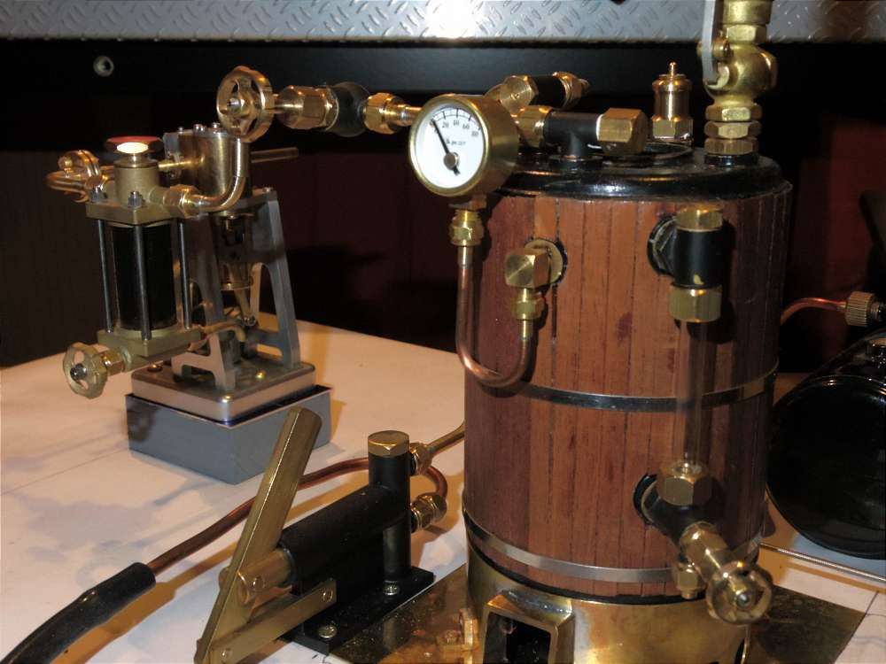

The Bix 009 burner has been installed in the firebox and tuned in accordance with the comprehensive instructions that came with it. You can buy Bix burners here - **LINK** (Shameless plug! thinking)
The boiler has been test steamed. It works! Yay!
The boiler was then temporarily connected to an MSM Tyne marine plant for further testing. Since it ran the Tyne engine in a satisfactory manner I felt more confident about this project. (Well there are always those nagging doubts... Will the boiler be big enough? Will it make enough steam?)
Using the procedures detailed in the previous post, the VR1A has finally been connected to the boiler.
The engine is mounted on a block of wood to give clearance for the flywheel.
Between the engine and the block of wood there is some aluminum sheet. This prevents the engine becoming stuck to any varnish or paint that will be used on the block. (Been there. Done that. Had to use a gas torch...)
A T piece has been fitted at the steam outlet from the boiler so orphan engines can be run in future.

Progress continues...
With the burner intalled beneath the boiler and the boiler connected to the engine we have the basic elements of a functional steam plant ready for a test run.
A Mamod flywheel was fitted to the engine and connected to the line shaft with 2mm nitrile rubber drive band. This works waaay better than the springy metal drive bands. I affixed some Wilesco workshop tools to a board for the test run. So much more interesting to watch an engine driving something...
