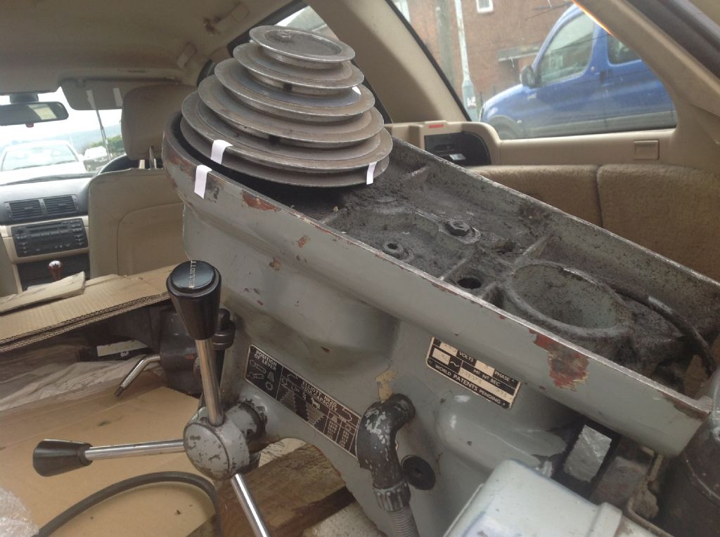

Hi all, many thanks for the feedback on my question regarding the Prima clamp that came with an Elliot pedestal drill I've recently bought, sorry but I have another question regarding the actual drill, it's still disassembled and when set to direct drive (it has a two speed gearbox) I noticed there is quite a lot of backlash on the top pulley before you hear a clunk and the chuck actually starts to move one way or the other, the backlash is marked by the white stickers in the photo, about 1/4 turn which seems excessive to me, there is virtually no such backlash when the slow gear is engaged, could someone tell me if this is a fault or do I need to repair before I start to restore?

Paul, my Elliot has the same backlash as yours, and I've never got to the bottom of the cause. It's fine in the slow gear.
I have removed the quill in the past to replace the bearings, but was in a rush and couldn't figure out how to remove the top pulley to investigate the backlash (the quill winds out and leaves the pulley in place).
It has never caused me a problem, but if you don't wind the backlash out before you start the drill it can make a horrific clack as the slack is taken up.
Be interesting to hear if anyone has any ideas.

Agree with Andy, mine's the same ..... I've used the drill for probably 30 years, probably in the same condition, and I don't think it's any worse now that it was when I got it. And I've certainly given it some hammer.
When I bought it I changed bearings and the large tufnol gear in the gearbox, so, although I cannot really remember, I'm sure I would have removed the backlash at the time if I could have. So I have a suspicion that it may have been designed like that.
I'm guessing that it's clearance in the dogs that engage the gears. Loads of clearance would make it easier to engage I suppose.
So, my recommendation is don't worry, just enjoy it, they are wonderful machines, built like brick outhouses !!

I also have an Elliot 2G, I bought it around 20 years ago and it also has always had a large amount of backlash when it the high range. I have always done as Andrew mentioned, and just wind the chuck backwards before switching on to take up the slop to avoid the sharp loud clunk.
When the low range backgear is engaged there is only a small amount of backlash.
Many years ago I did remove the gearbox cover and couldn't find any wear or broken parts, so I think it may be just the way they are made.
A few years ago I bought a three phase motor and VFD for it, and these can be programmed to give a very gentle startup and acceleration up to speed. So, as well as other benefits, that should remove the need to wind the chuck back before starting, once I fanaly get it fitted.
