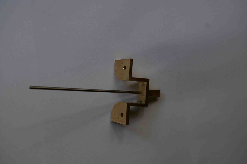

Alan Charleston06/01/2017 05:33:42
157 forum posts
26 photos
backcock2.jpgHi all,
Thanks for the help. I got stuck in and have made the back cock.
The plate connecting the two pieces of angle was silver soldered and the pendulum post was soft soldered into position. I'm pretty sure it will be strong enough.
I haven't slit the post for the pendulum yet as I don't have the .006" spring steel or a 0.2mm slitting saw.
I can source some .006" spring steel shim plate locally. Will this be OK for the suspension spring?
I will order some 0.2mm slitting saws from CTC Tools. At $2-50 each I'll get a few of them I think. The thinnest saw I've used to date is 1/16" so any suggestions about things to watch out for will be welcome.
Here is a picture showing where I am at the moment. The wheels and pinions haven't been loctited to the arbors yet. I want to have the pallets in position so I can see the whole train before I set them in their final positions.
Thanks again for your help.
Regards,
Alan C.
