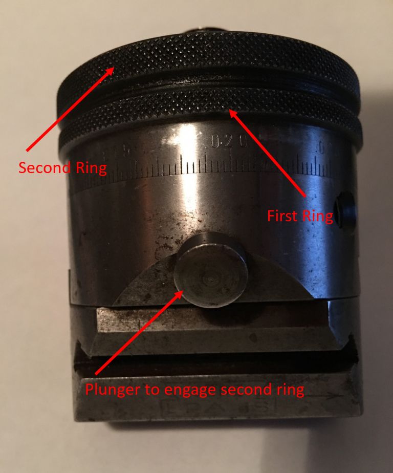

I am in a quandary as to what to do with a Lenz LPA 1s automatic boring head I have acquired.
It looks to be in good condition and the first ring on the head (lower ring) certainly moves the slide left and right but then I realised the second ring (Upper) did nothing even when the engage plunger was pushed in.
On investigation the upper section seems to be missing a number of vital components…

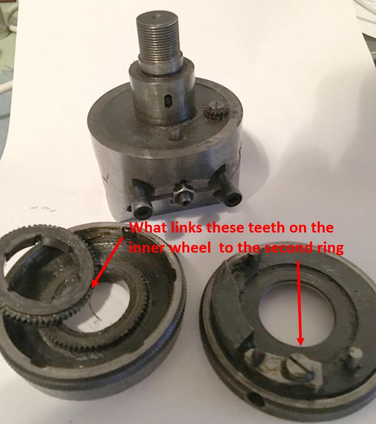

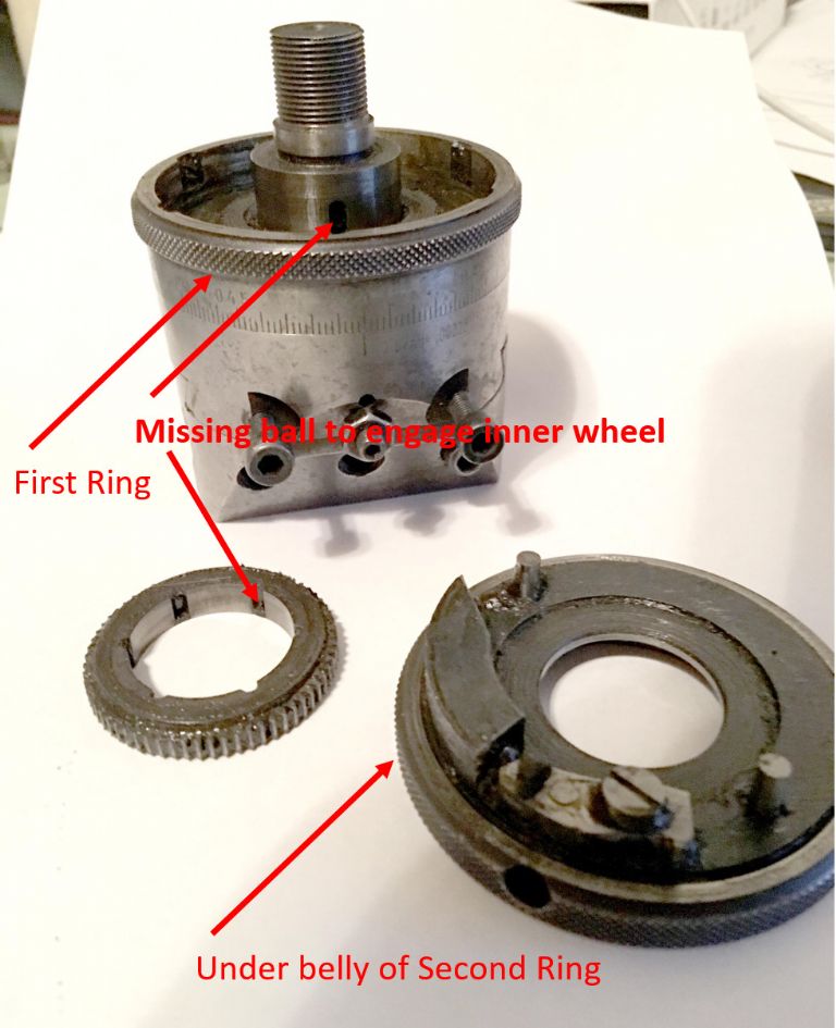

Plunger would have activated a second inner wheel (toothed cog) however there appears to be a ball / tooth missing to engage the wheel. This is an easy fix…
But then I realised that with the inner wheel engaged…. There is a ???? missing to connect the inner ring to the second ring. The second ring appears to have a mechanism similar to a brake, or engagement lever. The wall also appears to have a ridge applied to it so that something can temporarily lock in place….
Does anyone have an exploded diagram of this type of head as I have trawled the intraweb thingy and there is nothing?
Any help restoring this would be appreciated.
Dan

I think there might be two small gears missing from the two posts stuck up from the underbelly
I'm not familiar with that particular head, but have recently stripped a poorly Kuroda head which looked very similar in design, and it had the two small gears.
have a look in my photo archive, there are some pictures which might explain better.

I had wondered what those pegs were however having looked at your photos which has a gear upper and lower and from the photo above the toothed wheel is split which I had originally thought was done to slot the upper ring so that it could be engaged via the plunger.
I am now thinking that the geared wheels that sit on the pegs could also be split. one for upper toothed ring and one for lower ring....
What gives me a bit of confidence is that yours is not a Lenz and there are similarities so I might start trawling the tinter thingy for a manual on any old auto head.

By some mad coincidence I've just picked up a complete and (hopefully) working Lenz LPA1 as a replacement for the defunct Kuroda, it came with a full instruction and parts manual complete with drawings. Have got a pretty full on week coming up, but if I get the chance I'll scan it for you, if not, then will do it at the weekend. Bad news is you should definitely have two small planetary gears present.
