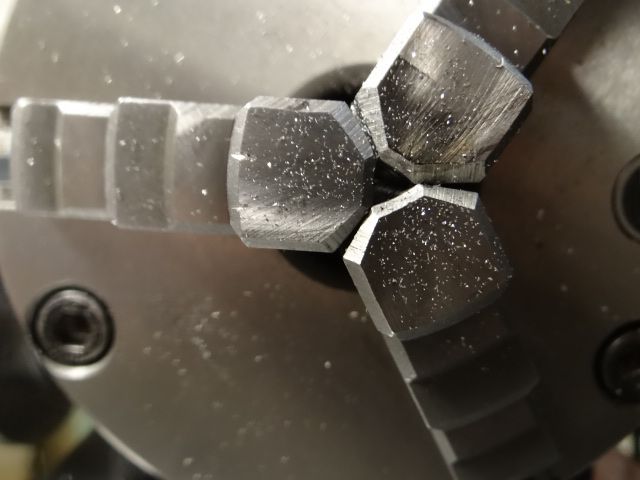

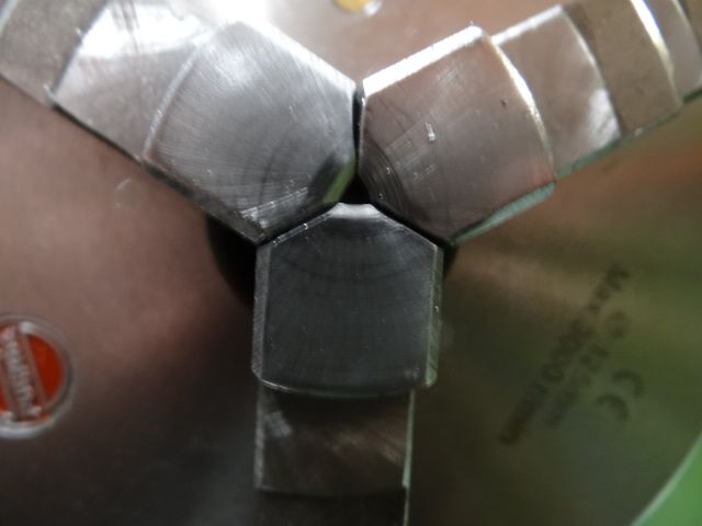

Quick lack of progress report with special thanks to the two Michaels. I'm going to have a good look at the scrolls later, but the chief suspect now is the jaw grinding. If this is the fault, it means that Inspector Clouseau here has been using a squiffy chuck for over 2 years without noticing!
This picture is of the jaws in my lathe. The chuck is satisfactory and you can see that there's a reasonable triangle where the jaws meet. (Jaw 2 is on the left.)
Next picture is the offending Rotary Table Chuck, where the jaws meet in a noticeably coarse triangle.
Ian P's suggestion about using a different technique has considerable appeal and reminds me again that there's usually more than one way of skinning a cat. And now I wonder how much of the quality work I admire so much is produced by people who know how to overcome the shortcomings of their tools, not by using high-end kit? If that's the name of the game I still have lots to learn!

Today's experiments revealed that the run-out varies from as bad as 0.4 to as 'good' as 0.15mm, this effect being achieved by removing and reinserting the jaws. I would have thought that a faulty jaw would be consistently wrong.
Then I measured the outer-jaw set and found that it also has exactly the same run-out problem. Finding that two jaw sets have the same error got me suspecting the scroll.
I had a good look at the scroll through the slots and it seems OK, but then I wouldn't expect to see a small error.
Thinking critically about things I've done that could damage a scroll I came up with an 'own-goal' scenario.
Is it possible to damage a scroll by winding the rotary table round and catching the end of a 'left in' chuck key on the body of the table? I've done that a few times and thinking about it, the torque resulting from a 90:1 reduction drive on the far end of a chuck handle might be super-human.
I'm careful never to leave a key in the chuck of my lathe, but have certainly been careless with doing just that on my rotary table.

SillyOldDuffer07/10/2016 19:28:37
10668 forum posts
2415 photos
Posted by Michael Walters on 07/10/2016 18:33:36:
... Getting back to your Chuck, The RT, is it a front mount chuck on a tee slotted base? or a threaded nose?
... could be that jaw 2 has worn thin and it might have some noticable slack?
... maybe theres a chuck out there where its very subtle?
Michael W
Edited By Michael Walters on 07/10/2016 18:40:09
Hi Michael,
It's a front mount chuck on a tee-slotted base, and I've confirmed that the alignment at that point is OK.
I've looked at the chuck threads on all three jaws and they're unworn.
I wondered if I was doing something daft loading the jaws but it's standard stuff. I also tried loading the jaws in the right order into the wrong slots and got the expected result, that lowest run-out was obtained by putting the jaws in the correct slots, 1,2,3. What I forgot to do was to note down the measurements so see if the error follows a jaw round the chuck, doh!
Ta,

SillyOldDuffer09/10/2016 17:43:31
10668 forum posts
2415 photos
Fixed it, hurrah!
I did the check suggested by MichaelG and didn't find anything abnormal.
Then I discovered that the chuck mount could be rocked very slightly on the rotary table, and that the degree of rocking corresponded with the chuck run-out. ( Not obviously loose, it was necessary to give the chuck a good hard pull to move it. )
Removing the mounting plate from the rotary table revealed a fettling problem. Two of the chuck mounting bolts were long enough to bottom out on the rotary table, one being longer than the other. Making it worse, some swarf had got into the holes such that the chuck was jacked off the rotary table and no longer parallel with it.
Cleaning the swarf off and reducing the length of the chuck securing bolts by a millimetre has done the trick. Reassembled, the chuck run-out at 50mm is a much more reasonable 0.03mm.
I would have noticed the problem before if I'd ever used the the rotary table without the chuck. All became clear as soon as the chuck mounting plate came off .
Lesson learned - check everything!
Thanks again for all the advice and pointers.
