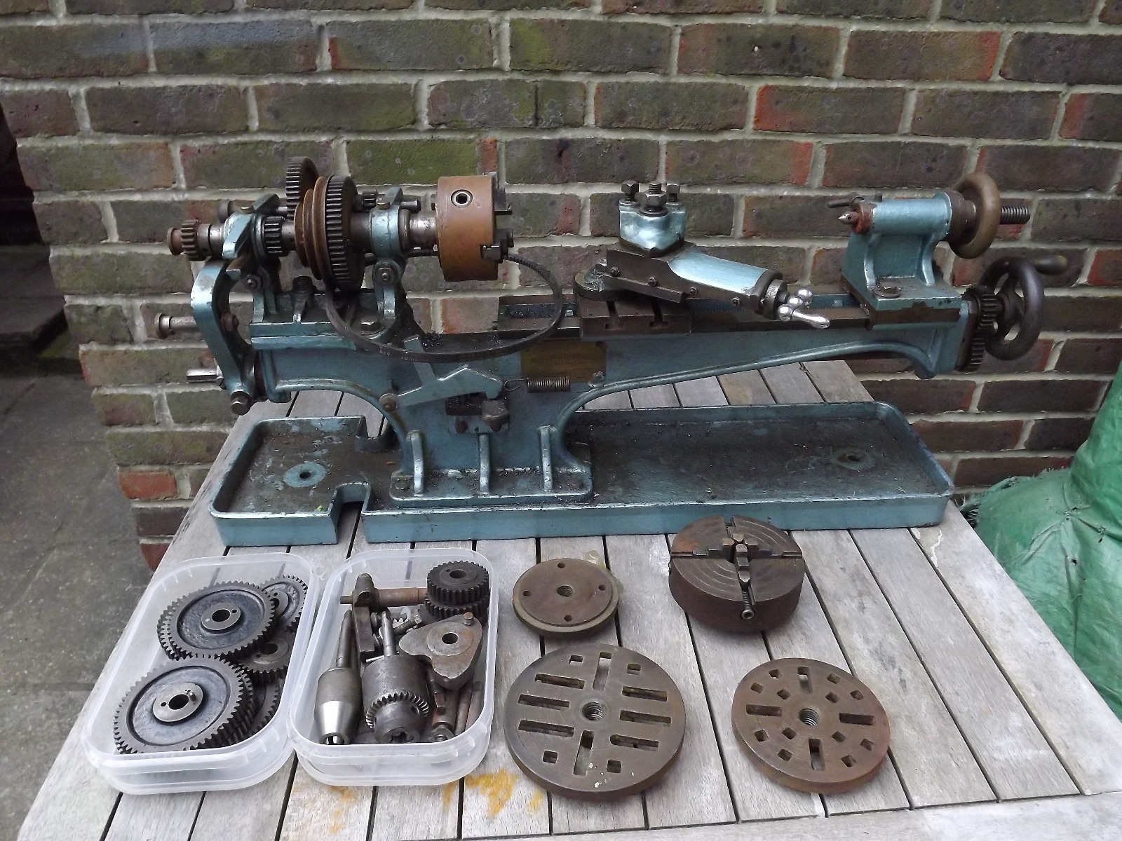

There appears to be a pair of drilled and tapped holes added to the top of the cross slide for some sort of actuating rod to be attached to. Probably something like the below pic from another ebay ad. Must have been a popular mod in the day.
The one you posted looks like a pretty nice clean machine. Nice pile of changegears with it, which are probably worth as much as the lathe itself!

The nice thing about the one in Hoppers pic is its not been over chucked, a 3 inch chuck is about the head stock bearings limit.
