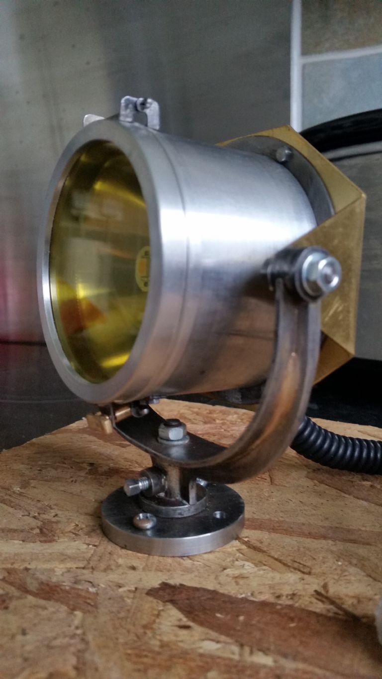

I have just finished a pair of these lamps for my Baldwin 50HP gas mechanical. One sat on the "hood" in front of the chimney and the other hung from the rear underside of the cab roof. The body is turned from solid corrosion resistant aluminium alloy.  The bit of wood was so I could take them to the Work in Progress night without risk of damage.

Nice work Steve...what scale are you working in?

Very tidy, Steve
LED illumination too. yes

Thanks guys.
It is 7.25" gauge which converted from 600mm gauge I make 3.26" to the foot. Not an ideal scale. The LEDs were sourced as filament automotive bulbs will vanish shortly in my opinion and these have a very long life - I bought a spare set too!
The lamp body is 72 of 73mm diameter I can't remember which.

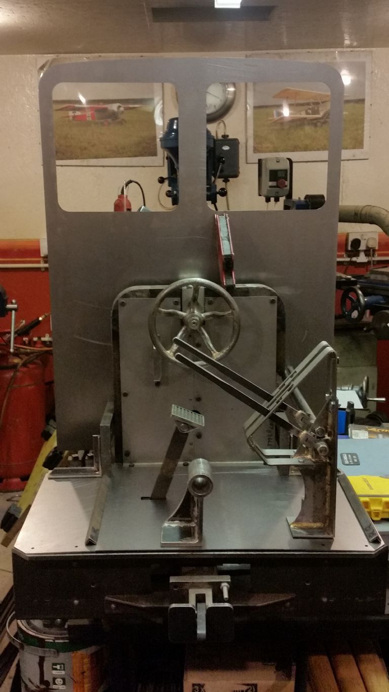

Here is the "office" at the present state of building.

That looks really interesting Steve- I hope you'll post your progress occasionally. That is very much my kind of model engineering!

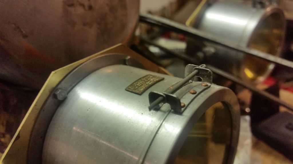

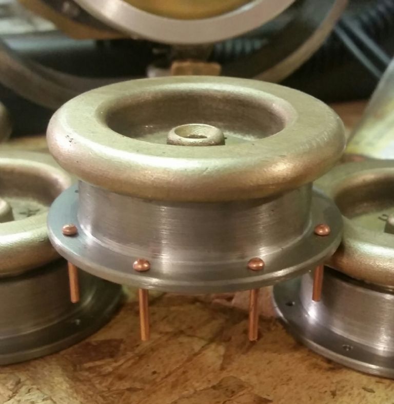

Further to these lamps. I have drawn the manufacturers plates in 3D. These have been printed in wax in New Zealand and investment cast in silicon bronze. The detail level was at the edge of the printing capability. I have made a jig to bend the plates to fit the lamp body. Pictures hopefully in a minute.

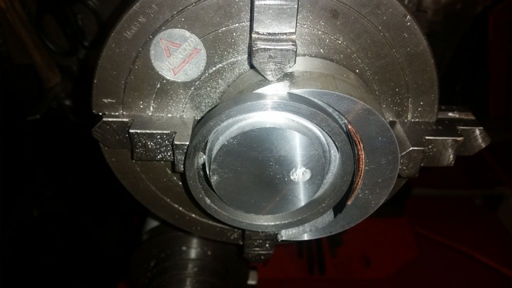

Jig as milled in dividing head, the spindle is actually vertical

Bent plate sits on lamp body

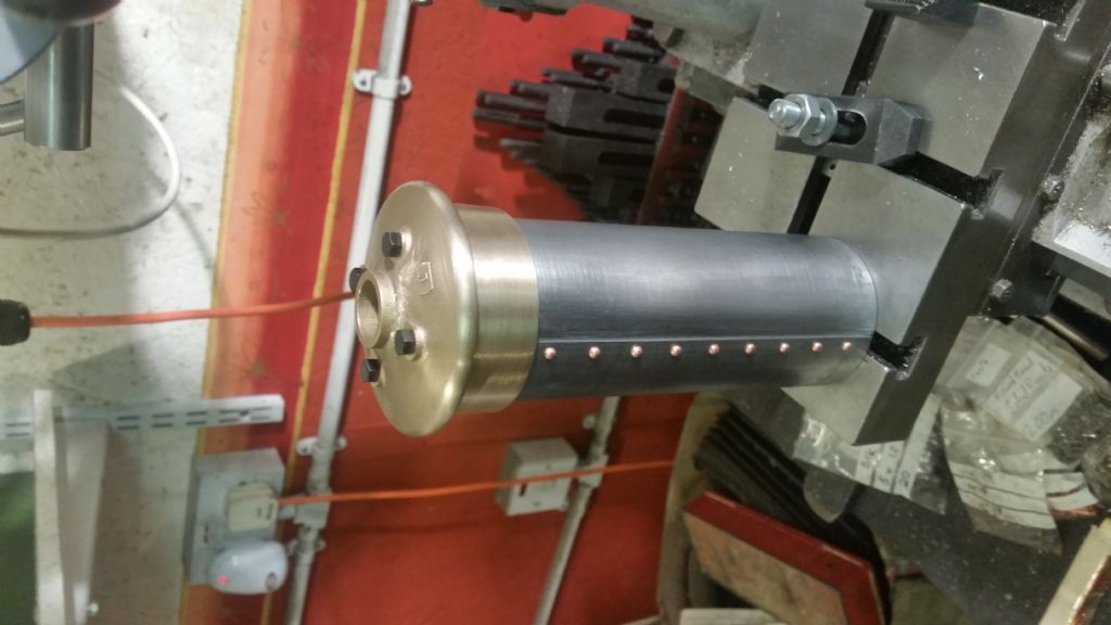

Investment cast chimney top and chimney tube turned from solid 70mm bar

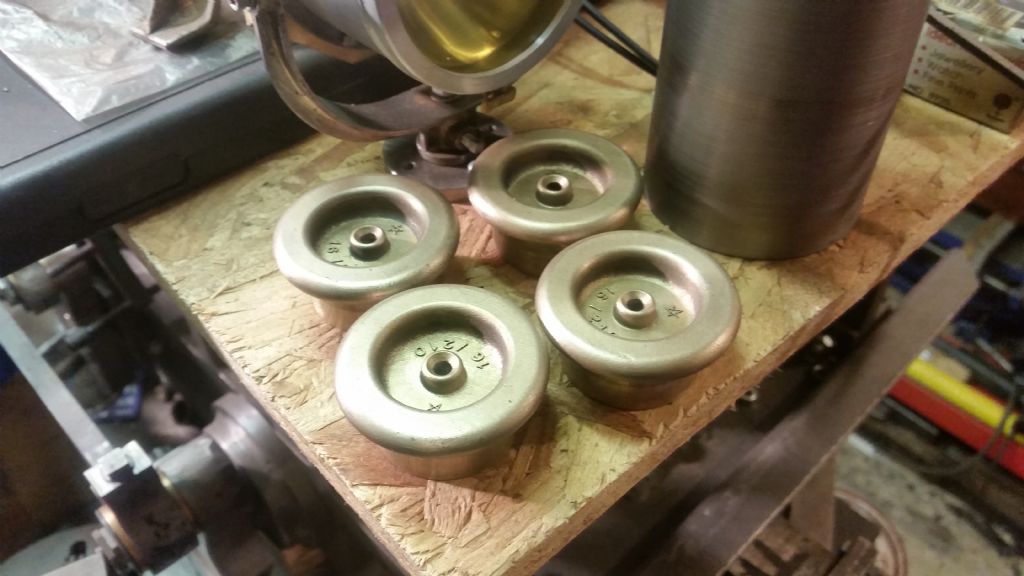

Investment cast silicon bronze sand fillers

Sand filler with turned angle ring, ready to mount on tank/body
A sand filler with angle mounting ring ring

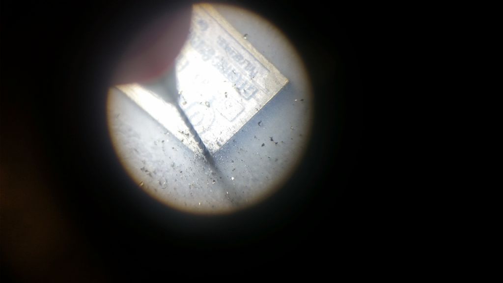

Drilling lamp plates with 0.4mm carbide PCB drill, view through microscope

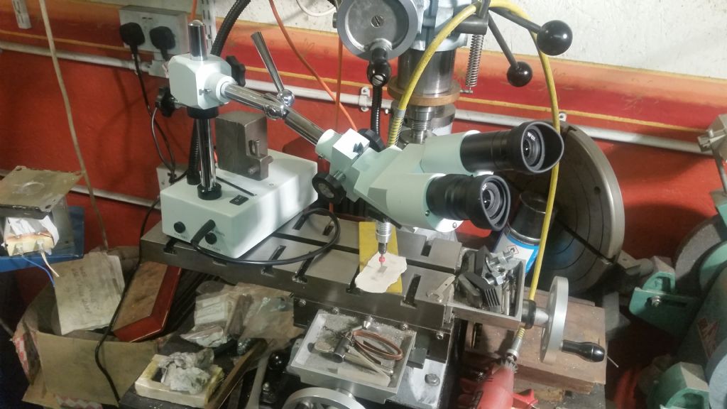

Microscope on Dore Westbury. Drilling spindle is a Proxxon flexible drive held in a drill chuck in a modified tool post holder. You can just about see the plate I was drilling, taped to a bit of card.
