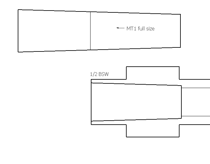

So one has a tiny lathe where the spindle is 1/2" and the thread is 1/2" BSW. Originally it used a MT0 but anything involving MT0 is rare so I was considering putting it to a MT1 socket.
However the whole 1/2" BSW thing means that the taper sticks out 20mm from its usual position. Would this cause problems with the grip of the taper?
I would like to keep the 1/2" BSW because I quite like this little Burnerd chuck I have. In theory I could obtain two spindles but that might be inconvenient. If anyone has an idea for getting a MT1 and 1/2BSW thread to coexist please mention it if the taper can't work on my current plan.

You may be able to get an MT1 reamer and open up the tapered hole a bit more?
You may be able to cut down an MT1 taper to fit and it will still grip. Some of the micro lathes (eg, Optimum) use a cut down Morse taper of about half the usual length.
It depends on what you want to grip. A dead centre would grip ok. A boring head, maybe not so much.
Of course, you could look at drilling and tapping a thread into the end of the morse taper to be inserted and then use a length of threaded bar through the spindle (if it has a through hole?) like a milling machine does, iwth a nut and flat washer on the end..

I put an Mt0 in my 1/2" adept spindle, and I think that is pushing it.
Once you have allowed for the nose thread you have less than 0.4" to play with, so even with an MT0 the wall thickness under the thread is pretty small, MT1 is a non-starter.
Pic below shows original 3/8" spindle compared to MT0 with MT1 in front, bottom shows the wall thickness with an MT0 taper in a 1/2" BSW nose

I worked out that if I had a 40mm long fat nose on the end it would allow me to have a MT1 then I could put a 1/2" BSW ended MT1 arbor on the end but then I lose the use of the lathe gap and I quite like my faceplates. That and it takes almost a 1/3 of my capacity away since its 6" between centres.

Posted by Neil Wyatt on 21/11/2015 12:20:03:
I agree with Neil. No chance even with just part of an MT1 going in. There isn't enough meat there.
About all you could put in the end is an ER8 collet taper and make a nut probably forgetting the self extract feature and tapping them out with a drift down the hole in the spindle.
The spindle nose would probably take up to ER16 but the collet chuck would have to be made, both threads and ends cut in one setting and the collet cone taper added when it's mounted on the spindle.. As there is no register on the spindle nose the thread fit would need to be pretty precise. Really one setting is essential anyway.Threads do tend to self centre under load but it wouldn't be wise to allow too much clearance. The thread angles would need to match. Maybe screw cutting and just cleaning up with a tap and die using a tap that is actually on size and a split adjustable quality die.
At least it's bsw so there may be some old accurate stuff around. New modern taps tend to be oversize. Die's a bit mixed and holder usually bang on size rather than being a bit over so that the die can be opened up a bit.
If you do make one I would be inclined to use leaded free cutting mild steel. Things are less likely to bind together. Cast iron is better in that respect though. Best to buy the nut if you do this.
