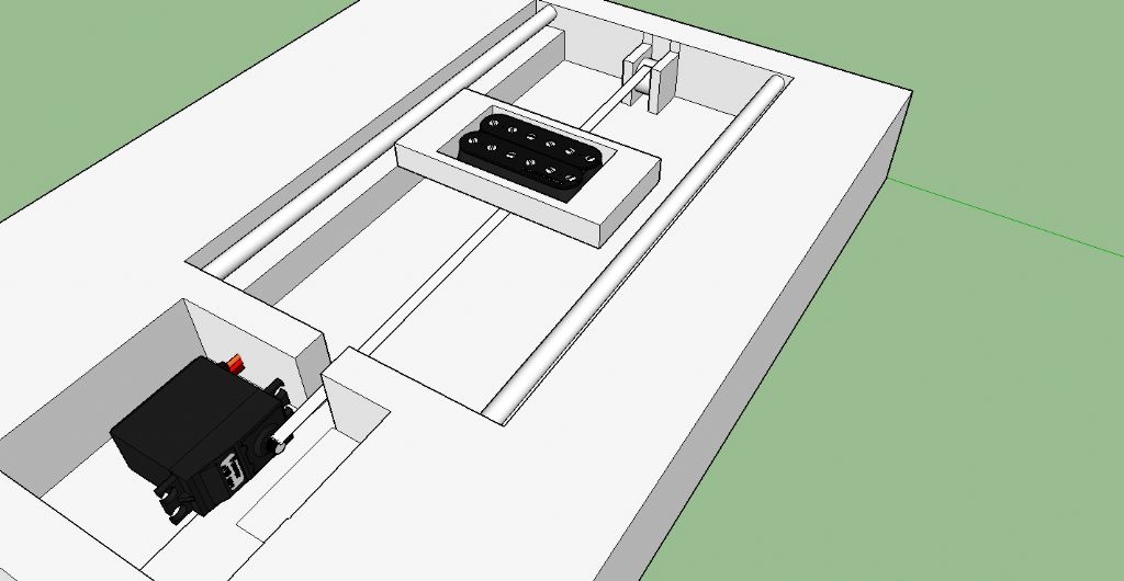

Hi,
I am building a custom guitar and i have a pickup mounted on two sliders (aluminium poles with linear bullbearing bushing). I then have a small pulley mounted one end and the servo mounted at the other with a belt attached to the underneath of the pickup mount. I have attached a quick google sketchup of what i mean.
My question is, the servo is generally quite noisy and i am using is as it has all of the gears built in for the motor to be able to pull the pickup. Is there any alternatives that anyone can think of with less noise?
Thanks

You could do it with a stepper motor which would be quieter but loads more electronics to run it perhaps
Is it part of the design that it has to be motorized? rout a slot in the rear and put a knob on the belt to move it back and forth manually or bring the shaft out to one side and a big knob on there

Is it noisy electrically or mechanically?
If the linear bearings are correctly aligned I would have expected the pickup to move with almost no force. If you need a motor with a gearbox then I supect that there are issues with the mechanics of the pickup arrangement. It would be best to sort those out before moving onto the motor arrangements.

It sounds mechanical, it has lots of grease and runs fine but just cant get rid of the noise plus when it is inside a guitar body the wood amplifies the sound.
The pickup slides perfectly fine with little effort but when i try and use a normal dc motor with no gears to slow it down it simply doesnt move.

Well if you are running under arduino then a stepper motor is easy

You might look into DC gearhead motors. These are available in many levels of quality and sizes vary for ones with practical torque levels from about 6 mm OD to enormous ones 100 mm OD and larger. Good quality very quiet ones are available from Maxon motor but these are pricey. Less costly but slightly noisier ones are available from Jameco Electronics or Solarbotics. Have a google to find them online. I have no connection to any of these firms except as a satisfied customer.

Arduinos are born to run stepper motors!
Just google "arduino stepper"
For an even easier solution use a Polulu board as used to drive the steppers in repraps. I have one running my telescope* drive

I would expect the pickup be to very easy to move just using ones little finger. Lots of grease is not needed, and may well be a hinderance. Ideal would be a little light machine oil, say sewing machine oil.
Is it safe to assume that the pickup doesn't move anything except itself? How fast do you need it to move, and how accurate does placement have to be? Without knowing full details I would have thought that a stepper motor driving through a leadscrew should be fine. Stepper motors generate most torque at low speeds. While the stepper motor drive would be open loop I not sure if there is any need for a closed loop servo system?
The axes on my CNC mill are open loop stepper motor driven and they repeat to better than 0.01mm.

I would use a stepper motor and a toothed belt out of a printer to get speed and reliability. A modest stepper won't need additional gears. You could just transplant the head movement mechanism from an old inkjet printer wholesale.
Out of curiosity, wouldn't you be better having the drive motor at the side, so as to maximise the room for pickup movement without interfering with the neck or bridge?

Yea running from the mains isn't really what im looking for but thanks. I have found this **LINK** which im going to use. Im going to mount the small joystick at the top of the neck so this can be accessed easily and be used easily. Thanks for all your ideas and suggestions. I will post pictures of how i get on.

Have you considered using a threaded rod instead of the belt ?. What sort of linear speed do you need and how many positions does it need to stop in ? A threaded rod may allow the use of a motor without a gearbox.
