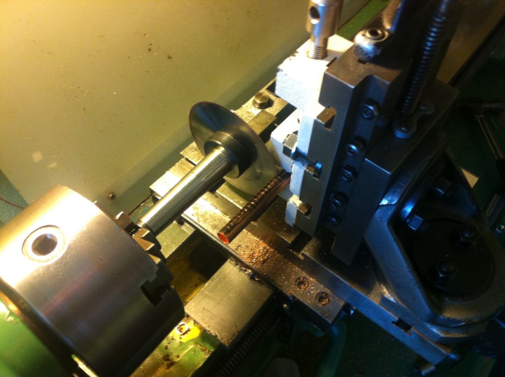

Alex Collins04/04/2015 17:28:57
avatar
147 forum posts
38 photos
Hi All. Got a little more workshop time today.
Made the Burner tube.
My Myford Lathe made this very easy. (8 TPI Lead Screw)
I used a 0.5 mm Slitting saw mounted in the lathe chuck to make the cuts.
3/8 Copper Tube in my vertical slide with a small milling vice.
Set the Lead screw dial to zero, Engage the lead screw and take up the lash.
Line up the first mark, make a 3.5mm cut.
1 full turn on the lead screw and make the 2nd cut. Rinse and repeat until you have all 16 slots.
Deburred the inside with a suitable size drill.

JasonB04/04/2015 19:59:29
avatar
25215 forum posts
3105 photos
1 articles
Making good progress Alex.
Just for future reference its better to remove the chuck and put the tapered saw arbor into the spindles tapered socket. I would say you were lucky this time but on a heavier cut you could come a cropper if just holding on a threaded rod. If its a different tape and won't fit then bringing up the tailstock centre will add support
Alex Collins05/04/2015 08:11:04
avatar
147 forum posts
38 photos
Hi Jason. The taper fits exactly as it should (MT2) in the spindle.
However there is not clearance to make the cuts. The pipe fouls the headstock. A larger (4" saw would resolve this.
I'm aware that this setup is less than ideal and agree that for heavier work this would be unsuitable.
I like your Tailstock idea. Noted for future ref.

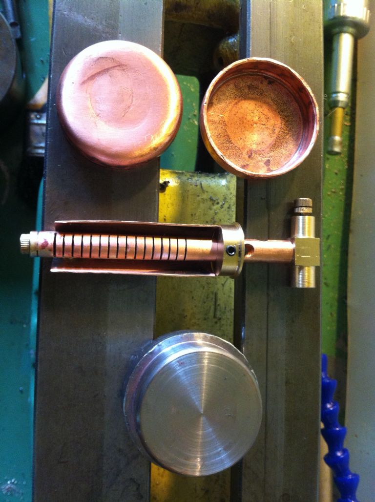

Alex Collins08/04/2015 18:11:23
avatar
147 forum posts
38 photos
Taps n Dies turned up yesterday .
I made a clamp to stop the (now soft from soldering) copper tube from expanding as I threaded it.
Put the Gas Valve back in the 4 jaw. Drilled and tapped the Gas Jet. Tapped the outside to fit the tube.
At the weekend I made the formers for the End Caps and made the 2nd end cap tonight.
All looking rather good.
