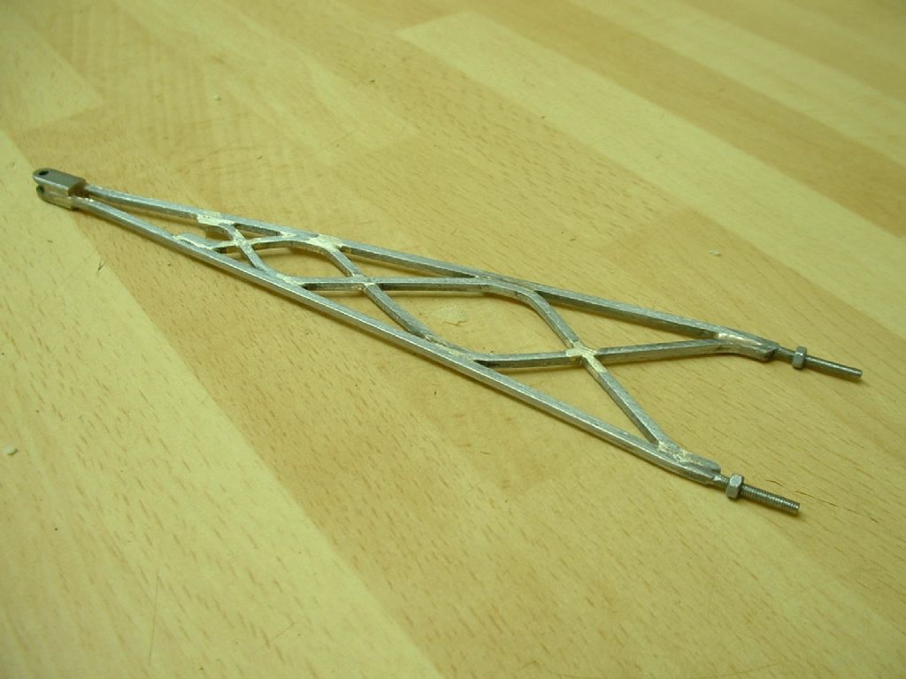

Roland GAGE12/03/2015 00:09:11
avatar
6 forum posts
7 photos
Hello. Has anyone seen a valve lever of "lattice work" which doesn't appear fabricated but is cast. This lattice lever tapers from the cam eccentric to the throttle valve at the base of the cylinder. This is part of what appears to be a vintage model with nice machine work. I can follow with a photo once the moderator approves my album.
Stuart says they are unaware of this variation.
Thanks,
Roland
JasonB12/03/2015 07:26:19
avatar
25215 forum posts
3105 photos
1 articles
Sounds more like the one from "Lady Stephanie" or "Vulcan" though not sure if they are cast or fabricated but definately of the long tapered lattice design.
Pop up a photo and we can have a better stab at it.
Edited By JasonB on 12/03/2015 07:45:05
Neil Wyatt12/03/2015 11:27:24
avatar
19226 forum posts
749 photos
86 articles
Certainly sounds like a Lady Stephanie, but it's fabricated. not cast.
