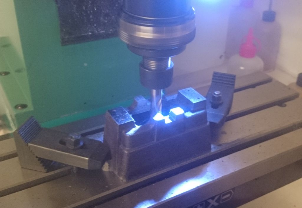

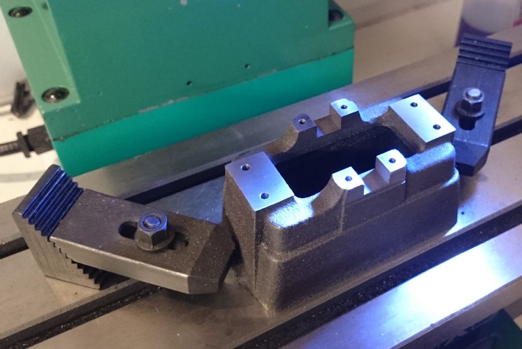

Hi Martin,
I`m working on the 7A at the moment and like yourself I spent a while decided what to use as a reference on the base. In the end I decided to sit the casting on its side and mark it out with a height gauge, adding packing until I was happy that the centre line looked ok. This was then used as the reference for marking out the hole positions. All this marking out was done after the casting had been machined to the correct height.
I clocked up the casting on the mill using the top edge that had previously been machined to height and in the same fixture milled the bearing locating features and the pilot holes for the threads. Machining all these features without re-jigging the casting should mean that everything aligns ok even if they arnt perfectly in the middle.
I had clamps on the upper faces when milling the channels but these were removed to drill the holes.
Mike
