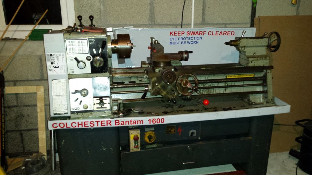

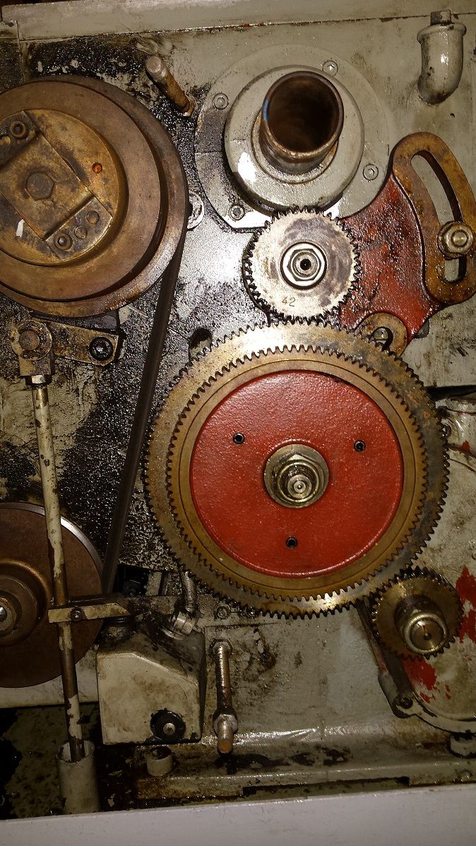

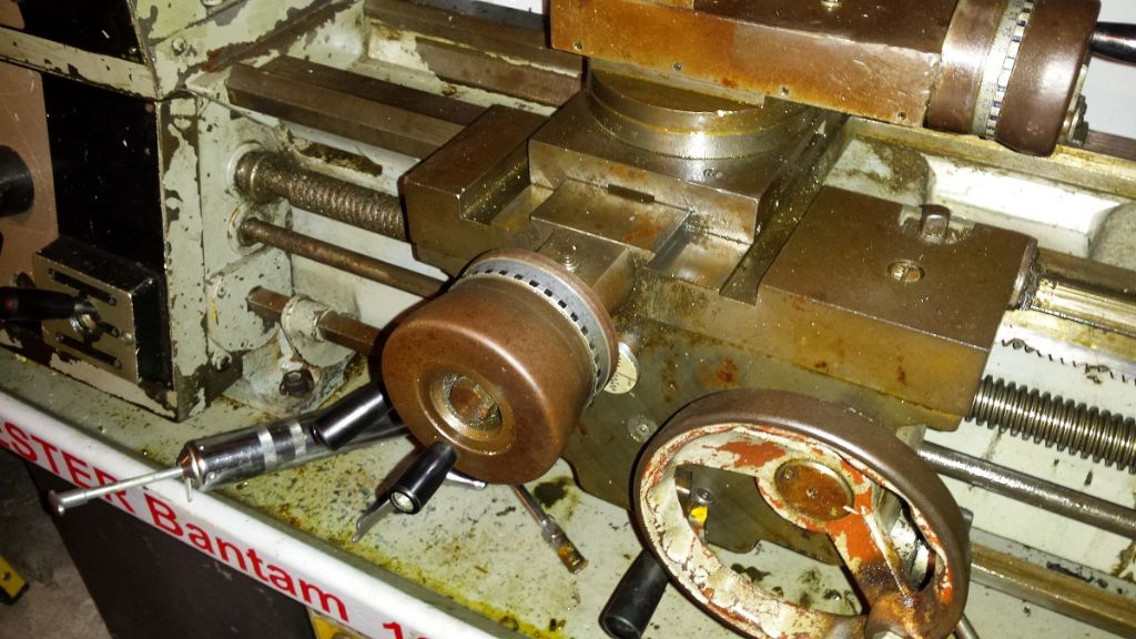

glinner 8114/02/2015 19:44:33
6 forum posts
6 photos
hi all,
here are some pics of my bantam :-
Muzzer14/02/2015 21:07:21
avatar
2904 forum posts
448 photos
Definitely a Bantam! The MkII is little more than a superficial facelift over the MkI, so mechanically almost identical.
Check that the forward / reverse gear selector between the spindle and the 42t gear is properly engaged in one direction or the other. And the shear pin Rex mentions is fitted behind the 42t gear (remove the nut). The 42t gear should turn at the same speed as the spindle in either direction.
If the gearbox input is turning, make sure both the 3 position and 6 selectors are fully engaged. You can change positions with the machine running slowly (<2-300rpm) and they can be a bit notchy. Can't imagine the gearbox is actually broken, so you should be able to sort this out easily enough. Famous last words.
BTW, the gearbox(es) and slides are lubricated with ISO 32 hydraulic oil which you can buy easily and cheaply from motor spares shops. They don't sell the recommended Telus oil any more but this is the modern equivalent.
Nick_G14/02/2015 21:38:58
avatar
1808 forum posts
744 photos
Looking at the change wheel photograph it is very similar to my Boxford STS (as many, many other lathes) When I first got mine one of the first things I did was crash it in a right royal fashion. blush
I thought I had goosed it in an equally royal way. - The change wheels were turning but no drive was coming out of the gearbox. I went to bed convinced I had rendered the gearbox 'fubar' !!!
The morning brought a clear mind and I discovered that part of the splines that the gears sit on was a brass 4mm sheer pin. This had done it's job and sheered. So it gave the impression it was turning the gearbox when in reality it had protected it's self from a clumbsey twonk ................... i.e. me.!! wink
I am wondering if your Bantam has a similar arrangement of sheer pins somewhere as mentioned by others. Mine are behind the splines so you cannot actually see them until you take it apart.

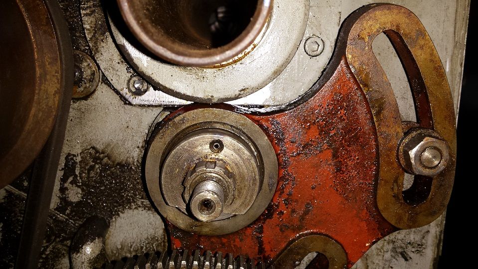

glinner 8120/02/2015 10:48:50
6 forum posts
6 photos
hi all, so i got a spare hour yday (time is precious with 2 kids under 10 and full time job!)
i removed the top gear - which came away without too much hassle. the splined sleeve is a completely different matter. it will not come away. i modified a bearing pullers and i got maybe 1mm of movement but there was a lot of pressure on the pullers. i wasnt sure if this was normal so i didnt force it anymore.
can anyone who may have removed one before say if this is normal or should i apply enough force to pull it off?
i have attached a pic with the top gear off. you can see the top of the shear pin clearly.
Ian Parkin20/02/2015 11:10:28
avatar
1174 forum posts
303 photos
If you turn the chuck by hand the shaft should turn ( the part with the thread on) when the lever at the front is set to forwards or reverse there is a neutral position in between
If the shaft turns but the spline doesnt the the shear pin is broken
If the shaft doesnt turn then its inside the gearbox or the selecter mechanism thats failing to engage
But the splined sleeve should pull off but no need to unless the shaft is turning but the sleeve isnt
Rex Hanman20/02/2015 14:15:30
121 forum posts
3 photos
Not wishing to harp on about this but both of you photos of the lathe show the 6 position joystick in the upward position but central. It must be pushed either to the left or the right. If you have since done this then apologies for repeating myself. thinking
Muzzer20/02/2015 14:18:54
avatar
2904 forum posts
448 photos
As Ian says, without the shear pin the splined carrier should spin freely on the shaft and pull off easily. If the threaded shaft doesn't turn with the main spindle, there's no drive getting there through the gearbox.
First of all - is the forward / reverse selector properly and fully engaged in one direction of the other? This whole thing could simply be due to you not having engaged it fully. If that isn't the problem, it sounds as if your gearbox is bu99ered. The US Clausing manual mentioned by Breva in the thread above may help you to investigate further within the gearbox. It's not something I've needed to delve in to myself.
Murray
