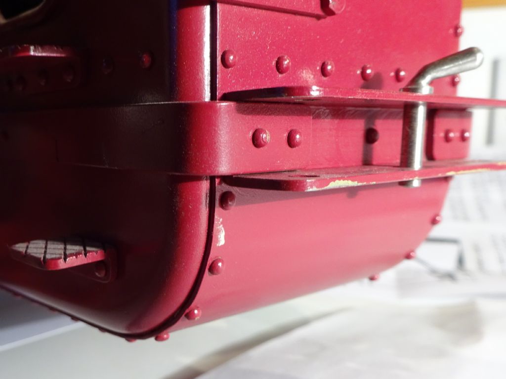

Thanks Jason,
just wanted so see how you had bent the draw strap round the corner into the draw bar.
i've done mine the same.
