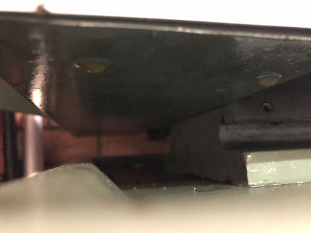

Apologies, I may have the terminology wrong here, but I'll do my best The GH600 has a single powered shaft / leadscrew. For threading, the half-nut engages with the thread on the leadscrew to drive the carriage. For power-feed, there is a long slot milled in the lead-screw, which a key engages with.
The apron is easy to remove - I had to tackle that when fixing the saddle lock. From memory there are 4 bolts that go through the the top of the apron - remove those (and have some support underneath the apron so it doesn't drop on the floor) and you're done.
edit : this photo shows two of the blots. The top right of the three bolts (removed in this photo) is for the saddle lock. The other two secure the apron. There are a matching pair on the other end.
Jed

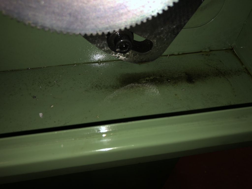

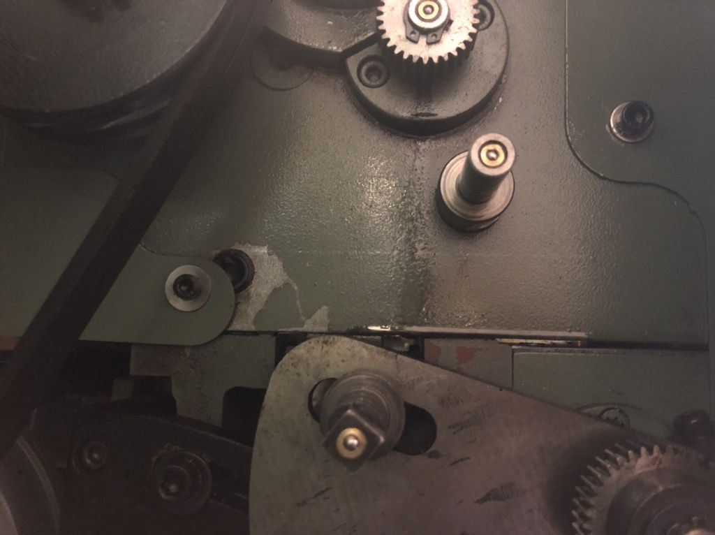

Prompted by Triumphboy, I've taken the left-hand panel off to have a closer look for leaks. Since I'm new to this, and the machine is often covered in chips and cutting oil, it's possible that I've missed some. There is some evidence that a bit of oil has collected at the front left of the chip tray, but it isn't obvious where it might have come from. I think I'll top everything up and run the machine for a bit to see what happens.
Clearly I don't have a leak issue like Triumphboy though, I think that would have jumped out.
Diy Addict, by the nature of forums, all you're going to find in this thread is people discussing issues. It certainly doesn't represent the hundreds of hours I've spent making stuff with this machine. I really enjoy using it, and I'm glad I bought it.
