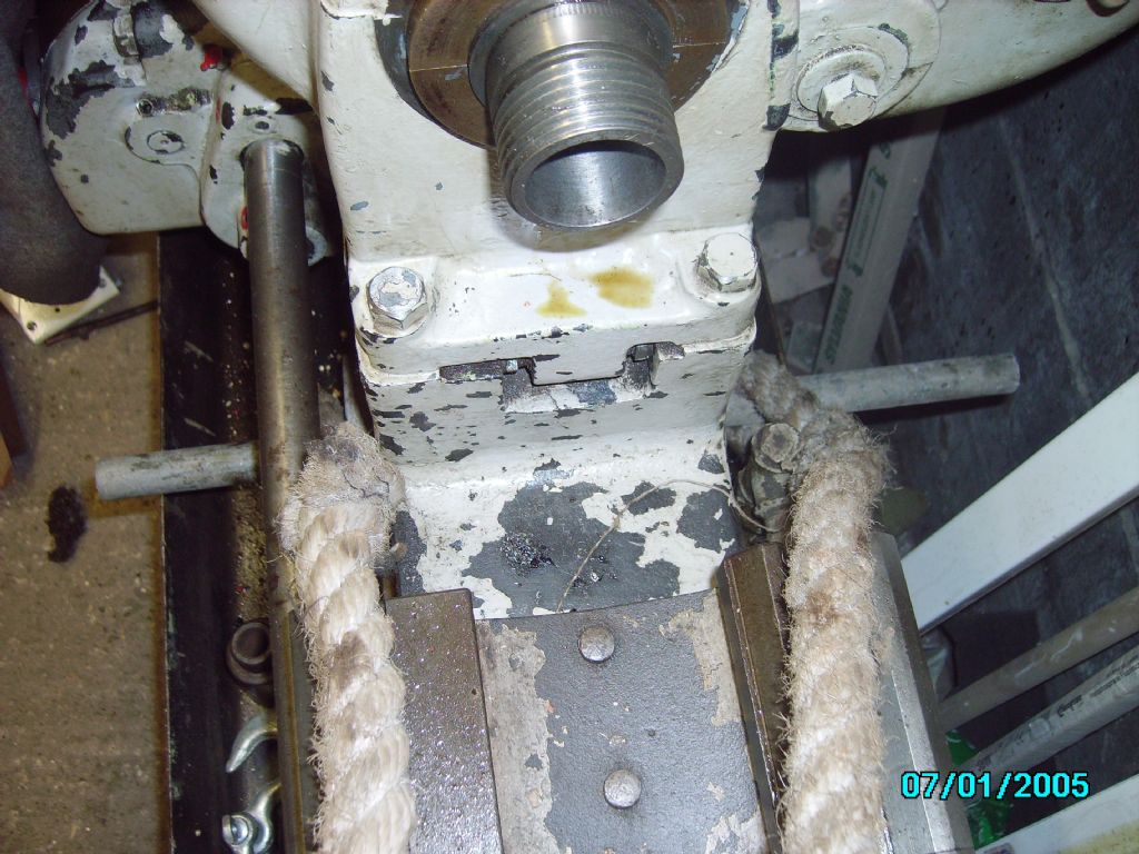

Evening all, I have been taking pics again, first the carriage lock, tighten it down once you have closed the half nuts.
then I got my best rope strop and mocked up how I would lift the bed once the headstock was off
and finnally the lifting point, putting the hook of the crane where the shackle is, just above the tool post.
you can then try a lift to see if it is balanced and move the carriage either way to achieve this, then lock it .
My order of the day would be;
Put the leg bolts back on, or when you try to lift the headstock it will lift the whole lathe if the headstock is stuck with paint.
Remove the headstock, pallet it and trundle it away.
free the legs from the concrete.
Try a lift on the bed, get it balanced and lift the bed just clear of the legs. (now it geta "hairy"
take out the legs and place the bed pallet over the legs of the engine crane, blocked up on timber baulks so the crane is not trapped under the pallet.
Lower the bed to the pallet and strap it down.
If you need to go out of a doorway to exit the shed, use the crane one end at a time to remove the baulks and lower pallet and bed onto rollers.
once outside you can pick it up again and place it across the engine crane legs, leaving some weight on the crane, and trundle over the plywood sheets to the road.
If you do it this way, you will not have to move the engine crane with the bed at height (ie to clear the legs) which is very risky.
Having said all this, moving lathes at 300 miles range is easy, it is easy to not appreciate the full magnitude of problems you may have to deal with, you will be there, unfortunately, I will not. I am now seroiusly considering moving my covmac in bits, because I have to get it through a doorway, and I don't know if I have sufficient room to turn it round. with the legs on. What do you think to the above Brian?

I like the idea of not having to lift the lathe higher than it is, but just to lower it. The three point fixing looks sterling.
Where can I buy a rope like yours, Phil, strong enough to lift it?
Chains are horrendously expensive, and look like capable of easily damaging the lathe.

I would use slings rathey than rope, something like these,
http://www.recovery-equipment.co.uk/strops-slings-lifting-double-single-simplex-duplex/strops-slings-lifting-double-single-simplex-duplex/269/d2000kg-4m-strop.html
They don't stretch or twist like rope does. The rope was for "illustration purposes only) I don't like rope for lifting heavy stuff, much prefer strops/slings, or chains.

Hi Chris, I trust that you are not going to use the shakle on the rope as the pic suggests, Get two slings and put the eyes on the ends on thee hook of the lift, the way you have it the rope is very likely to slip if the load is not evenly balanced, looking at the machine I get the impression that it is going to be heavier at the headstock end you would be much better with slings, these are available in various lengths and it may be easier to have two of different lengths in order to balance it better.
A engineer supply company would be your best bet to obtain them and if you grovel you might be able to return them if they have not been used, check it out first, they may have skates for hire if your lucky.I used to remove and re-install ali extrusion presses which are a little bit heavier but the basic peinciples are the same, just take it slowly.
Neville.

Many thanks; the overall vote is for sling ties. Phil was demonstrating positioning with the rope. I can see how important it is to have the lathe held very tightly on the initial lift.
The more I looked at chains the more I found it hard to imagine protecting the lathe from them.
Chris.
neville rigg 101/10/2014 06:08:48
24 forum posts
Chris, the trouble with chains is there is no warning before they go, I would never use them on any machinery, O.K. for steelwork and pipework.
Neville.
