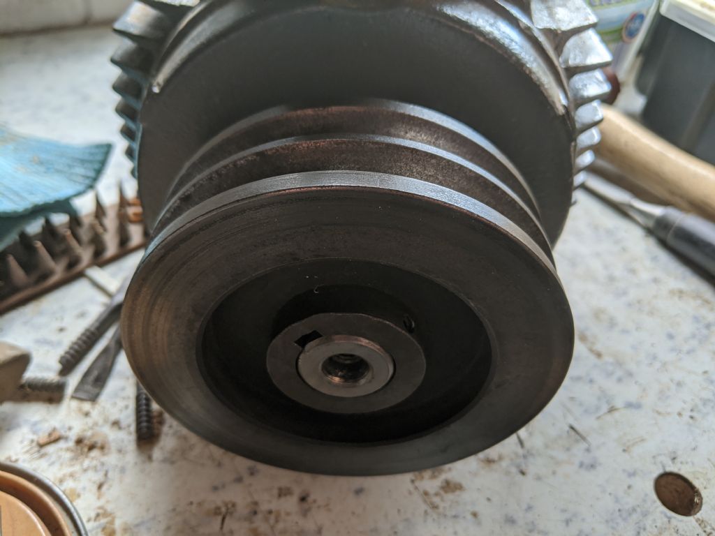

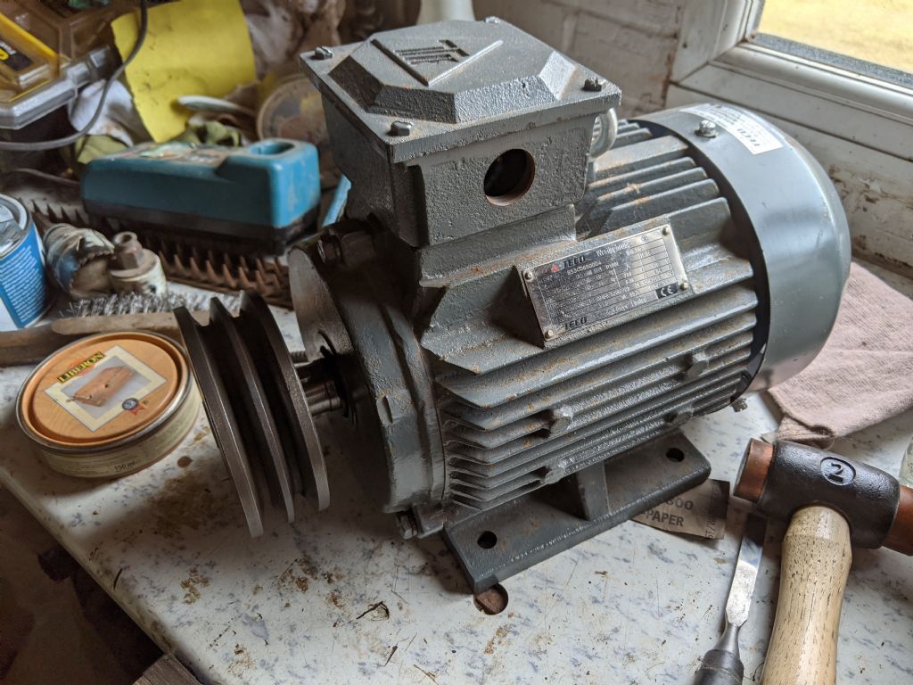

Just got back today, test fitted motor pulley onto new motor since machining.
When the pulley cooled down to the ambient temp of the garage, it slipped on perfectly, and more importantly, it will still come off with a little pressure.
I'll look at finishing the contactor and modifying the motor mounting plate next. Still making progress on getting the three phase fitted back in

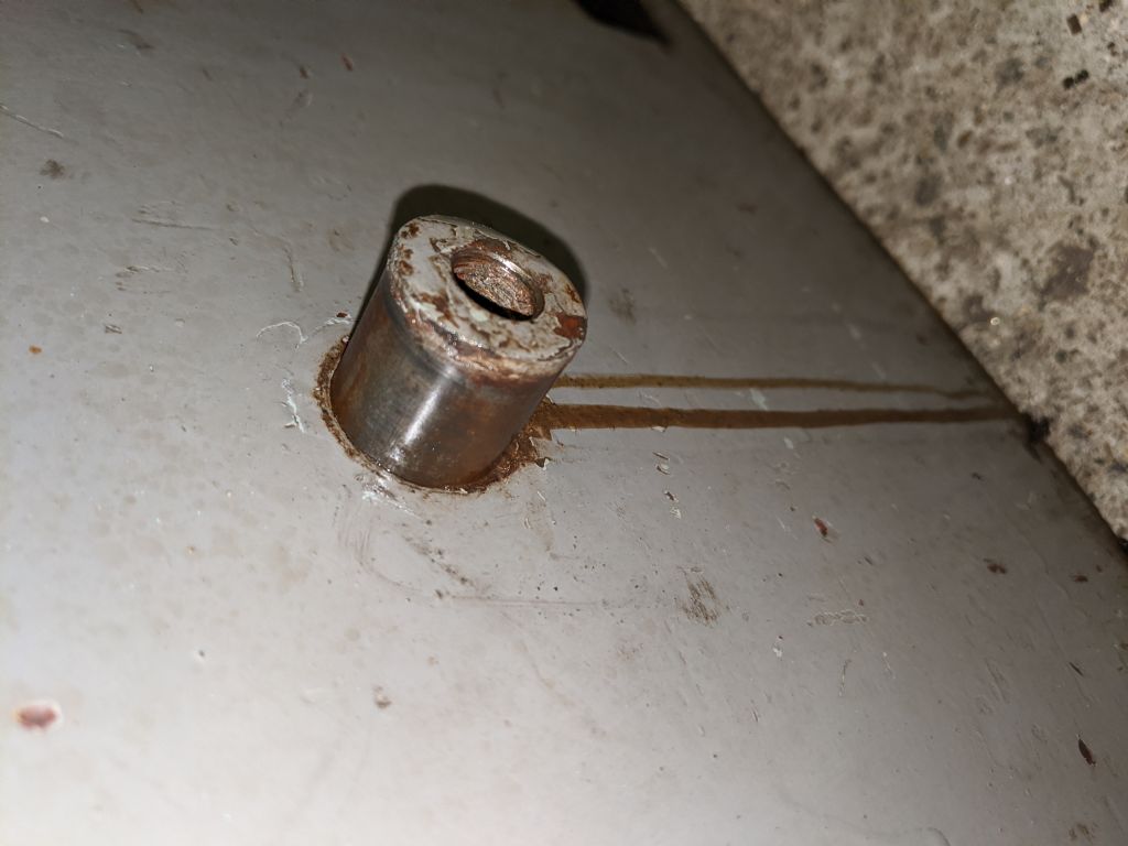

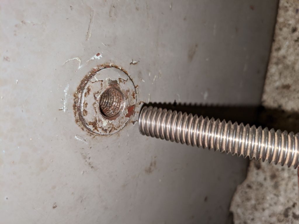

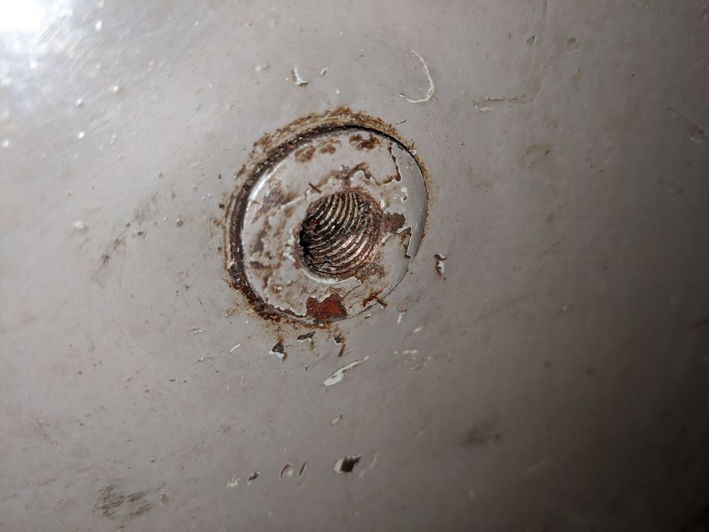

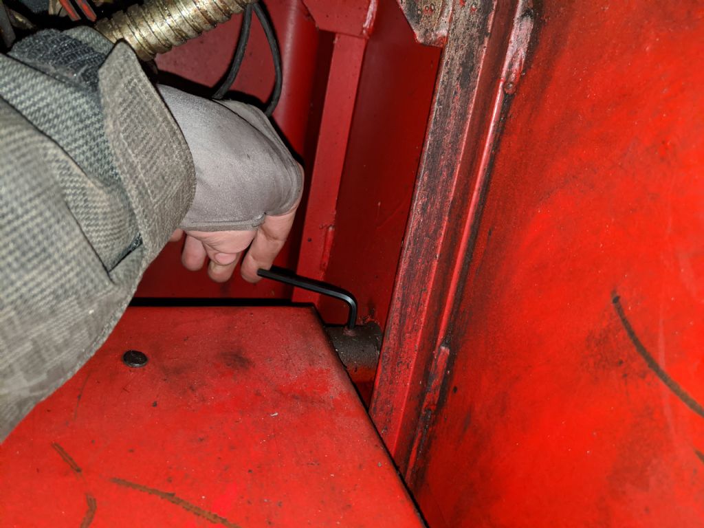

Anyway, it's all tidy now, so I started looking at how to remove the plate that the motor attaches and hinges on. There seem to be two set screws holding the shaft that the plate rotates on in place, then there's a hole in the end with a thread which I presume a bolt is meant to go into to provide a way of pulling the shaft out as its only accessible from one side. The manual doesn't show any of this, and in the later manual it shows a different way of being secured.
So the hole is half inch from what i can see, but a half inch threaded bolt does not fit.
Probably just got the thread wrong, but any thoughts?
My wiring friend wants to keep a low profile so it'll be a few weeks before we get the contactor finished. Plenty to work on meanwhile,
Pitch seems too course? Imperial threads aren't my forte

That stud you are holding looks like Whitworth, try a BSF bolt, A lot of the fixings on mine are BSF. This is where you need boxes of assorted old nuts and bolts so you can find a fit, and then measure it with a pitch guage, measuring an external thread is a lot easier than an internal. 1/2" BSF is 16 TPI.

The majority of threads on my 1963 Chipmaster are Unified, mostly UNC.
Phil Whitley22/03/2020 16:20:34
avatar
1533 forum posts
147 photos
Good point Stuart! So if it is UNF it will be 20TPI and UNC would be 13TPI, so if Richard can count the number of threads in an inch, he has it!

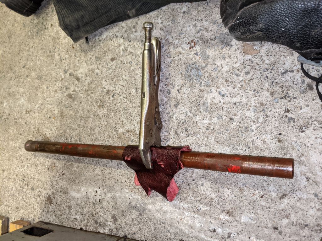

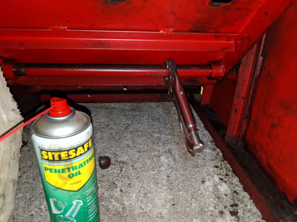

I managed to completely avoid the thread. It seems the thread was meant to be used to pull the shaft out, but I did it another way.
I put lots of penetrating oil down the grub screw holes, then I attached some vice grips to the underside of the shaft, slowly starting to wiggle it bar. It took about half an hour or so, but I managed to wiggle it out eventually

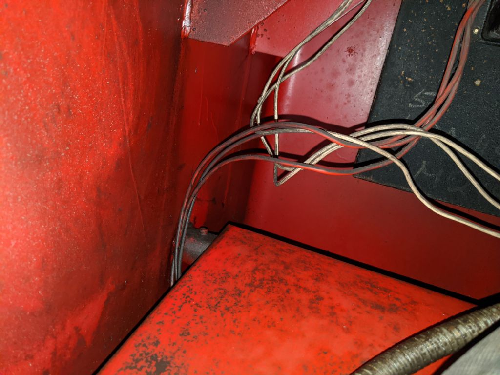

So, the next task is to redo the gaskets and sort out the contactor. I need a little help figuring out the contactor since I'm not sure where the wires need to go
So, from Phils lathes wiring, I understand I need the three blue cables coming from the switch to go into the L1 L2 and L3 at the top of the contactor.
The yellow needs to go into the top of the contactor, then the red and blue somewhere else? Which ones do they need to go in?
Also, which ones do the cables to the motor go in. Do they go into the lowest 3 at the bottom, or the other 4 on the relay?
Looks like we're on lockdown now, So I may as well get it all done!
Thanks
Edited By Richard Kirkman 1 on 23/03/2020 21:18:53
Phil Whitley24/03/2020 13:19:41
avatar
1533 forum posts
147 photos
Hi Richard, very neat work in the motor plate, I have done this job many times, and how easy it is is in direct proportion to how heavy the motor is, and how well you can get in to the job! It is NEVER easy!
The three blue wires from the rotary switch go to L1 L2 and L3 on the top of the contactor. 13 NO (normally open) and 14 NO are the holding in contacts which operate the no volt release. the three wires to the motor connect to the A b and C connections on the overload. Did you get a wiring diagram with the contactor? if so, can you scan it and email or post up a copy and I can do a diagram for you.
Phil.

Have you linked the blue wire to the terminal above in the limit switch! See the diagram I did for you.
Phil
Richard Kirkman 124/03/2020 14:24:36
334 forum posts
799 photos
The blue yellow and red are all connected to the limit switch in the same locations as your lathe from the pictures you sent at the bottom of page 2 on this thread
Phil Whitley24/03/2020 14:42:04
avatar
1533 forum posts
147 photos
Yes, that is correct, but you also need a link wire from the blue wire terminal to the spare terminal on the switch, which is not visible in the pic. I have checked the wiring diagram, and it does show it. but it is not obvious on the pics. Look on the diagram in your manual.
