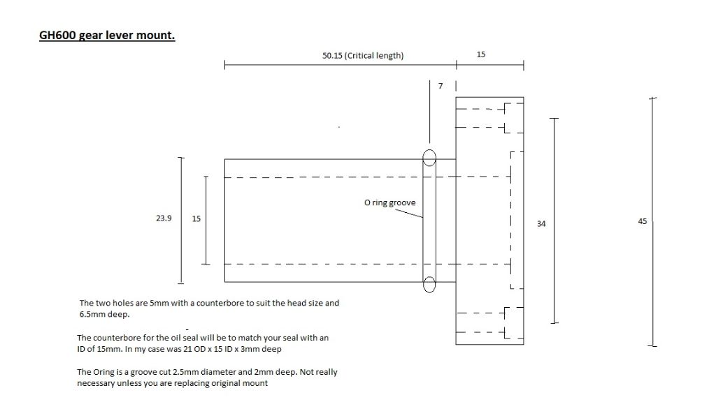

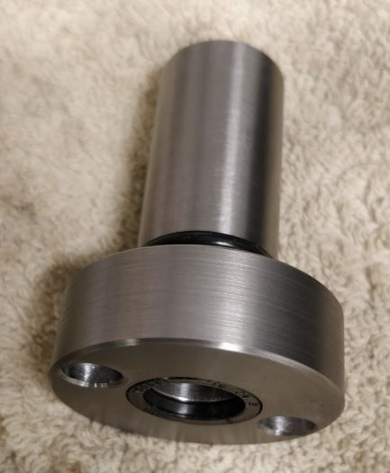

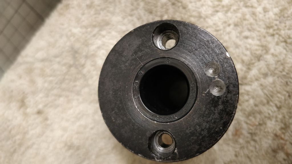

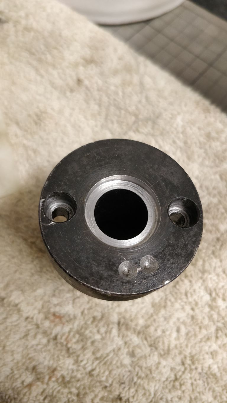

GH600 Lathe Oil Leak Repair
After my previous rambles about oil leaks, I finally completed the detection, thought process and solution for this, the largest of the leaks.
I have produced a PDF document explaining the process I used to sort out this oil leak. I tried to attach it here but I couldn't figure out if you could or couldn't add attachments.
If anyone is interested, I can email it to you and if you decide you want to go ahead, I can post the replacement lever mount that needs fitting to allow you to modify your unit, as a loan unit while you machine yours.
All of this took many hours and became a project that I / we shouldn't have to do but there you go!
Hopefully, these steps will provide help to someone that identifies the same issue on their machine.
The O ring prevents a bit of the leakage but most of the oil was coming out of the lever hence the oil seal.
All the dimensions are in the PDF.
Note:- The O ring is a 2.5mm cross section 19mm ID (Slightly stretched) and the front Oil seal is 21mm OD x 15mm ID x 3mm thick.
Best regards and good luck. Triumphboy. J

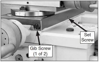

Has anyone modified their GH600 to lock the cross-slide yet?

I have been looking through Grizzly lathe manuals seeking better instructions than the Warco manual and came across a cross slide lock screw on a similar looking setup. It is the usual format of gib strip lock screw.
cross slide lock example

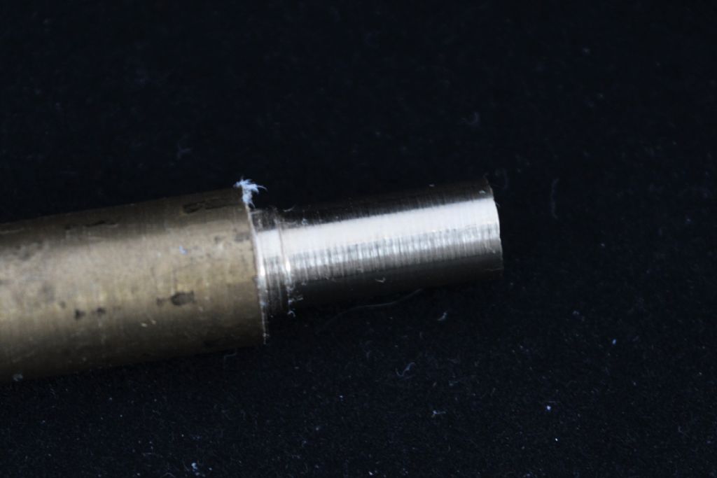

I have had my GH600 two months now and still have a few teething issues to get through as i haven't had much time to fiddle yet.

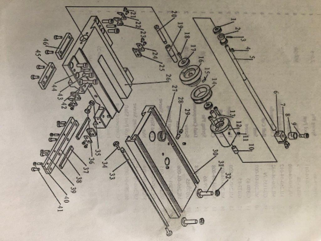

One problem i have is with surface finish. So far i haven't managed to eliminate the rough finish shown here (its worse than it looks when you run your nail over it and feels like a fine thread):
Brass Test
I have made the following checks:
  1. Tool height - tried it bang on centre and 0.4mm below, same outcome
  2. Tool overhang - absolute minimum
  3. Speed/feed - tested speeds from 500-1500rpm with no improvement, feed rate 0.044mm
  4. Cut depth - 0.05mm to 0.2mm, same results.
I'm using an insert tool with a fresh edge, it is a TPMR 110304.
I have reset all of the gib strip, i would say that i have the top slide too tight, the cross slide perfect and maybe an issue with the saddle.
I have set the gib strip at the rear of the saddle and snugged it up quite a bit from the factory setting. I tested with a DTI on the top of the saddle to see if there was any lift and measured 0.01mm. Should i attempt to tighten this gib further?
If i move the DTI and test the saddle at the front i can measure 0.025mm of lift but don't see anyway to adjust this? Here is a diagram, it would be parts 45 and 46 that would need to be adjusted. Is this normal?
saddle diagram
My other thought was spindle preload so with a DTI on the top of the register flange and a large drill for leverage I measured 0.01mm of lift. I could equally measure a further 0.01mm in the downwards direction from neutral so i'm not sure if it is deflection rather than bearing clearance. Again does this sound OK or is the movement excessive? I didn't expect any movement so close to the bearing.
Any advice on what to try next or where I'm going wrong would be appreciated.
Incidentally parting off has been a terrible experience so far and i suspect connected to the surface finish issue.
Kind regards
Dan
Martin Connelly05/06/2020 17:57:32
avatar
2549 forum posts
235 photos
Feed rate seems very low. Using an insert you need to make it work and not rub. Try a feed of 0.125mm/rev. For small cuts the depth of cut should be similar to or below the radius of the insert but not too small. These inserts have 0.4mm radius so try 0.2mm DOC. Tools should be on centre height. RPM depends on the diameter of the stock. If the diameter of the stock is 10mm then try 1500 RPM if that is the fastest your lathe goes. Bigger diameter reduce RPM eg 20mm (double 10mm) half the RPM.
There is a thread that is accessed from the home page under workshop/processes I think regarding speeds and feeds.
Martin C
