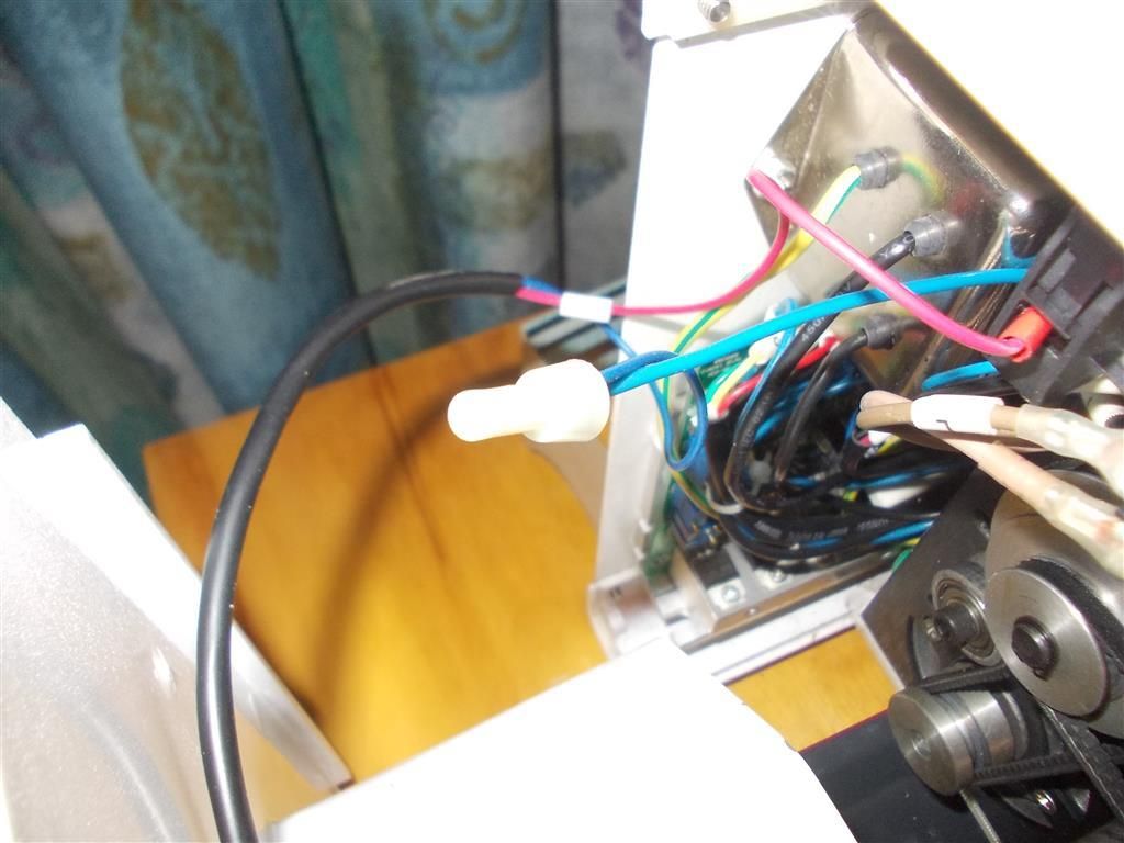

I opened up the case to have a look inside. The micro switch on the door (photo 1) did not seem to be lining up correctly. I made adjustments to this but it did not help. (The magnets are not very powerful in these micro switches.) You can see the other micro switch in photo 2 (black box with two nuts which is controlled by the chuck guard shaft. The shaft is to the left in the photo. I have not attempted to fiddle with this yet.
What is that thing in photo 3...connecting two loose ends ?

if you mean the white 'top hat' with two blue wires - it is a twist on connector (usually these are very stable)- I'd check (a v gentle tug) whether the red wire (ie live connector) from the lead is sitting properly in what seems to be a terminal block (or is it a fuse block?) ETA the item you state is the microswitch in photo 2 looks very unusual to me to be such but I don't have a manual in front of me - I'd normally just expect 2 wires to be connected to such a switch

Not to me - a reed switch (at least from my 40+ yrs in electronics/telecomns etc is a linear glass envelope containingg 2 leaves that make contact under an applied magnetc field - this appears to be some form of rotary switch presumeably other side is the arm supporting the guard - the two positions reflect up or down of guard and I guess the signal wires (blue + yellow) control the motor + possible breaking of drive current + ?brakeing of chuck
I'm reluctant to make any further suggestions re using a meter on live wires not knowing the background + technical experience of the owner)

OK I'll ask the obvious - has the emergency stop switch been pushed (maybe by accident). You reset that by twisting the red knob which will then pop-up slightly resetting the contacts inside allowing current to flow. Very obvious when you know what to look for but can be bafflling if you're new to the game - and just by looking at the knob not always clear that it is depressed.

Must admit I wonder if Keith's suggestion (obvious to any who use machinery with such buttons) might well be the answer - otherwise
I assume there is no pilot light on the lathe control housing (can't see one indicated in parts list) - thus assuming no bang/smoke occured when re-switched on the obvious check points are
0: is the mains plug fully home in the mains outlet (its 40 yrs since I was in Aus with its own angled connectors and can't recall if their plugs are non-fused) - also I presume by plugging in another appliance you have checked the mains outlet
1: is the belt cover fully home (easily forgotten)
2: is the chuck guard reseated properly
3: is the 10A fuse in power supply intact (tho if no bang etc then why would it blow
4: some other connection to control board has become dislodged due to movement of lathe
must admit looks very pretty but you may well be right best suited to machining plastic + Aluminium - though i/p power of 450W would suggest a 250W motor at least but MT1 tapers will somewhat restrict options + size of drill chucks, addons such as die holders etc.

If the lathe has been turned over and the electrics not disturbed that sort of thing must be well worth checking before getting too excited about the fantastic range of possibilities including it's just decided to break.
Looking at the wiring diagram the main isolation seems to be via a no volts release switch or relay, probably as switch. The ones on the motor are fwd/rev plus a reverse speed reduction setting as brushed motors don't like being reversed after the brushes have worn in.
The other switches are simply looped so break the circuit with one and the machine will stop. This includes the emergency stop and the "safety" trips. I believe the stop switch should completely isolate the machine but it clearly can't if the live and neutral were miss wired as that needs 2 poles. I'd guess it might fail TUV approval due to that. The nvr does do what it should - break both.
What I would do is to use a meter to find out what volts are on them or simply forget that, disconnect from the mains and short the wires going to the ones that aren't wanted. Trouble is that safety ones are shown normally open and the stop switch normally closed which doesn't make much sense at all so it would be best to check what state they are in with a meter / dvm while the machine is operable. I suspect they will be found to be normally closed when the chuck guard and door are closed. If there is a magnet in the part that uses the odd looking switch it is very likely to be a reed switch. If electronics is involved maybe not. It might be a simple micro switch and have a short pip sticking out of it that contacts a guard. Can't see from the photo.
I suppose showing them normally open is ok as they are - until the guards are close.

the safety microswitches are correctly drawn as the open state is their default without any actuating force (ie the magnetic field) applied - likewise the safety switch is in default state as fully home prior to depression of button.
One 'easy' way to check + bypass microswitches is to tape small button magnets close to the reed switch (you should in a quiet room hear the slight click as the leaves come together - if a mechnical microswitch tape a small nut over top (again should hear a click as switch operates)
Michael - yes I mis understood the ref - the chuck microswitch is I think the out of focus block at right - what I was looking at must be rear of speed pot
