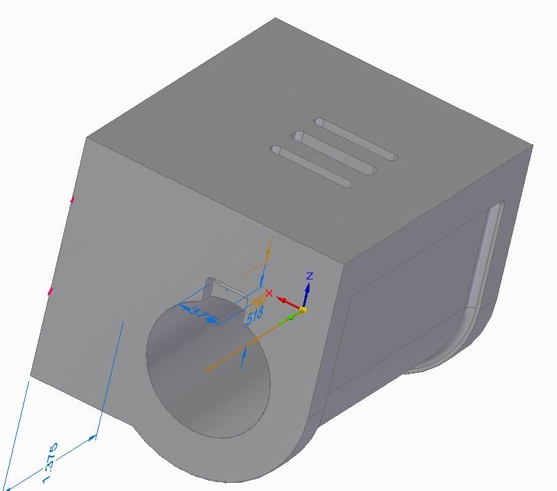

duncan webster24/04/2022 00:23:08
5307 forum posts
83 photos
Progress at last, thank the Lord for tutorials on UTube. I realised my first attempt hadn't started off correctly, so started again. I've just realised that I've drawn it 3/8" too long, but as it is a learning exercise it doesn't matter. trying to change it using smart dimension seems to move the wrong end. A job for tomorrow, as is working out how to not have those pesky dimensions all over the place
GordonH24/04/2022 07:16:05
64 forum posts
5 photos
Duncan ,
When you select a dimension which you wish to change, usually the dimension value will appear in a pop up window, below the value there will be three arrowheads, left, double and right. The highlighted (red) one indicates the direction in which the change will be made. Clicking one of these arrowheads will select the appropriate direction. Also, the head(s) of the dimension line on the sketch will match the colours of the pop up ones. In practice, clicking the dimension line nearer the end you wish to change usually selects that direction in the pop up.
Gordon

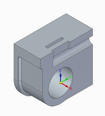

SillyOldDuffer24/04/2022 09:35:39
10668 forum posts
2415 photos
Posted by duncan webster on 24/04/2022 00:23:08:
..... A job for tomorrow, as is working out how to not have those pesky dimensions all over the place
Not sure this is the best or only way, but dimensions can be toggled by ticking the PMI box at the top of the part tree:
Your steam cylinder looks like an interesting challenge. Ports and internal passages, I might have a go...
Yesterday's session with Solid Edge went moderately well, except the mechanism I was modelling stopped working at the very end. We might both be guilty of tackling advanced subjects before being suitably up to speed with the basics.

SillyOldDuffer24/04/2022 13:16:48
10668 forum posts
2415 photos
Similar to Duncan's steam cylinder in Solid Edge. Second attempt - I couldn't alter the depth of a cutout that overlapped with a second, or delete it. Fixed by starting a new model from scratch.
