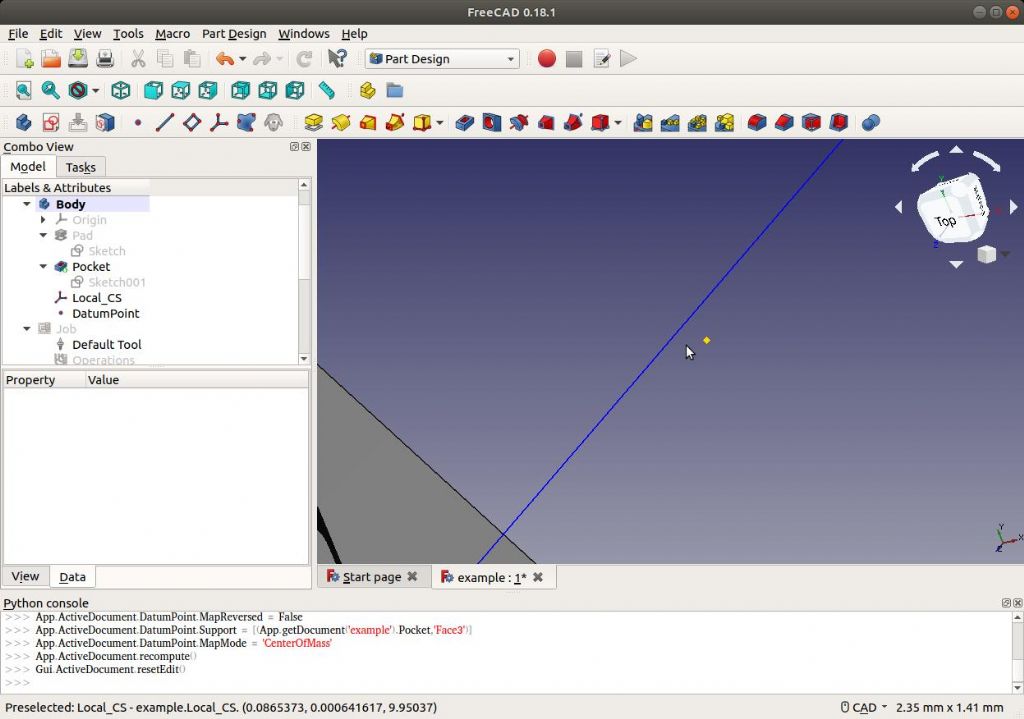

Crankshaft calculations may be too difficult for the average Joe, but it is possible. One of the advantages of 3D CAD is the tool may be able to help, perhaps even doing the whole calculation.
I didn't expect FreeCAD to have much to offer, but it has part of the answer. Maybe more if I looked harder. My cylinder example would be balanced about the axis of rotation (Z in the example) were it not for the notch. FreeCAD can tell me where the objects Centre of Gravity is, yellow dot near the mouse pointer:
Zooming in shows the C.O.G isn't on the Z axis:
I could measure how far off the Centre of Gravity is and use that to calculate a counter-balance. Or I could add or subtract lumps from the cylinder until the yellow dot sits 'close enough' to the biue line. Or, if it doesn't exist already, I could write a Python Program to search for optimum balance. These methods would only address static balance, but someone who knew the ropes could program to optimise dynamic balance. In the not too distance past engineers would do this with teams of people doing the sums and testing the result with a real model. Now months or even years of work can be done in seconds.
