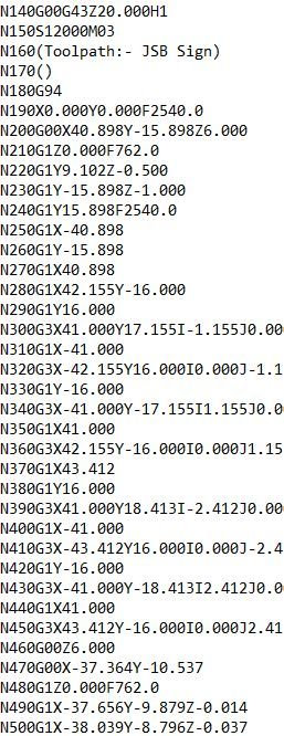

The settings for the 3mm cutter were left as default in Vectric Cut2D and they were 12000rpm, 30" vertical feed and 100" horizontal. Settings on machine means it actually runs at 5000rpm, 500mm vertical and 1500mm X&Y which seems right as it takes about 4 seconds to feed along 100mm. Should meet Andrews approvalwink 2
I did find something loose last night and tightened that up and have run the nameplate code 3 times straight off this morning and no errors on height so will run it a few more times later to be sure. Also a lot less backlash when jogging Z.

John Go and G1 are both at max in the code.
Andrew, it did ramp down before I got from mouse to camera, I had it set to ramp down over 25mm which again was too timid but better safe than sorry, it did it in the y axis along the short right hand side then moved off around the rectangle. looks like it ramps in line 220 I'm using a HSS F3 type cutter.
Well as it was free it would have been rude to say no, in my defence it is going to have to sit in the woodworking workshop not the engineering one so not really in the engineering workshop.
I have run the code 10 times now and dti was still spot on zero at the end so fingers crossed

I don't think it was coding as the error crept in in different places and was not consistant, the ball screw nut was tilting giving a lot of backlash and I think also locking up the screw as it was canted over during high speed movements.
Looks like the ramp is line 220 and 230; it goes down by 0.5mm in 25mm and then down another 0.5mm in 25mm in the opposite direction. I normally specify a ramp as depth and angle, arbitrarily 10 degrees. If the CAM program can fit one ramp that's what it does, if space is tight it zig-zags. For pockets like the nameplate I prefer to follow a helical path. Roughly the same; specify the depth, helix angle (10 degrees again) and a radius, just less than the radius of the cutter.
I think high speed tool paths would be better described as constant engagement. The idea is to keep the engagement of the cutter to the work constant, so the cutter is always operating at maximum metal removal rate. The problem (as I've found) with conventional toolpaths is that you set a depth of cut and width of cut. So far so good, but at the end of each straight line the cutter plunges in full width until the width of cut is reached. And if the path narrows the cutter just ploughs through at full width. So you have to back off the parameters so the cutter doesn't break under these conditions. Which then means it's not maximising metal removal the rest of the time.
