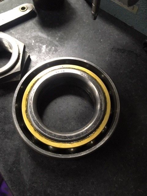

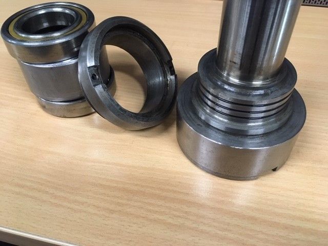

I have finally had a chance to remove the bearings from my spindle and I am not impressed with what I found. Someone has obviously been in there before and really made a mess of it. The outer bearing spacer has been surface ground to about .005" less than the inner spacer and both spacer are out of parallel by at least .001".
There were also burrs and dings everywhere, not to mention that the two top locknuts were loose.
There are no actual seals on this spindle just a type Labyrinth setup at each end.

I have now realized that the bearings were set up in the DF configuration but from the information in various bearing books I have decided to set them up as DB and after grinding the spacers in small stages I am now at a point where the 2 spacers are nearly identical in height and preload is nearly correct which brings me to believe that this is the way they were intended to be fitted.

I now have a small amount of preload on the bearings with the inner spacer now measuring .0031" (80 microns) less than the outer spacer. I don't think that these bearings were a matched set of Duplex bearings with the correct amount of offset ground into the faces.

This is the Bearing Preload Fixture that I made to simulate fitting the bearings and spacers into the Quill/Spindle assembly. It allowed me to quickly determine the difference in spacer height required. I found that a small change in spacer height (3 microns) makes a big difference to the torque needed to rotate the bearing assembly.
