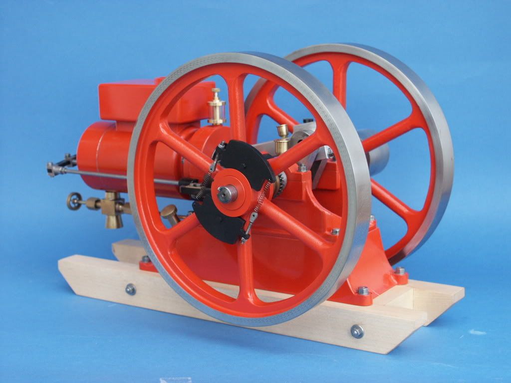

Looking at the Stuart flywheel on this engine and some others in their range,I cannot see any reason why at the outer end of each spoke there is an odd shapped lump where the spoke meets the rim,never seen anything like this in full size practice,any ideas as to why.
JasonB08/02/2021 15:17:27
avatar
25215 forum posts
3105 photos
1 articles
I think they have only got the one pattern now and the odd shapes are for when you bolt two together for the twin victoria. Even then the bumps are best removed from the outer edges and left where they tough in the middle.
Unlike me most other people don't remove the odd bits when using the single flywheel and leave then on the finished engine, it's not hard to turn off most of them while turning the flywheel and then a bit of Dremel work will take care of the rest
Two Stuart flywheels with the offending lumps removed
Edited By JasonB on 08/02/2021 15:21:20

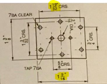

Even with the correction sheets I have found errors that they don't seem to cover, anyone able to make this to the sizes shown?
