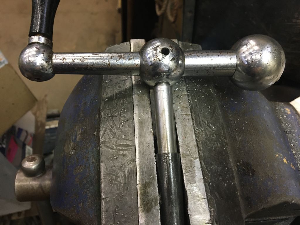

Good man cheers will I get away with just taking the plate off as the handle on the left as be broke off the lead screw and been bojed up. There was a T nut and bolt right side but not on the left. I never gave it much thought until this happened then I realised what it was for.
I’m also going to rewire the feed motor via a relay so it can only be turned on whilst the head is live.

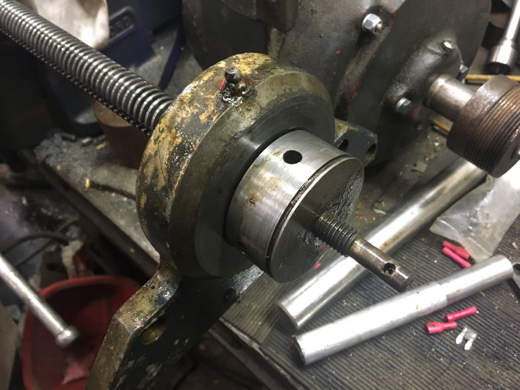

I’ve managed to get it apart after taking the lead screw out completely like you said it was a burr on outer right side of the lead screw. Had to get the pullers on it mind to shift it. Thanks for the advise.
now I’ve got it all apart I may as well repair the lead screw properly well as properly as possible without making a new one. I’m thinking of a straight 1/2 en16t bar threaded 1/2 unf cut off the damaged ends on the lead screw then bore and tap the lead screw to suit then either lock tight or drill and grub screw in place.
what are your thought.

Posted by Mark Guy on 22/12/2020 19:48:15:
I would just cut off the smaller diameter piece flush with where the step in diameter is, drill and ream the leadscrew and use Loctite 648.
What torque is that part taking? Or are you in the habit of using a Stilsons with a four foot cheater bar on the handwheel? Threading both parts runs the risk of them not ending up concentric, unless you make the shorter bit oversize and finish turn it after locking it into place.
You should probably stone or file the keyway in the entire leadscrew while it is out to remove any burrs. Also have a good look at the drive key that runs in the keyway, and remake it if necessary. It is not the best design, having a keyway along a threaded shaft - the threads act as a cheese grater on the key.
Before you commit yourself to gluing something in, have a think of how you will secure the handwheel and dials to the leadscrew. If you have the necessary taper pin reamer, all well and good, but matching the existing holes in the dial and screw is not simple, especially with five feet of screw waggling about on the end of the piece on which you are working. It might be easier to do the fitting with the small diameter piece free of the main leadscrew. Then you can test assemble everything, make one simple length adjustment and glue it together.
Have a look at the part in the foreground of the lower photo, let us call it the dog assembly. Excessive end float in this can make engaging the power feed like changing gear in an Austin Maxi. A brass washer to shim it all back snug again transforms it to a Honda Accord.

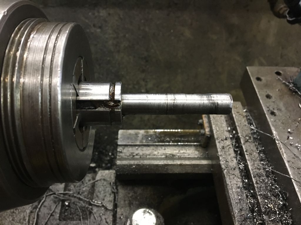

I know what you mean about going in to the death on the screw as there is no room for error as I said I was just thinking of it and I’m open to options. I also thought of just doing the last 3/4’ that is missing on the right side seeing as that part only holds the handle. Where as the left size as been welded up previously and is not concentric at all. The dog assy sits on the main part of the lead screw which I will not be modifying and the modification I’m considering would have no detrimental effect on its operation.

If you end up putting the leadscrew into the lathe to modify the end of it, think very carefully about the very long, unsupported bit that will be poking out the back of the headstock. Support it well (in a manner closely equivalent to having it in a fixed steady).

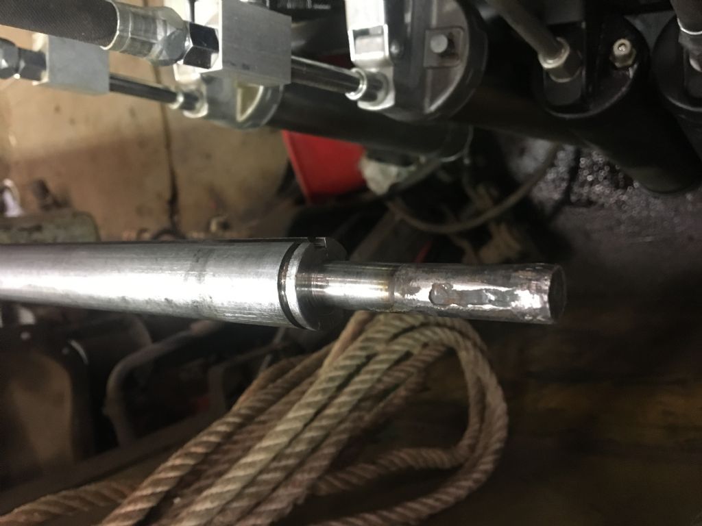

I think it is better to make the repair inside the large diameter part of the screw as there is more surface area (greater perimeter and longer depth) for the threadlocker to work. If you did want to thread it, you could drill and tap it 3/8" UNC say 2" deep and then bore and ream the first 1" to 1/2" diameter. That way, the loctited threads give security and the reamed bore gives concentricity. There is also no stress riser at the point where the diameters change.
With the left side, is that the side where the leadscrew is threaded for the thrust bearing? Turn it down maybe 1/16" then build it back up with weld, then skim back to truth. There's a description on here of how John Stevenson did the same with motor shafts.

This end of the lead screw is .010 out around 5/16 from the screw( just as it leaves the bush) I’ve made the wheel end c/w taper hole and pin and was just thinking what your thoughts would be about turning it down say .030 unti concentric and boring the wheel end .002 under size over 2” and sweating it on.

I’ve secured it in the lathe with a cone I’ve knocked up on the back side and nipped it up with lead screw nut and the back of the screw is supported with a packed stand and rubber lined v cup to prevent bounce. I’d be struggling with the mill as it all still in bits. Thanks for the advice
