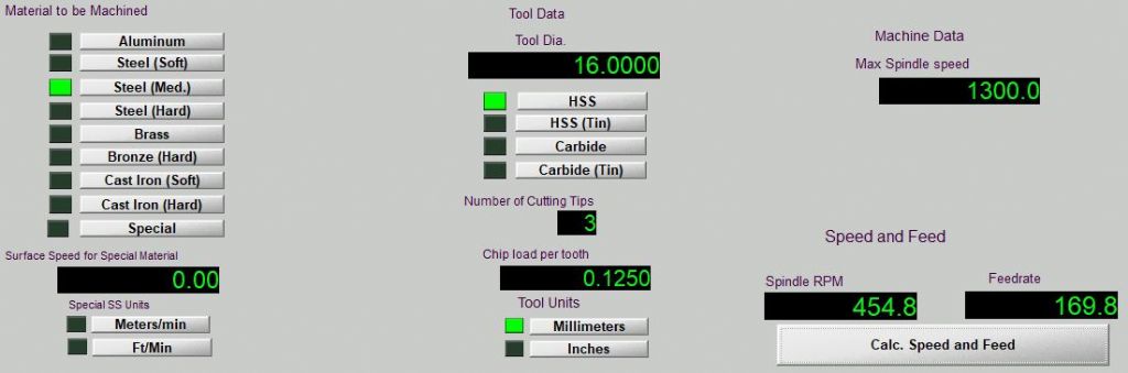

Martin Connelly15/05/2020 15:04:01
avatar
2549 forum posts
235 photos
The chips are looking as they should.
I have done a quick experiment to see if I could see any difference between climb and conventional milling. This was done on a piece of 10x100mm gauge plate using a 16mm 3 flute M42 cutter with no name but says made in England on it. I used the Mach3 Mill speeds and feeds wizard to get recommended speeds and feeds. Depth of cut was 0.1mm and tooth load was 0.125mm. The result was that there is no real visible difference but the conventional milling finish was a bit rough as in it felt torn. It also had a slightly bigger burr on the top edge. The roughness felt like it would come off with a bit of rubbing with Scotchbrite.
Milling wizard page.
Climb milling in progress
Climb milling result
Conventional milling in progress
Conventional milling result
The swarf slivers are about 15mm long. The mill is a CNC mod on a round column RF45 type machine. You have to look closely to see the machined surface. The work took about 35 seconds to complete each pass.
Martin C
