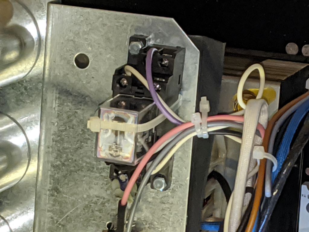

I've taken the top off and run the lathe. The noise seems to be coming from a small component
I've tried to get a few videos of it, you can see some little paddles working and arcing occasionally.

Excellent! my feeling is that the small contactor in the plastic box, which I assume is single phase side, switches in the main contactor on the base of the unit, which is on the three phase side, it could be that servicing all the contacts in both relays would cure the problem, but not your job if it is under warranty. Also if there is some sort of overload protection in the unit, and I am sure there will be, that also could be faulty, and breaking down partially when there is load on the convertor. Having no experience with this type of phase convertor, I now realise I should have asked you to turn it on without the lathe connected, to see if it still rattled, which would condemn it as definitely faulty! No matter, we await the next thrilling installment with baited breath, and it distracts me from the triple shower and bathroom pump problem I also have on the go!
On a different tack, it could be that a fault on the lathe or the lathe wiring is causing intermittent loading on the phase convertor, and thus causing it to trip off and then restart, possible, but not probable. is the lathe contactor pulling in when you operate the lever on the lathe?, it could be that one of the contacts is not making properly. the lathe contactor must be working to an extent, because the C&D switch only completes the circuit to the coil in the contactor, and then the coil pulls the contacts in the contactor together to connect all three phases simultaeneously to the motor. Unfortunately, you cant observe this with the lid off, as removing the panel from the lathe disconnects the supply! Did you make a new contact to replace the one you found in the bottom of the box?

Phil Whitley16/12/2019 14:58:58
avatar
1533 forum posts
147 photos
the relay K2 can be seen arcing in time with the rattle from K1, I would suggest the rectifier is failing, allowing intermittent DC to K2 and causing the fault we see in the videos.

Or possibly C7 or R7? the fact that the PC 40 does this with the lathe disconnected is pretty damning! 3 phase motors will not start or run on 2 windings, when there is a "leg off" they just growl and sometimes turn very slowly.

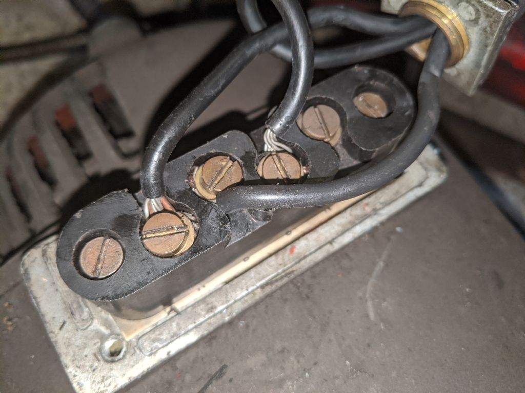

Phil, to answer your question from a few messages ago, I have not replaced the contact i found in the bottom of the box. The lathe has been wired around that contact so it no longer needs it to turn on. I had my electronics friend look at it. The contactor must have broken so they wired around it, it was the other part of the contactor for all of the microswitches, so that's also why the yellow wire is not connected through the limit switch or to the circuit board.

Back to the lathe contactor, if the missing contact has been bridged, the lathe must be starting on the other two contacts, the C&D switch cannot start the lathe without a contactor of sorts, as it needs to switch the three phases on simutaneously and seperately. I will look again at the pics of the lathe contactor and get back to you. Must go and cook Isobels tea!!
