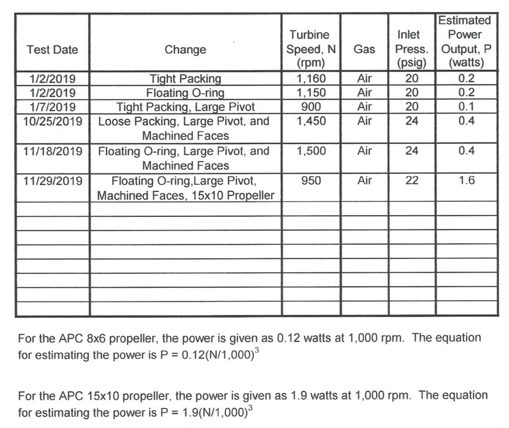

Turbine Guy29/11/2019 21:05:13
541 forum posts
578 photos
I kept looking for reasons my Stuart ST oscillating steam engine was putting out such low power. I analyzed the flow through the ports with the small opening area. The following diagram shows the ports in the maximum opening position. The circles with the solid lines represent the holes in the standard. The dashed circles represent the holes in the rotating cylinder. As you can see the maximum overlap is very small. The hole in the rotating cylinder is 1/16 inch in diameter and the full flow area is 0.0031 square inches. The maximum opening area of the overlapped ports is 0.0013 square inches. The average opening area during the intake cycle is 0.00084 square inches. I estimated the pressure drop in the inlet and exhaust ports to fill and empty the cylinder at 1500 rpm with the average opening area. The estimated inlet pressure drop was 3.7 psi and the estimated exhaust pressure drop was 8.3 psi. With half the available pressure lost in filling and emptying the cylinder at 1500 rpm, I thought running at a lower speed would be more efficient. I removed the APC 8 x 6 propeller and mounted an APC 15 x 10 propeller. The maximum speed I was able to obtain with the 15 inch propeller was 950 rpm. The power required by the APC 15 x 10 propeller at that speed is 1.6 watts. This is a major increase in power from my previous tests and is more like I expected from the Stuart ST steam engine. Apparently, it is best to run at a low speed due to the very small port opening area. I will add an updated chart including this test in my next post.
ST Port Opening
Edited By Turbine Guy on 29/11/2019 21:13:22
Turbine Guy29/11/2019 21:23:24
541 forum posts
578 photos
The following chart shows the test described in the last post. 22 psig was the maximum pressure I could obtain with my airbrush compressor running continuously with the APC 15 x 10 propeller.
ST Test Results 3
