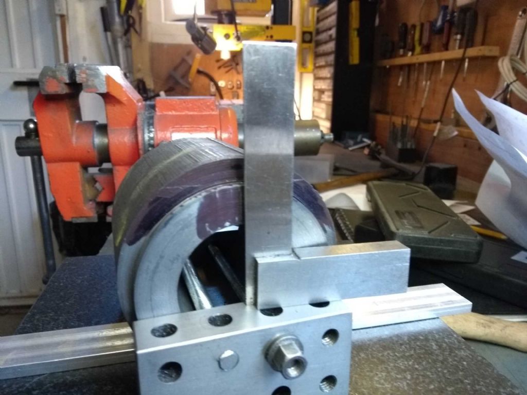

So this is what I came up with.
The ally bar is to raise it a bit (for assembly, then removed). The two Stevenson's blocks are clamped to cylinder ends which are (I hope) normal to the bore. Finally, the rotation is checked with the T square - you can just see the scribed line if you put your good glasses on!
Next to mount it on the mill
The reason for raising the piece is mainly so that i can get the indicator at (more or less) centre height.
Finally, the drudgery of slicing of the top at 1mm doc at a time. With a 3 flute carbide mill that goes quite nicely albeit slowly.

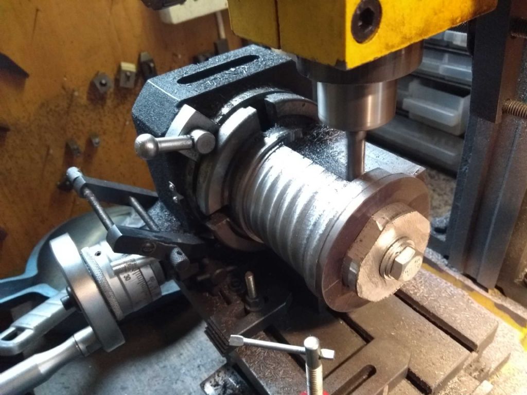

Next: How on EARTH am I going to mount this vast chunk of metal on a rotary table on my tiny mill?
That's the general idea. A chuck is impractical for a number of reasons. One of which is that by the time I have a decent sized chuck on there and mount the cylinder, the cylinder would be off the edge of the table! Another is that I did not think that the 5mm flange would provide enough grip. Boy was I right about that! (more on that later).
In the end I decided to use an MT2 blank, a clyindrical spacer and a clamp on the top.
This gives and idea
The MT2 blank (drilled and tapped to M10 is held in by a 10mm bolt, the cylinder fits snugly on the spacer cylinder and another M10 bolt clamps the top of the cylinder - as below. As seems usual, I'd underestimated the spring in the boring bar and ended up cutting the inside a bit too much making it rattle somewhat. However, a 0.15 shim (feeler gauge) slipped around the blank fixed that nicely!
You can see why a normal chuck just wouldn't work!
Also in view is my Heath Robinson mill end stop. A couple of clamps bolted down and nice little vertical rod on the Y axis to act as a stop.
I said above that the other reason that I couldn't mount it on a chuck is the lack of grip. There is a LOT of vibration when removing the outside of the cylinder. The Z creeps up, the handles fall off and the X can shift too (so I need one hand to hold the X axis, one to hold the z axis and one to turn the wheel - hang on....!)
What's more challenging is that it's actually shifting the rotary table on the mill table, even after adding stops and clamps to it. In fact that's where I gave up today. I have to work out how to hold it in place more rigidly.
Or I could revert to taking very small cuts but this is already taking forever!
A mill and a rotary table will NEVER replace a lathe...

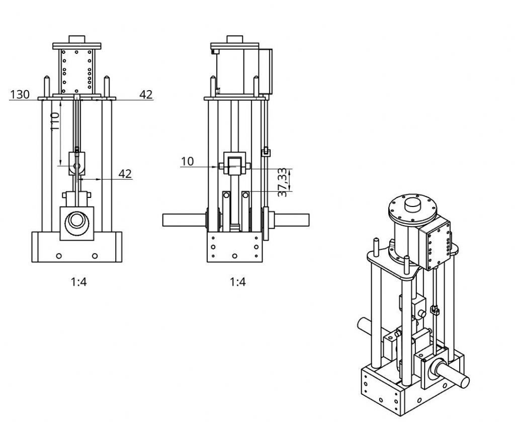

The only thought I had was to ask you about the cylinder design. With a 50mm bore, 5mm wall thickness and a 10mm flange (which is what I have) plus the valve face I needed a 100mm bar to get it all in.

JasonB20/03/2019 07:13:38
avatar
25215 forum posts
3105 photos
1 articles
Iain, I would try and add some support to the other end of the cylinder such as an angle plate or even a bit of angle iron would do and should fit if the leg of the "L" faces towards the rotary table.
You could also rough out a lot of the waste with the cylinder between two angle plates/irons just turning a few degrees at a time and then back onto the R/T for the final rounding cuts which would be a lot more solid. The two 45degree roughing cuts on this cylinder were done like that but you could do say every 10degrees or so just rotating by eye.
The two angles effectively become the jaws of a vice and if you rest your two flanges on some packing that will set a constant height.
Also think about getting a roughing cutter and rather than feeding down 1mm at a time use more of the side once you are to depth something like this. The rougher will reduce the load on the machine and you will be using more of the cutting edge rather than just blunt the bottom 1mm.
Gas_mantle.24/03/2019 18:39:48
avatar
359 forum posts
269 photos
Hi Iain,
I've been thinking what you said about cutting a large cylinder from solid, this engine on ebay is similar to what I was hoping to achieve from square stock
Edited By Gas_mantle. on 24/03/2019 18:41:02
Edited By Gas_mantle. on 24/03/2019 18:46:00
Edited By Gas_mantle. on 24/03/2019 18:50:29

I found I'd gone a bit too far to follow some of Jason's advice. I already had a cylinder of sorts so roughing out at 45 degrees didn't seem like it was worthwhile. However, the idea of taking a deeper cut to use more of the mill struck me as eminently sensible.
Despite this being sensible, it proved a little too much for the poor mill - to be more accurate my 3D printer! IN an earlier episode, the motor drive gear had give up the ghost and I'd replaced it with a 3D printed one, which has supported my endeavours tidily through the past few months. However, this was too much for it.
Poor thing. I did attempt to superglue it back together, but this lasted but moments. As the shattering of the gear resulted in the key (conductive) ricocheting round the box which contained the motor controller (electric!) I decided that prudence was the order of the day and reached out to ARC for spares.

Because I had to leave some metal for drain taps, I'd decided to carve out the cylinder 8mm short of the end flanges and then separately carve out the remaining 8mm (apart from the tap mounts) with a snub ended mill. I'm told that one should try and avoid sharp edges! My first snub nose use...

To those of my devoted followers who have been wondering what I've been doing for the lat month, the answer is, 'not a lot'. Not of taking perfectly good metal away from a part.
Most of that is professional domestic, however, I have been a bit stuck on the cross head guide for my engine. If you recall I had not realised that such was necessary so hadn't considered it. Geoff walker and Jason B help me to understand about the tubey type of guide and of course I think I'd already seen the squarer, slidey type of guide (most used in horizontals).
This seemed complicated so I got on with making the bits I did understand (more or less!). Now, however, I'm at the point of making the con rod assembly so it's become important.
The thing that I'm trying to work out is which is the easiest to fabricate with the least precision required.
The slidey type guide I think would be easiest in a horizontal, but with an open column engine (I think it's called) I would struggle to find somewhere to put it and it spoils my artistic idea of tapering the columns. It's a lot of pieces (or a lot of machining), but I guess it could be done.
The tubey type thing actually looks more doable, though there's an uncomfortable amount of accurate concentric lathing to do. It is also probably more aesthetic given the type of engine.
With a stroke of 60mm I have a throw of 30mm. The big end rod is designed at 120mm (2 * stroke). According to my excel calculations (checked roughly in my CAD package), that means that the maximum excursion at the bottom of where the tube needs to be is about 16 mm (at a bit over 65 degrees from TDC).
Add half the diameter of the con rod (13mm dia) and the internal bore of the tubey thing needs to be 32+13 = 45mm.crossheadsizing.jpg
So I'd need a tubey thing with an internal bore of 45 - 50mm.
One of the reasons for going into this dull detail is that Mr Ballamy suggested that a tubey thing (page one of this epic) with an external diameter of 25mm and an internal of 18mm would be a good start. I expect this was just a wild arsed guess, but I tend to treat his wild arsed guesses with a bit more seriousness than my careful plans, so wanted a sanity check.
Ray Hasbrouk's Engine number one has been one of my inspirations and that has a tubey thing made from 2 inch iron pipe which sounds close to my calculations. I don't know where to get 2 inch pipe (in 6 inch lengths!) and have an aversion to buying 50mm round bar and taking away 90% of it.
So I throw myself on the mercy of the expertise. Is buying a bit of rod and exercising my best boring bar the best way or should I try and rethink the design - perhaps even go for a slidey thing.
For what it's worth, this is the outline of the engine design as it stands at the moment, without adding crosshead support.
Any advice provided today will allow me to buy parts in Doncaster tomorrow. No pressure .
Oh - and one attempt at the big end bearing went badly wrong as I tried to mill it to width. Something slipped and one side ended up 5mm lower than the other - and too low. So I've re-ordered a bit of cast and reduced it with the lathe which has worked better. I'm hoping to get close to finishing that today.
As usual, my thanks in advance.
Iain
JasonB10/05/2019 14:46:20
avatar
25215 forum posts
3105 photos
1 articles
yes my 1" guide wa sa bit small given the size of your engine. I have just looked at my Todman which is 76mm stroke, 140mm conrod and has 41.25mm between the guides. based on that you should be able to get something around the 38-40mm internal diameter.
Did a rough sketch of your engine frame, scaled my conrod and crank down to your sizes and sketched out a quick trunk guide (tube thing) with a 40mm bore, 4mm wall.
If you stick with a parallel 13mm rod you will need the small 1mm x 2mm chamfer for clearance but if you belly the rod as shown then you could omit the chamfer. Or keep the chamfer and reduce bore to 38mm. Cross head will just pop out the bottom of the guide but that will save wearing any ridges.
Just so happens that a bit of scaffold pole will come up just over 40mm after the inside has been skimmed and leave approx a 4mm wall. So you could either silver solder that to a disc and then skim the flange it forms and the bore in one setting so it is all true or cut from 50mm or 2" square bar which allows enough for M5 nuts in each corner to fix the flange with.
Edited By JasonB on 10/05/2019 14:47:40
