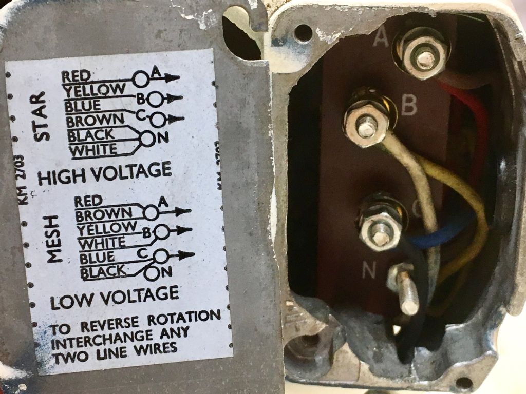

Lee,
I am totally confused......
The white cable is connected to your motor's terminals marked A,B and C, yes or no?
Is the machine currently running from a 3 phase supply or not?
You want to run from a single phase supply using an inverter?
Connected to the motor's terminals A,B,C and N, there are coloured wires as per the photo depicting Star.....?

Hi
Yes the cable is connected to ABC
The machine was running from a phase before it came to me
Yes it will be run from an inverter with Pendent for control
Yes it looks as though it's in Star

In that case, connect the coloured motor wires as per the diagram, for Mesh, then use the White cable ( if its long enough..) connecting to terminals U,V and W on the inverter, the free end to terminals A,B and C on your motor.
There should be no wires connected to the N terminal.

Hi John
Ok thanks for that will do but I'm going to replace the white cable with some SY shielded cable as it's not long enough

Ok so here's my attempt at wiring into the Mesh configuration any advice if this is correct.
A - Red/Brown
B - Yellow/White
C - Blue/Black
N - No Wires Connected

Hi Lee,
You now have it wired correctly for 240 volt delta (Mesh) operation.
