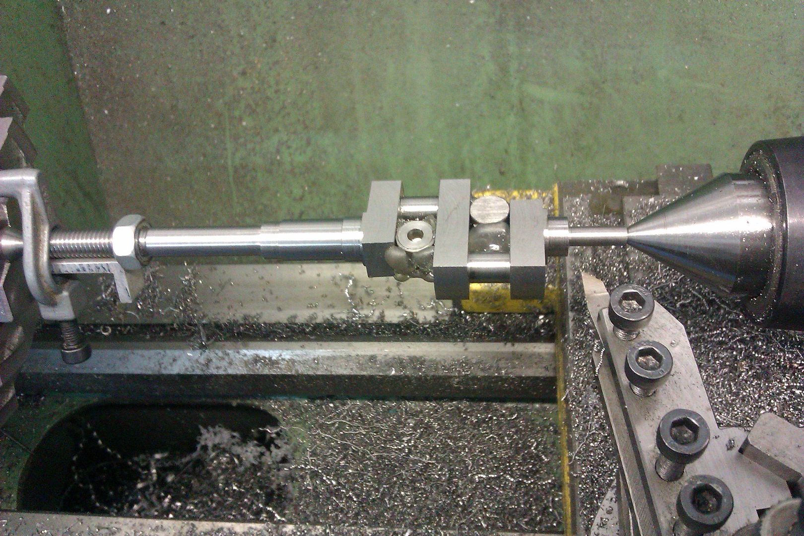

So regarding the crankshaft. Following Ramon's advice, I had a go at grinding an HSS tool. It's not pretty:
But somehow it did give a very good finish, at least until the 'step', when it chattered like mad. I tried increasing the relief at the sides, but to no avail. Also tried slowing the speed a bit, but again no luck:
Something I've never been totally comfortable with was turning to dimension in the Z-axis. Diameters aren't much problem, but specific lengths I've always struggled with in the absence of a DRO.
This is the basic geometry of the shaft, not checked the dimensions, but they're about right:
So, what's the procedure for getting accurate lengths, and the undercut bits?
Do I somehow angle the tool so that the left edge is perpendicular to the Z-axis, turn to diameter, move along to a scribed mark, the feed inwards and hope for the best?
Also, it was mentioned previously to work at the tailstock end, and turn the shaft to enable both ends to be finished. Presumably this is after the central portion is initially turned to size?
When swapping the ends, is it OK to put the carrier on finish machined diameters (maybe with a thin aluminium packing piece), or should the bar be significantly over-long so that the carrier tightens onto a bit that's cut off later, when finishing to final length? I want to face off the centre drillings to leave clean faces for this one anyway.
Thanks.
Ramon Wilson24/08/2022 23:50:19
avatar
1655 forum posts
617 photos
Doc,
The edge faces of the tool need a reasonable back rake, the top rake is about 2-3 degrees, 5 at most, and there's no side rake on the top surface but you could put a little on if you are only cutting on the left hand side of the tool - mine has none so it cuts in both directions. Going right into a corner with all in contact puts a lot of cutting pressure on which quickly leads to chatter if the tool is not really sharp and the head stock a tad worn etc. Try coming up to the corner in several cuts inwards gradually creating the full form - that will improve things considerably. You do not need to undercut the shaft at all but set the leading edge of the cutter square to the shaft and let the tool create a radius.
If you haven't got a dead stop for the saddle then create one by clamping a piece of bar on the bed and coming up to it for depth. Make a simple gauge for the amount of movement required to set the stop bar position.
A method of stopping the saddle at a fixed position is a facility well worth having - once you have it you will quickly realise that. I use mine all the time using slip gauges to set the movement but as said a simple gauge can be quickly made.
Personally I would not machine the centres off in case you need to remount it between centres. EG to polish a tight spot.  Use the smallest centre drill and by all means face the ends to leave a small diameter cone if desired - once you remove them you've lost that ability to set it up again - your choice, but if you do face them off and you do require to remount it you will soon see exactly why I'm saying that.
Make the initial shaft to finished length plus a tiny amount for facing and use packing as you say to prevent the carrier from doing any damage.
Best - R

JasonB25/08/2022 07:09:06
avatar
25215 forum posts
3105 photos
1 articles
If using that HSS tool I would also rotate the toolpost so that you are presenting the left cutting edge of the tool almost at right angles to the lathe axis but with a bit of clearance. Infact just like your carbide tooling does. That way you can also use it for facing a shoulder square and if fed in a little deeper than the diameter cut it will also do your undercut.
As you have the tool at the moment you get a lot of contact along teh cutting edges and that is going to cause chatter, angled only the radius of the end will be cutting. I'm sure I have seem picture sof Ramon's tool mounted like this, he may be able to post one if not I'll dust off the HSS and take one.
Rather than turn the smallest diameter first which leaves a big step get some ctr support and do the long length upto the central section this will mean that when you get to the step the edge of the tool won't be taking such a deep cut which will reduce the chance if chatter.
Then do the next smallest dia and so on all will end with shallow steps.
I don't have a DRO on my lathe and unlike the myfords the carriage handwheel is insensative and marked in 0.020" increments. I tend to set my topslide parallel to the lathe axis and it's handwheel dial to set a final cut which is then applied with the cross slide
Edited By JasonB on 25/08/2022 07:14:26
Edited By JasonB on 25/08/2022 07:17:56
Dr_GMJN25/08/2022 07:38:01
avatar
1602 forum posts
Thanks all.
What about using an HSS parting tool, ground with a radius, then do the undercuts to final depth (after roughing to the largest o/d?
Then work on the diameters knowing that the tool will run into the groove and the lengths are already correct?
Ramon - I made a saddle stop a while ago, but probably don’t use it as much as I should. My saddle hand wheel is a bit sloppy, and if using power feed it’s easy to strain the drive when it hits the stop if I do t release the feed at precisely the right time.
Jason - so for the long central length, how do you get an accurate length? Not sure my top slide has the range (will have to check). Do you check for top slide x-alignment with a dti? Mine can turn and just had an angle scale on it with two clamp bolts. So potentially all the careful setup of the tailstock to turn parallel could be negated by using the top slide unless it’s set perfectly parallel.
Edited By Dr_GMJN on 25/08/2022 07:38:45

Ramon Wilson25/08/2022 08:51:47
avatar
1655 forum posts
617 photos
Doc,
I don't use the top slide for turning unless I'm turning a taper and certainly would not use it to turn parallel - just too much effort to get it set right only to lose it as soon as it needs moving. You can soon get bogged down in how to set the TS dead parallel which for this operation simply isn't required but, advice is what it is, you do the choosing.
I can't recall my ML7 but setting the topslide parallel interferes with the tailstock on the Super 7 when turning between centres giving restricted movement on the cross slide. My top slide is permanently set at 15 degrees for that very reason and only gets moved to change the angle if required
There really is no need to undercut the shaft, there's no justification for doing so besides it's not full size practice.
The tool you have ground is fine - you may just need to tweak it a bit to improve the cutting - part of the learning process in grinding tools by hand. Here's a short version of the one I posted previously roughing out the crankshaft for the Corliss engine - virtually the same as your shaft just larger
It was finished with the other, longer, tool shown previously. Note the radii - an undercut would be considered to reduce a crankshaft to a thinner diameter for absolutely no practical reasoncorliss project (66).jpg
If you have a dead stop then use it in this case. Carefully face a small length(s) of steel to the dimension(s) required and set the stop. With one hand on the hand wheel lift the self act lever a little before the stop is reached and finish off the last few thou by hand. A dead stop is not designed for running into under power! As Jason I have no DRO on the lathe - doing the above provides an accurate method by simple means.
As always though the advice is based bearing in mind on what kit you have and how I would tackle it as such. You do the choosing
Best R
