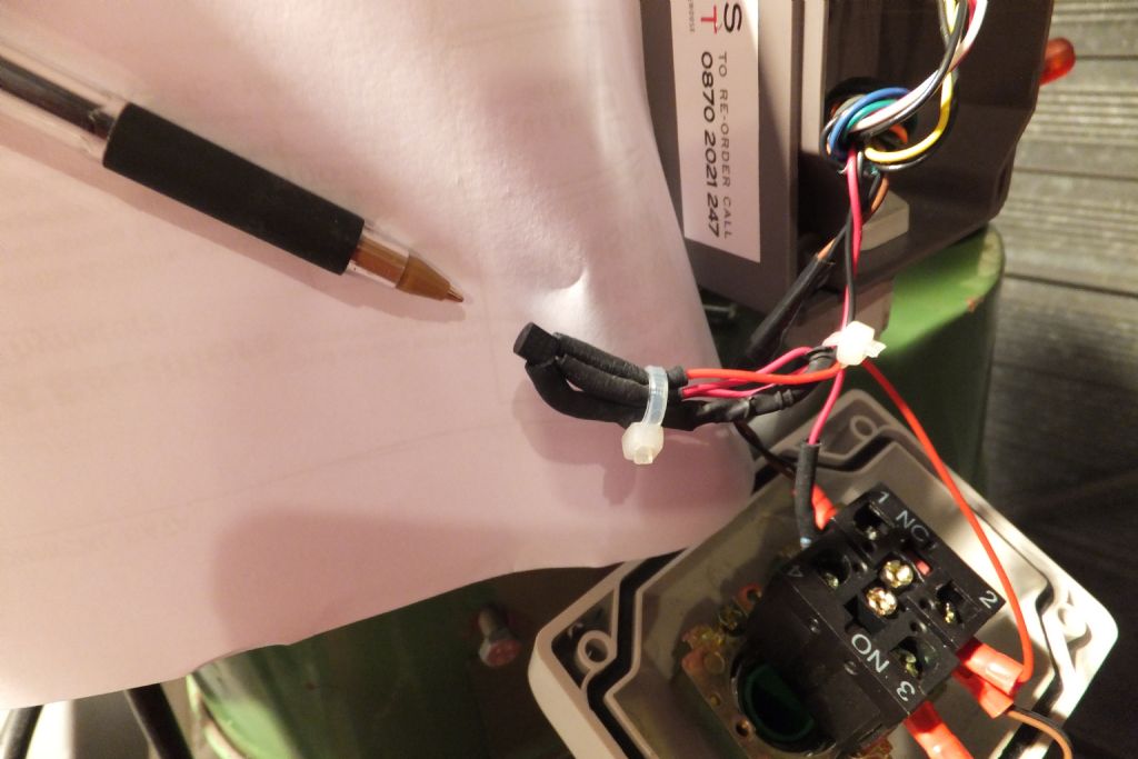

Jimillsortit29/03/2014 19:29:46
7 forum posts
3 photos
Hi Les
I have to say thanks for posting the above schematic and picture, I had been pondering how to get a remote control starter for a Teco T-Verter to lock in for a few days, pardon the pun but the penny dropped when I saw your picture and schematic. I ordered a couple of SCR's from ebay and got the the unit to work first time but was a little careless when tiding up the wiring and broke one of the pins (they are really delicate) on the SCR so had to do it all again, you can see from the photo below it has turned out quite well. I will post more photos on my thread for my mini mill I started a while back as I don't want to hijack this thread.
Jim
Edited By Jimillsortit on 29/03/2014 19:44:51
Edited By Jimillsortit on 29/03/2014 19:45:27
Edited By Jimillsortit on 29/03/2014 19:46:06
