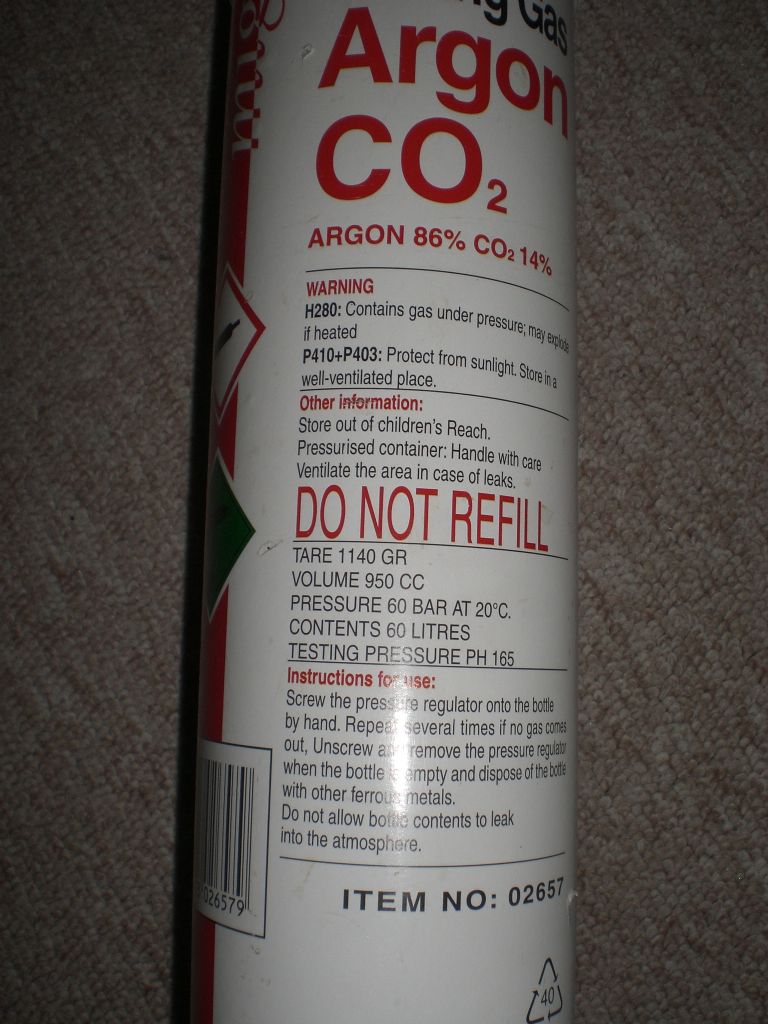

Hi, I have a 60L one that states the pressure at 60Bar at 60 C. Testing pressure PH 165, I doubt many home compressors will reach very near that pressure and I have welded a BSP socket onto a couple in the past to get a little extra reserve pressure for a paint spray gun which have had 160 PSI in them without any problems. But of course we do these things off our own bat as long as no one else is put in danger.

Nick's bottle says "Store in a well-ventilated place" and "Ventilate the area in case of leaks", which both make sense.
However, it also says "Do not allow bottle contents to leak into the atmosphere" in the Instructions for Use. We're obviously not talking flying bottles or huge build-ups here. I'm still as puzzled as I was why they use that wording.

Hi, as GeorgeB says, it is puzzling, the very intended use allows it back into the atmosphere. However both Argon and CO2 are heavier than Air, so in a small unventilated space, it can build up to an unbreathable atmosphere especially if you get through two or three of them in a short period of time.
