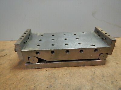

This is what I have in my head.
In what way would you use the DRO to build the sine plate?

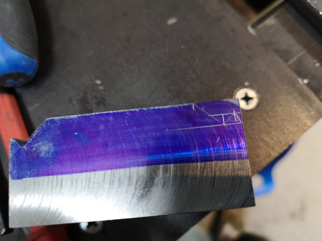

Been out and mocked up this as an example.
Edited By Martin Connelly on 21/05/2020 14:23:04

That is basically how I cut the dovetails for this slide.
Martin Connelly21/05/2020 14:38:04

Lee
Got it in one!
The point about using a DRO is that it makes it pretty much routine to get the spacing of the two rods and the ledges they butt up against correct to any practical level of accuracy. Its equally easy to make the riser block required for whatever angle you want to sufficient accuracy.
Equally getting a nice regular pattern for the tapped holes is almost trivial. Consider locating dowel fittings to get the fence square or make the fence L section so the working part is above the table and trim it dead square in situ.
Plenty of variations on the theme to get the best balance between what material you have on hand, what machining facilities you have and what you plan to do. I'd probably make flat bottom Vee carriers for the rods with bolt holes to fix to the table or riser. Rods sticking out about 1" each side for clamps. Except for very shallow ones risers are probably most convenient to handle if made with tapped holes in top and bottom. Top ones take the Vee trough for the rod, bottom ones hold a plate extending either past the ends or to one side drilled so it can be bolted to the table. Shallow ones would need the fixing plate and riser made in one.
I'd make the riser in situ. Start with some stock a bit too deep, fit bolt holes, fix to base, bolt on machine table and cut it exact to size. Fit Vee troughs and sine plate and get to work.
Or you could make a complete unit on its own baseplate like the one in your picture. Invert it to bolt the riser on. Simply clamping the rods to a flat top ought to be satisfactory. Especially if you use the proper sine plate layout with deep ledges. Although I'd go for shallow ledges and a Vee trough but realistically its 6 of one half a dozen of the other.
Being a lazy type I'd probably base the device around a drilled and tapped 1/2" thick alloy breadboard from optical suppliers like Thor Labs **LINK** . The smaller ones aren't too silly spendy but double density versions might be a little too much. Something in the 8" x 8" to 10" x12", 200 x 200 mm to 250 x 300 mm might suit. The anodising is tough. Some stiffening underneath would be desirable for most jobs. Glued on strips perhaps.
The drilled and tapped breadboards are roughly comparable in price to 1" aluminium tooling plate or ordinary 25 mm steel plate so its not an unreasonable way to go about things.
So DIY "all new" you are in a similar price range to an import 4" tilt and swivel vice or a bit more than a swivel 6" vice. Much, much less if your finder-fu is good on used and handy scrap.
Its what I would do if starting out saving maybe £3,000 on stuff I'd most likely no longer need to have. Probably half of which I've not exploited. My finder-fu is usually pretty good too.
With a bit of creativity in the fence line, think limitless vice and carved in situ style, a device like this can make a larger machine vice unnecessary. If one piece style you can take it to the bench for preliminary set up too, of-times on a smaller mill the head gets in the way.

Lee Jones 621/05/2020 14:44:54
258 forum posts
125 photos
Going okay so far, but it's such a faff.
I still like the idea of a repeatable sine table based setup with stops, but I just can't picture what that would d look like without purchasing some kind of tilting table.

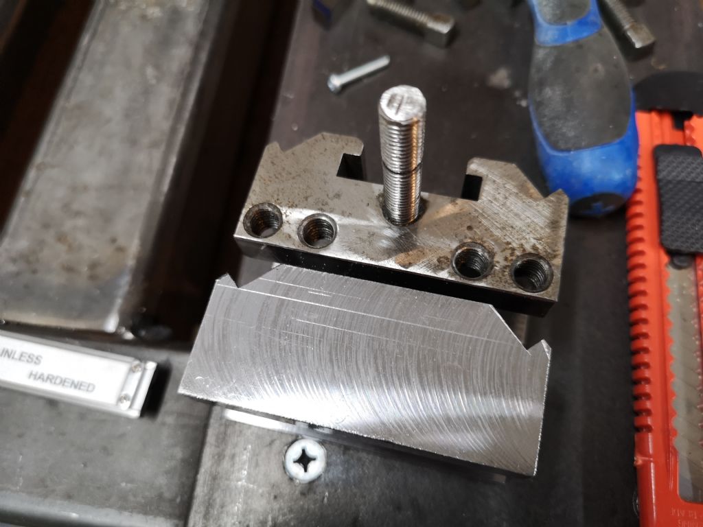

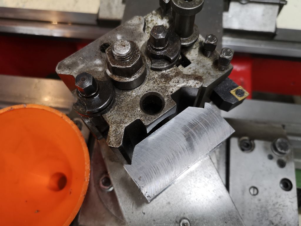

lee, have you worked out how to remove the pin from the post so that you can offer up the post to your holder at this stage for test fitting?
Lee Jones 621/05/2020 14:58:11
258 forum posts
125 photos
Doesn't quite work like that I'm afraid.

Posted by Lee Jones 6 on 21/05/2020 14:58:11:
Forgot about that bit in the middleblush may be worth doing the tee slot first on the others?
