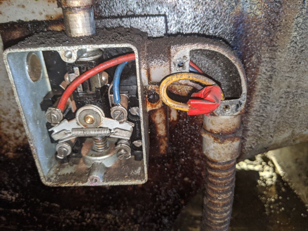

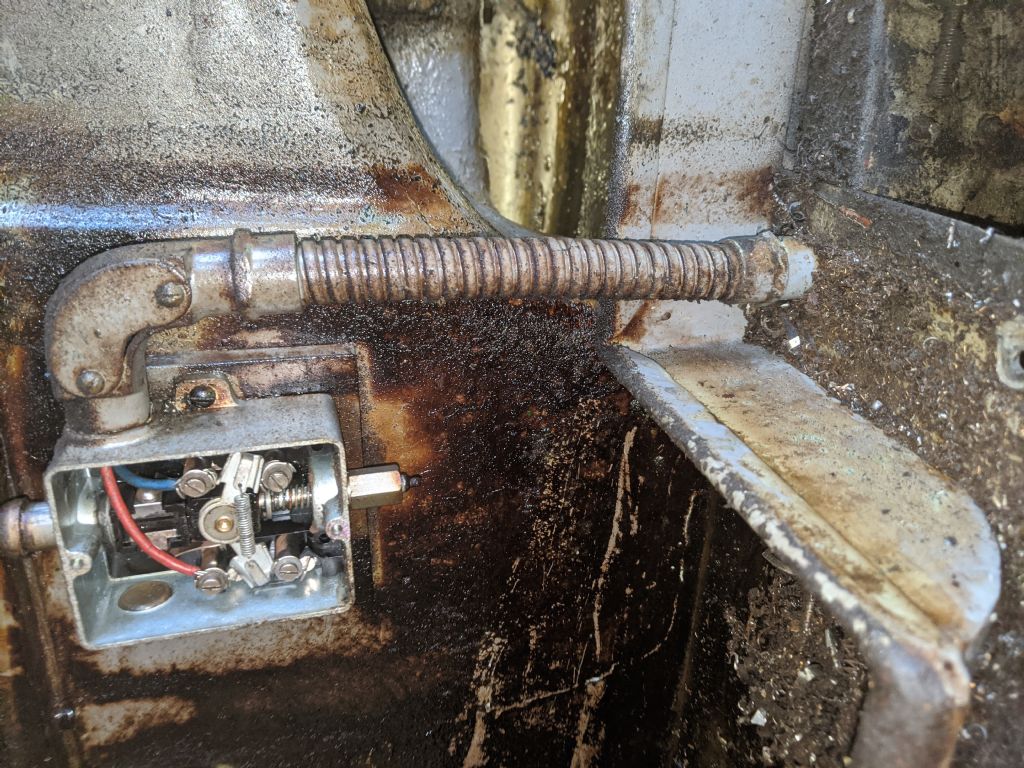

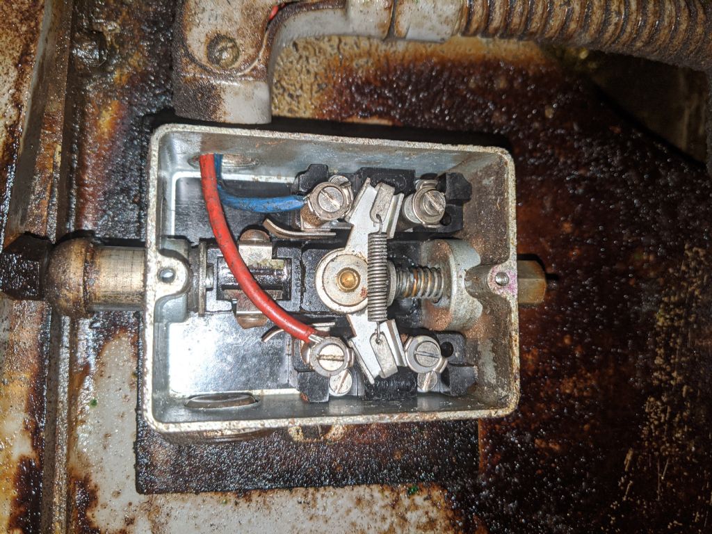

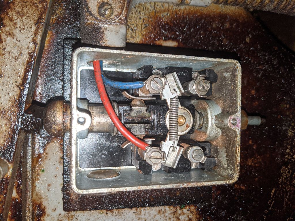

Richard Kirkman 112/12/2019 18:29:41
334 forum posts
799 photos
Been back to have a play today, had a look inside the "limit switch" and it doesn't look the same as Phils.
Thoughts?(apart from it being filthy)

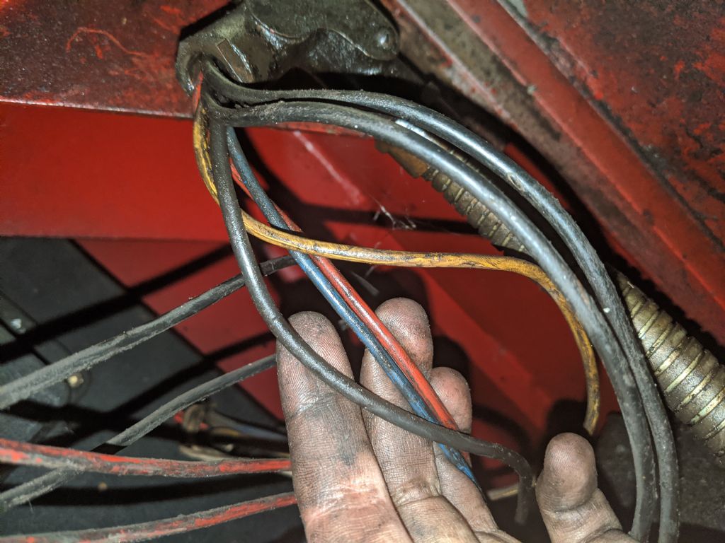

Phil Whitley12/12/2019 20:21:43
avatar
1533 forum posts
147 photos
Hi Richard, all the wiring diagrams using this type of switch use three wires to the switch, the yellow is missing, and it is the yellow wire that takes the "live" through the end cover switch and the key switch to the C&D switch! the red is connected to the terminal where the yellow should be, see if you can trace the red back to the starter and see where it goes. even if it has been wired in some way to make it start, the NVR cannot work unless tyhere are three wires at the C&D switch.
Phil
Phil Whitley12/12/2019 20:39:24
avatar
1533 forum posts
147 photos
Take the red tape off the yellow wire in the starter area, leave the end cover on, remove the panel round the key switch and see if you can test from the yellow wire in the starter to the key switch to see if you can find out where the yellow wire goes to. It should start at C1 on the contactor, go through the end cover switch, through the key switch, and to terminal one on the C&D switch.
Phil
Phil Whitley12/12/2019 21:47:26
avatar
1533 forum posts
147 photos
Richard, the switch mechanism seems to be working correctly, but I would guess it is lacking the correct live feed, I am going to reproduce the wiring diagram out of your original manual in a more readable format, with the errors taken out, but I am working tomorrow, so will do it at the weekend. in the meantime, see if you can find any other disconnected wire ends, especially yellow ones!
Phil

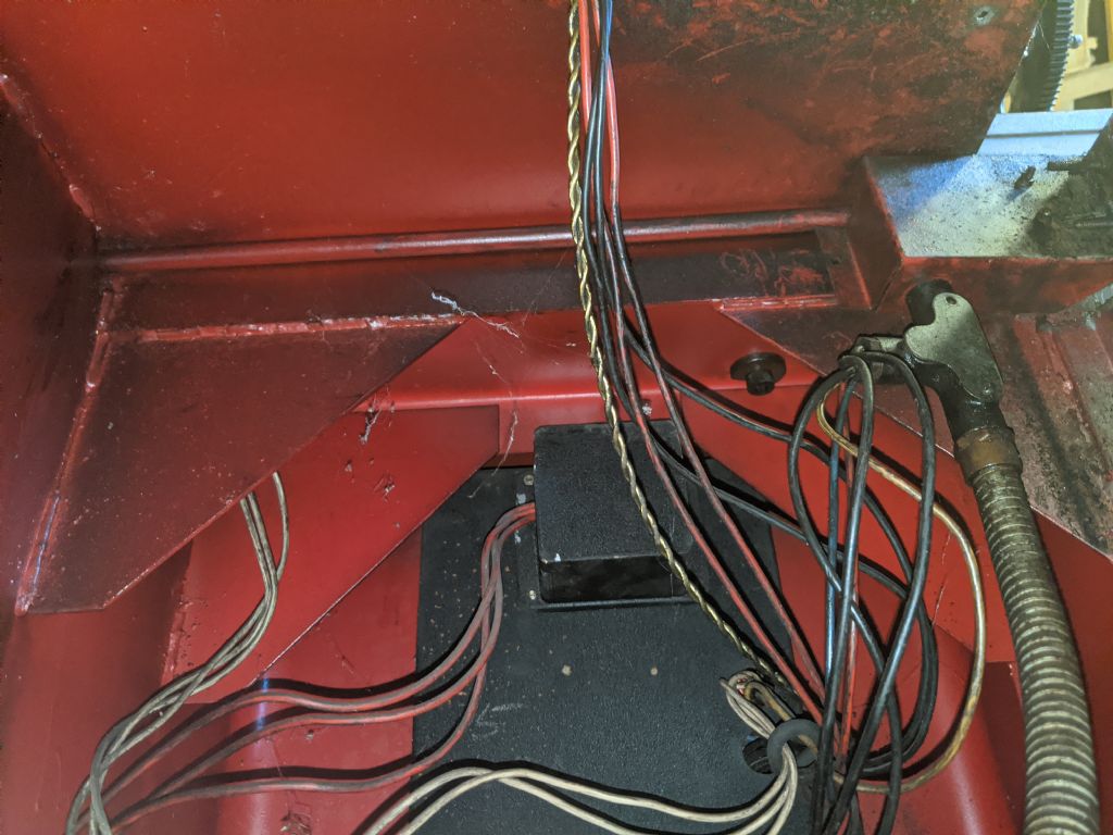

All the safety switches have definitely been cut out of the circuit as it shouldn't run with the end cover off, but it does. There's no logical reason that they would have been taken out though, so you may be right. I still think the contactor is broken and is just being used to transfer the power, with no no-volt release. The contactor is always in contact with the circuit, it never stops being attached, so perhaps the spring went and they decided to cut it all out.
The same yellow wire from yours is disconnected at both ends on mine
I know someone who's tearing down a colchester student so even though the lathe is working for now, i'll see if i can get her to sell me the control panel and components from her lathe. So I can just replace the whole thing.

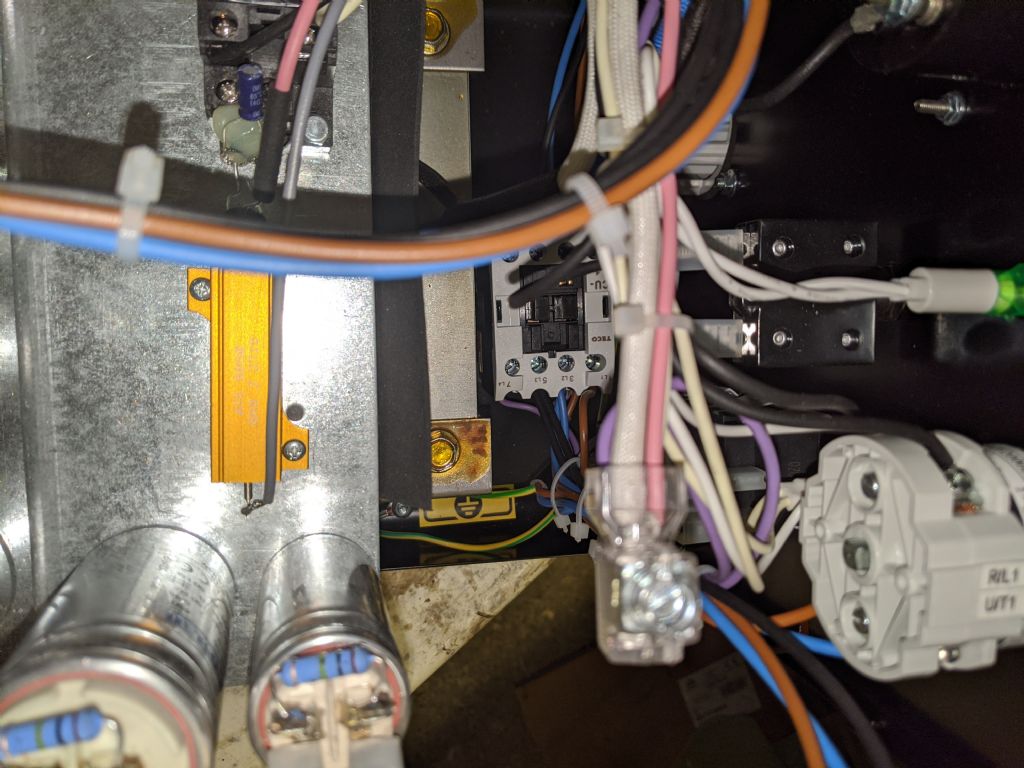

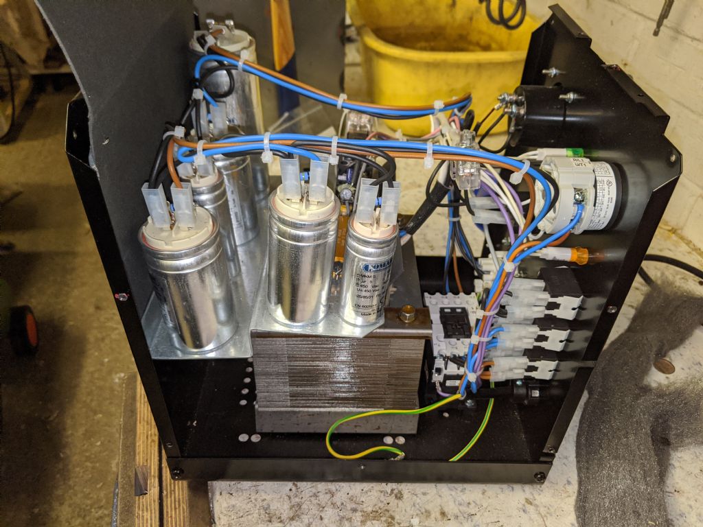

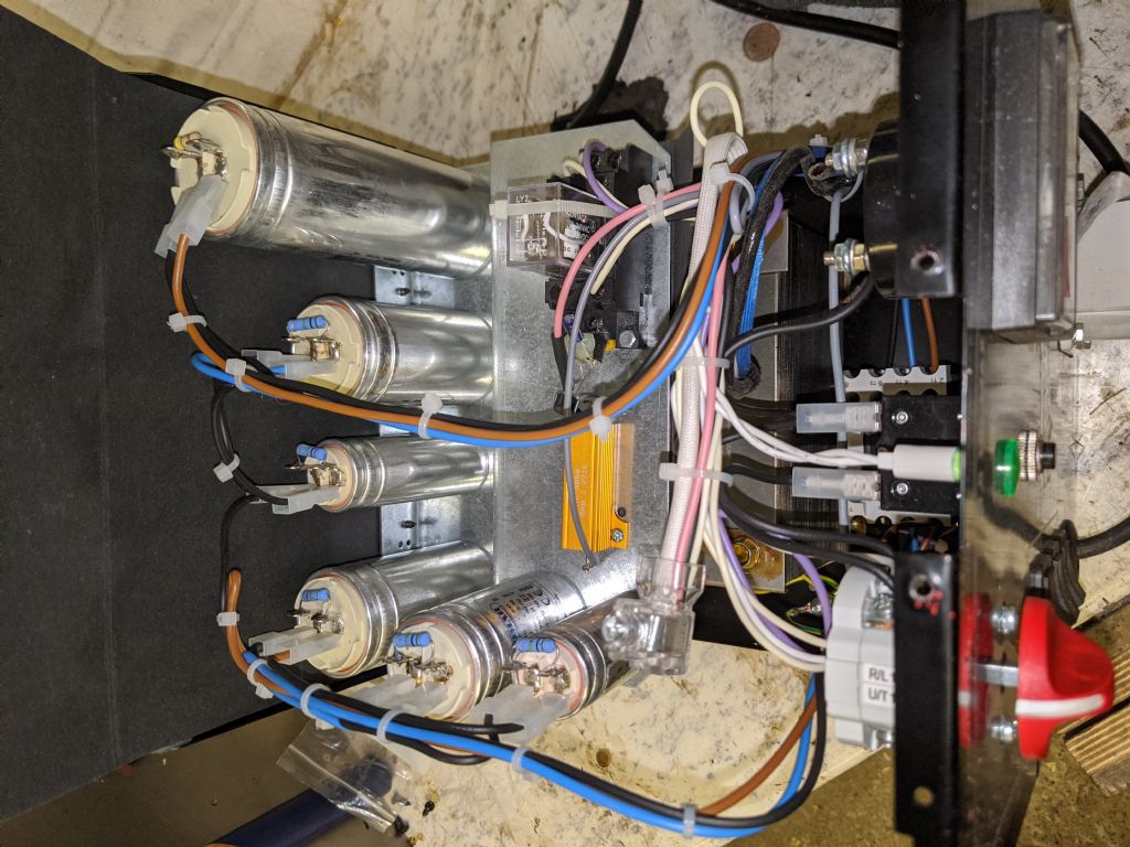

The rattle is the noise that the converter is making. As far as i know, it should be silent, so maybe thats why there's something up
Phil Whitley14/12/2019 12:36:43
avatar
1533 forum posts
147 photos
Yes Richard, that definitely sounds suspicious to me, might be an idea to whip the top off and check out the capacitors to see if any of them are bulging or leaking, you get that sort of rattle from loose transformer laminations too, and they settle down as the current falls when the motor runs up to speed.
Phil

Richard Kirkman 114/12/2019 17:32:37
334 forum posts
799 photos
Posted by Phil Whitley on 14/12/2019 14:12:56:
Hi Richard, the videos are working with sound today, or at least some of them are , I get a 404 error on the 118 speed one but no matter. What I see on the 272 speed video tells the story, the noise from the phase convertor seems to be a relay chattering as the light flickers in time with the rattle, and then when the relay finally pulls in the motor immediately runs up to speed, and goes quiet and smooth, look in the phase convertor for loose connections or dirty relay contacts and get back to me! Watch out for the capacitors!! they hold a charge but should have discharge resistors across them. short them with a well insulated screwdriver across the terminals to discharge them and make them safe.
Phil

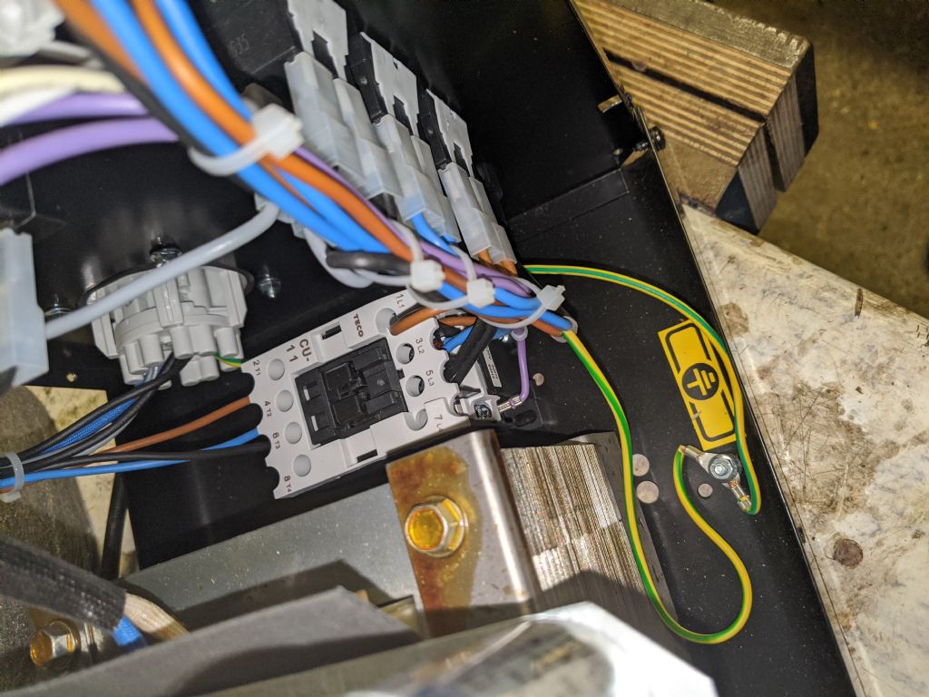

Taken the top off the converter, I can't see anything wrong particularly. I've had issues with capacitors before so I could probably notice. My multimeter doesn't measure farads since it's just a cheap one, so I can't test the capacitance of each with that method.
It's definitely an old converter though, it's last safety test was in 2017.
I have the receipt and I have a video of it making the clunking noise. So machine Mart should just take it back with no quarrels. But it depends what people would recommend me to do next
Thanks
