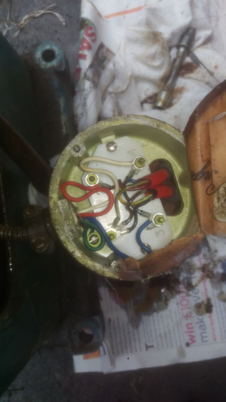

This is sud wiring, the red green blue and white are the input, on the left..
So where do i look up these rotary converters?
Thanks
James

OK, I'm not sure what the heck that wiring is inside the suds pump. Is there a wiring diagram stuck to the back of the lid that shows you how to rewire it to 220 Delta?
Transwave or Drives direct are two places that can provide you the inverters/converters.
Give drives direct a call and see what they recommend.
You could get a 5hp (ish) rotary phase converter that takes a single phase 240V input and generates 3 phase 415VAC. These are noisy (they have an idler motor that runs continuously inside the converter to generate the power) and expensive (somewhere between 500 and 1000 notes). These will power any number of 3 phase devices you have simultaneously and you wouldnt need to modify any of your motors or lathe wiring. Just leave them as 415VAC star. This is the closest equivalent of having a three phase supply installed from your electricity supplier.
You could also get digital inverters that generate 415VAC three phase which would mean that you dont need to alter your motors, but these are equally as expensive, a 3hp version costing well over 500 notes and still require direct connection to the lathe motor and bypassing the lathe controls.
I am in no way an expert in this area, best to call drives direct me thinks. They will know all of the options.

james huxstep16/01/2017 19:13:59
avatar
91 forum posts
24 photos
Ive found a transwave static converter 3hp, would that do tje job?
Graham Wharton16/01/2017 19:35:22
149 forum posts
48 photos
Yes, by the looks of it the transwave static converters would do what you need to do (as would the rotary converters). They even support operating multiple motors at the same time, providing you start the largest motor first, then start the smaller motor second.
Static converters also require you to "tune" the output depending on load. The transwave units have a multi position switch on the unit that you can switch in and out additional capacitance to balance out the 3 phases. I have no experience on how much of a pain it is to do.
Both static and rotary phase converters would allow you to just stick a standard three phase plug on the end of the lathe power lead and plug into the transwave box without modifying anything inside the lathe. Both types output 415VAC three phase from a 240VAC single phase input. Motors should be configured for 415VAC i.e no need to convert any to delta 240VAC.
The downside of a static converter is that your lathe will probably be a bit down on power. The static converters will only run your motor at somewhere between 60 and 80% power, whereas a rotary phase converter will generate full power in your motor.
Do some googling on static vs rotary phase converters for a million different opinions of which tyope is best and where.
