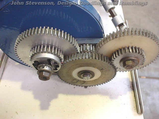

John Stevenson27/02/2016 20:32:36
avatar
5068 forum posts
3 photos
Diff fitted to a CES hobber.

To John Stevenson: I'm looking for this differential addon of the CES hobber. Can you give more information about the construction and the use of this addon or otherwise do you know whether the plans of collegeengineering will give this information?
