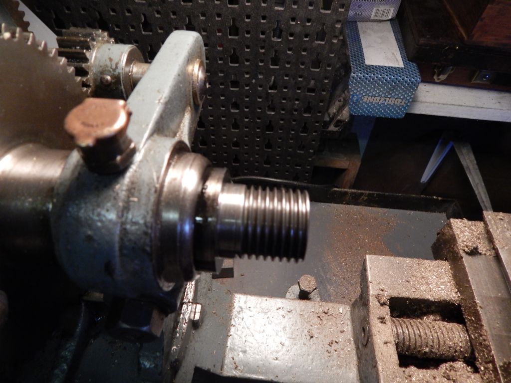

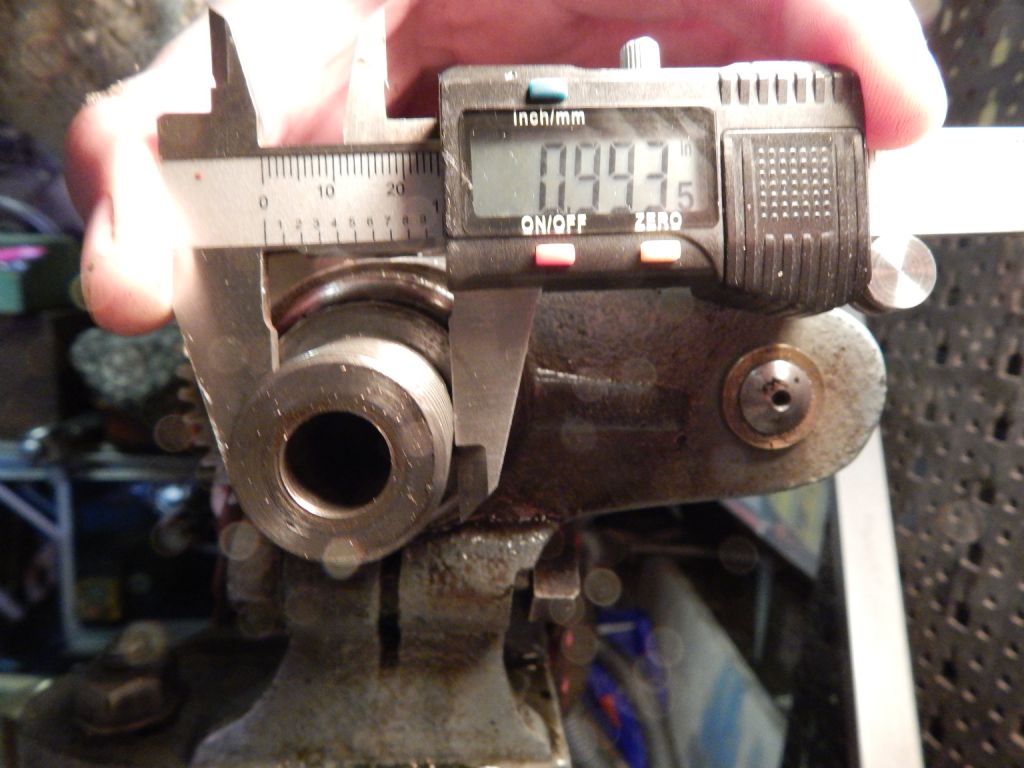

Hi Frank , this is the spindle with the chuck removed. How did you make the adaptor for the myford sounds quite complicated. This is measured on the shaft the chuck slips over the other is .988"
Here is the thread it attaches too

Hi Martin I think you have a non standard spindle ! early ones 02-03 had a 3/4 w, late 03 onward 7/8 w spindle nose thread.. A myford type adapter is simple enough just a flanged bush threaded inside to suit spindle nose, thread the outside to 1 1/8 w. while your at it 24x1.5mm is another handy size to have.. As for the tumbler gear not to hard to reverse engineer though you may need oem type L shape banjo. The non standard spindle may make things a little difficult !.......b

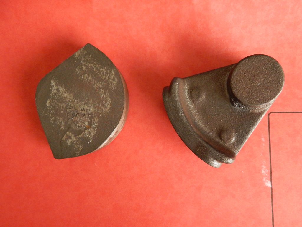

Hi Bodge , Yes have some castings now from a wonderful chap and have started cleaning them up . Have learned that the sleeve at the gear end is 2" and slightly longer than the 1.5" which is normal . I have not taken it off as yet to see why or if it can be shortened. Have seen some conversion adaptors on Ebay for chucks and nose spindels not sure if they would fit then. This was fitted when it came I could not tell you if its been adapted or if its original. either way I believe I can bush the tumbler am making out if this is not something i can shorten

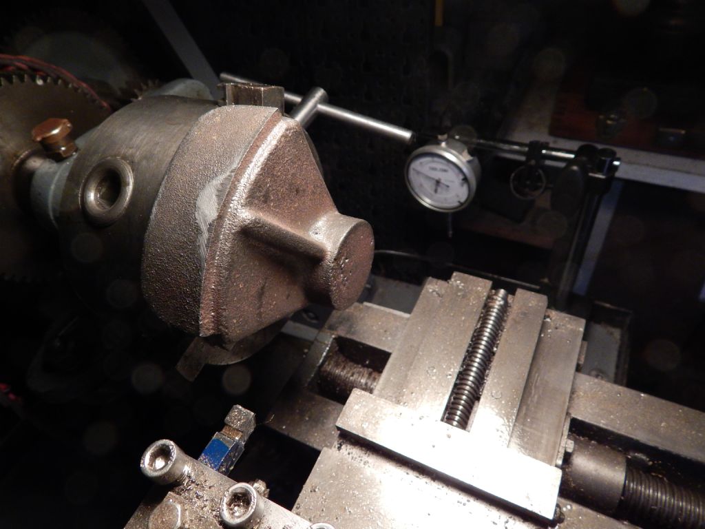

I have put this in my chuck to see how I can clean it up . But will have to use a friends lathe when i can as mine is no longer running with the inverter and Motor current issues.

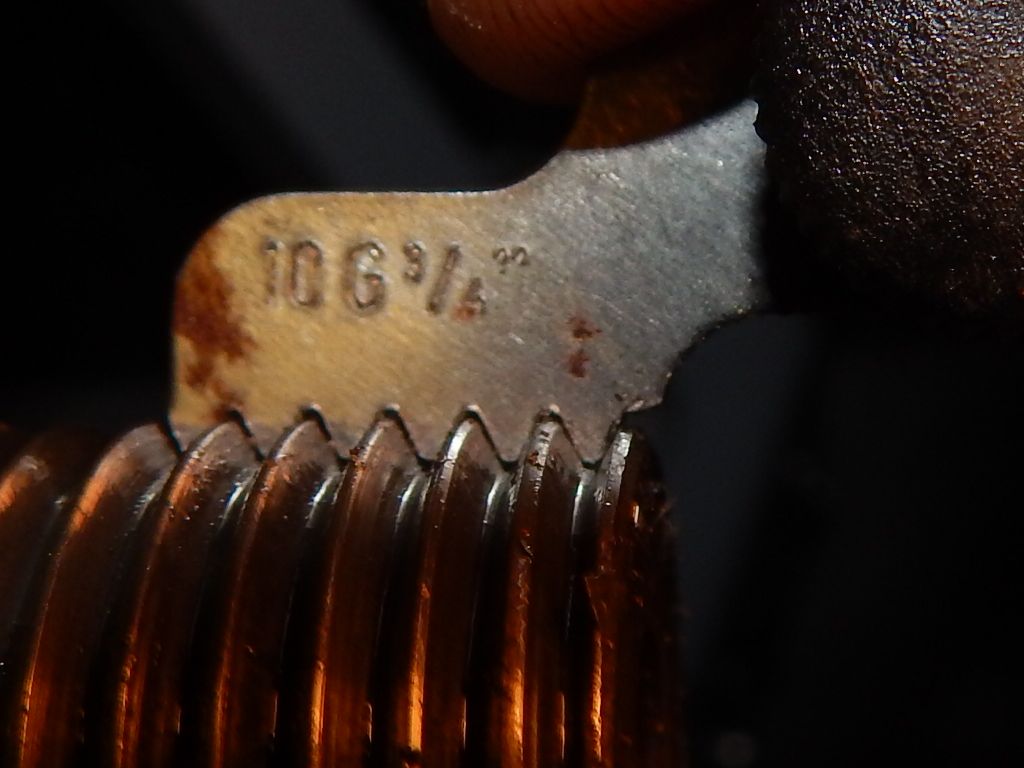

Hi there Bodge,
Here is thread on my lathe 3/4" w so probably 02-03

Hi Martin
Could you please measure major out side dia of the thread, because your caliper is showing an inch near enough on the register and im not seeing any step down to 3/4 in. the point being if you cut a ten tpi whit thread on 2 inch dia bar your gauge would still fit perfectly showing you had 10 tpi witworth 55* thread, i dont know for sure but i think the dia stamped on the gauge just refers to it being an industry standard in as much as you can buy a tap and die that size ie 3/4 in. As for year of manufacture i think you have a really early one, what might be called a pre production model ........b

Bodge . I think that is the shoulder you are referring to . The thread is.major 09845" or about 25.1mm. The gauge I used was a Draper No 553 BSW 4-62. It was made in West Germany if that helps I think the G is tome German na,e as its TPI as in 10

Martin. As i understand it that would make it a 1 inch by 10 tpi w spindle nose thread, To be 3/4 x 10 the the od of the thread would need to be a few thou less than 0.750 inch.........b

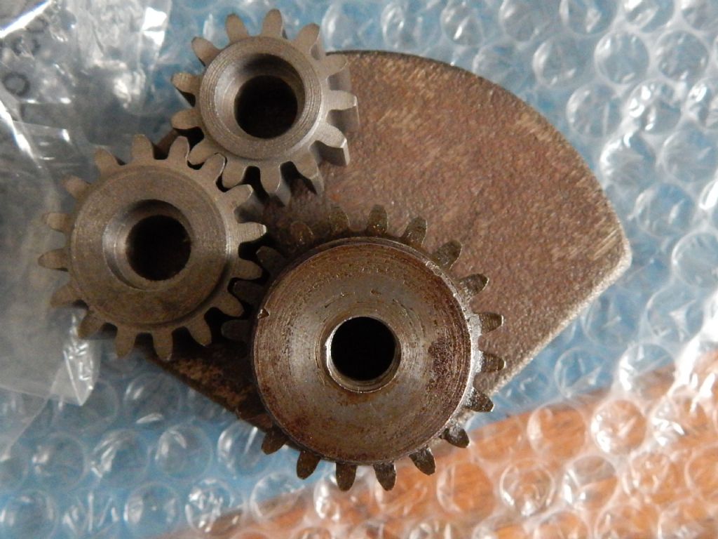

Am slowly obtaining these parts for this tumbler reverse gear . They are quite hard to find you are right about that , I just need one more 20T 14DP gear to finish the gear parts. Have been laying them out to see how they will interconnect , Geoff has been lovely and am so pleased to have the castings . Which I never thought I would obtain and have to make from steel block.
Gears
