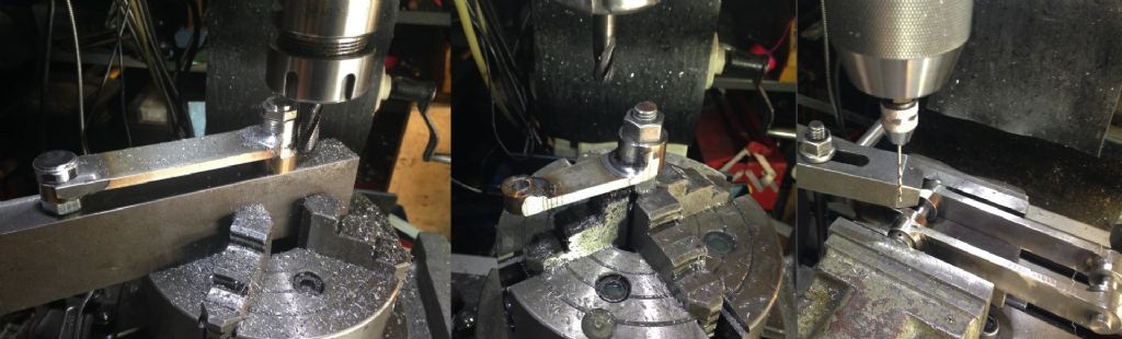

Paul Lousick20/02/2019 11:57:03
2276 forum posts
801 photos
The control rods and levers for the valve control gear were fabricated from 316 S/S. (not the same as those on the original engine but they will not rust when left unpainted). The fixtures on the end of the rods were made slightly oversize to allow for any misalignment and machined to size after welding. Rounded ends done on a rotary table.
Flat bar bent into a U-shape and a hole drilled in the end with a rota broach in the mill. A piece of round bar then welded to the end and turned to finish size. It was then reversed and the opposite side turned. Hole thru round bar drilled and reamed and bits not needed were removed
Lifting levers also fabricated from flat and round bar and finished on the mill. A bull nose cutter used to create a fillet on some corners. Pivot pins and thick securing washers with a hole for split pin made.
