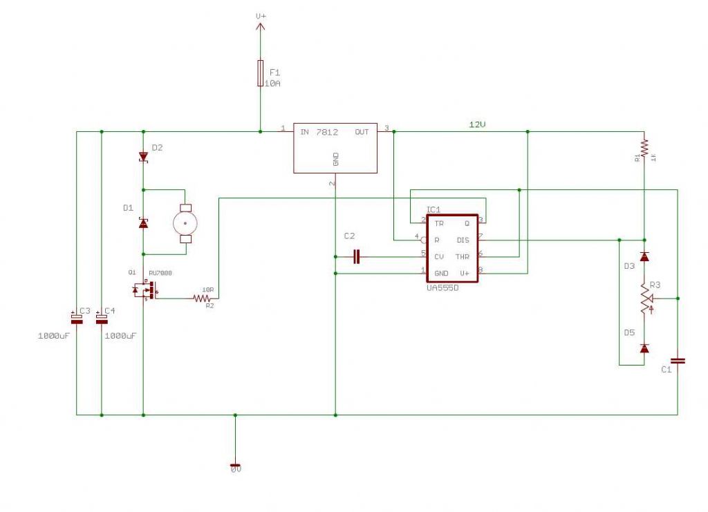

Tony Ray20/07/2015 14:29:58
238 forum posts
47 photos
Fleabay PWM controller cicuit diagram and components
Took me a while hopefully its correct sorry if I have broken every diagram convention inthe book ! Component details are in the second image.

I think there are a couple of errors, this is meant to be constructive and not dismissive of your abilities!
Firstly, I think the 2 1000mfd caps should be in parallel across the supply.....
Secondly the Anode of D2 ought to be connected before the V reg.
Good effort.....trying to reverse engineer a pcb isn't an easy task
TrevorG20/07/2015 15:29:05
avatar
34 forum posts
10 photos
As John said a very good first effort. These things are very tricky especially if it was a 3 layer board. Things to check (for completeness I have included the points already raised by John):
1) The 1000uF caps are prebably in parallel as mentioned.
2) Anode D2 should be connected to the junction of the 7812 and the fuse.
3) Anode D1(I assume thats its designation seems to have been off the edge of the scanner!) should be connected to the drain of the MOSFET not the source.If the MOSFET is blown up the Drain and Source may well have shorted in which case you will need to do a visual check or else remove the MOSFET from te board.
4) I suspect that the 555 pins Thresh(6) and Trigger(2) are linked together. I can then see how the circuit works.
If you can check these points we can move on to working out what went wrong.
Two additional questions:
1) Was the fuse blown
2) Is MOSFET blown ie is there a short between Source and Drain.
Trevor
Muzzer20/07/2015 18:04:36
avatar
2904 forum posts
448 photos
  • You've drawn the lower electrolytic shorted out. I'd expect to see one of them on the input and one on the output of the 7812.
  • The motor +ve is unlikely to be connected to the output of the regulator unless it's a very low power motor. More likely to be connected between the fuse and the 7812.
  • The anode of the bottom half of D2 is likely to be connected to the drain of the FET / bottom of the motor.
  • Haven't used a 555 for years but something is missing from the timing circuit, probably a resistor or a connection not shown.
  • I notice there is no overcurrent protection beyond the fuse. 10A fuse isn't going to protect it a great deal but will prevent a fire.
Getting there!
Murray
jason udall20/07/2015 18:22:11
2032 forum posts
41 photos
Like others.
Well done in that tracing.
What you have there is stage one..trace what seems to be going on.
Stage 2. Compare tracing against " textbook" ( or other reference..)circuits and double check circuit board against tracing where difference occur.
In particular ..even if "wrong" record what the board is doing. It might have been "wrong" from day one.
This leads to stage 3..can it be fixed/improved.
Again well done for a beginner. .we have all been there. Btw can you see the family resemblance to the speed control circuit in the mag?..

TrevorG20/07/2015 22:42:32
avatar
34 forum posts
10 photos
Tony,
I thought it might help to put the changes to your cct diagram into an updated diagram (always assuming I am correct !!)smiley:
Trevor

Tony Ray21/07/2015 17:23:17
238 forum posts
47 photos
Trevor, et al
Herewith checked CCT -Thank you, The only change is the 1000uf to the output of the voltage reg. You were right pin 2 & 6 of IC1 are commoned - there must be a track under it that I can't see. I now don't think its a 3 layer board. Theres also a 1N4001 or similar which I think is meant to be for polarity protection but I can't find any track from the anode leading anywhere. I now have a better idea of how its meant to work too. I'll measure the dud boards as suggested and look up my motoers parameters and post them later.
Tony Ray21/07/2015 19:01:35
238 forum posts
47 photos
Confession time,
No the 10A fuses have never blown
I checked the Schottky - OK
And there was no short on Q1 D to S
So I checked the output of the 7812 OK at 12.1 V and concluded that with all the other diodes ok unless the 555 was dead there couldn't be much wrong so I bypassed the C/O switch and ... It worksblush The C/O switch is dead.
I definitely blew one up as I shorted the output, but perhaps the second one is ok and the switch fault was intermittent.
The motor is a Parvalux PG4568 rated at 1A continuous 14W, 21W 15 min , 17.5W 1hr. It barely gets warm when powerfeeding
In terms of the basic design I take the point about no over current but I'm using a laptop PSU which itself has in built protection.
Now some questions
If I wanted to fix the dead one what device would you recommend to replace q1 ?
If I did want to change direction whilst power-feeding is it vital to ramp down the PWM before switching through zero?
Is there anything else that one could add easily to further improve it ? To me it does not look that different to the Inchanga design apart from the bipolar drivers.

TrevorG21/07/2015 20:17:01
avatar
34 forum posts
10 photos
Ok you now have one working, even if the problem is not on the board. Now for the second one. Firstly do the checks I suggested for the first board as there are various possiblities for the faulty component (and more than one could have blown). You also have the ability to check readings agianst those on the first board.
My general thoughts on the circuit design are that it is a considerable improvement on the circuit published in MEW. In particular the inclusion of the schottky diode D1 and the elimination of the bipolar drivers. Also the increase in the 555 supply voltage will reduce the RDSON of the MOSFET allowing it to run cooler.
The only serious flaw I can see is that if a heavy duty motor is started the supply voltage could drop very low. At this point the output voltage of the voltage regulator will be higher than the input causing current to flow the wrong way through the regulator. I managed to blow up a regulator this way many years ago. As a result I now put a diode between the positive supply and the regulator input which protects against this problem. It is possible that the 1N400x type diode was being used to provide this protection. However, I suggest powering up with no motor connected and checking the o/p of the voltage regulator is still about 12V. You should also check the voltage on pin3 of the 555 (connected to R2) it should vary as you turn the pot. Check the working board for comparison if you are in doubt.
The RU7088 appears to be a substantial device but if you need to replace it you may have difficulty finding a supplier. There are a lot of alternatives available. You need a N-Channel TO-220 MOSFET with a Vdss of >=40V and RDSON of 6mR or less. The current rating of such a device would almost certainly be adequate but check that it is a minimum of 30A. It will probably be much higher.
Trevor
